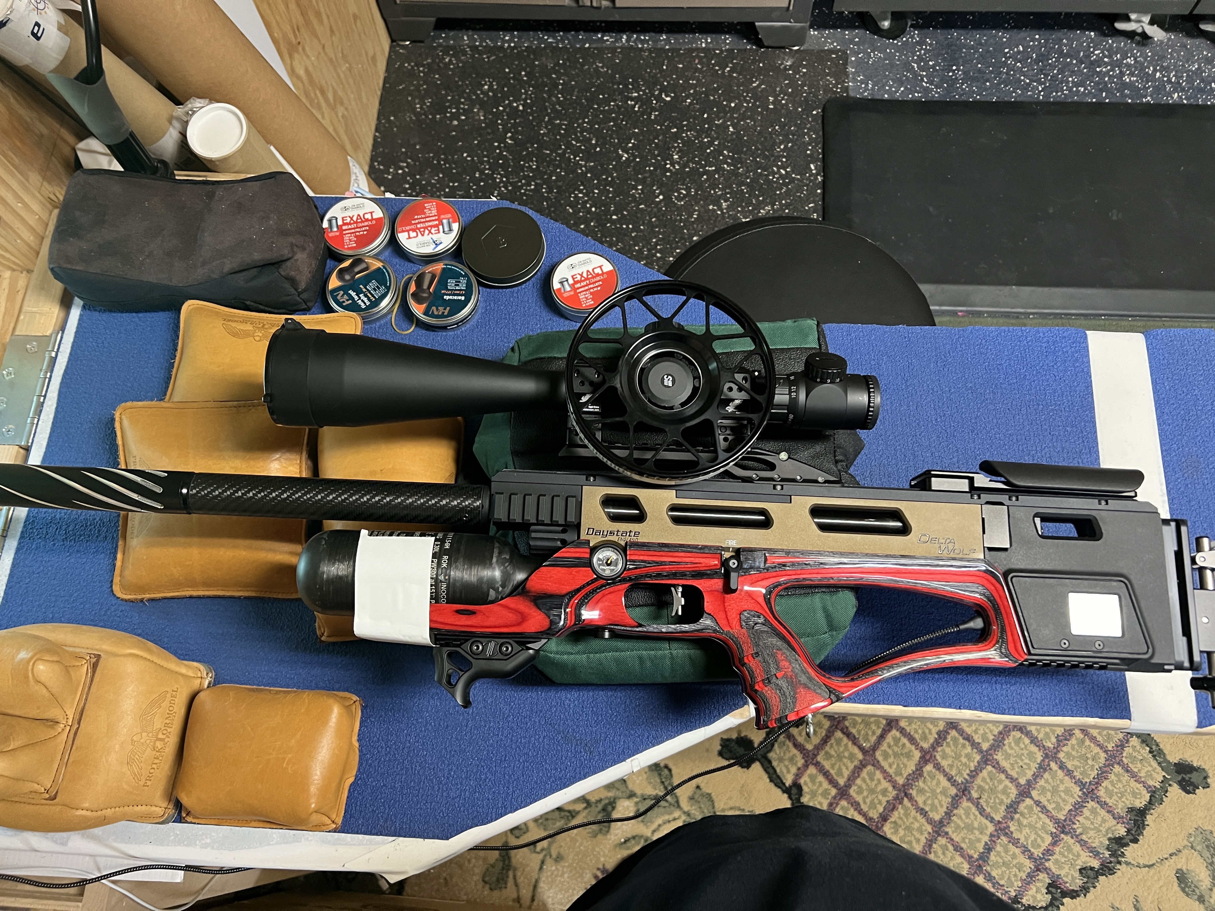

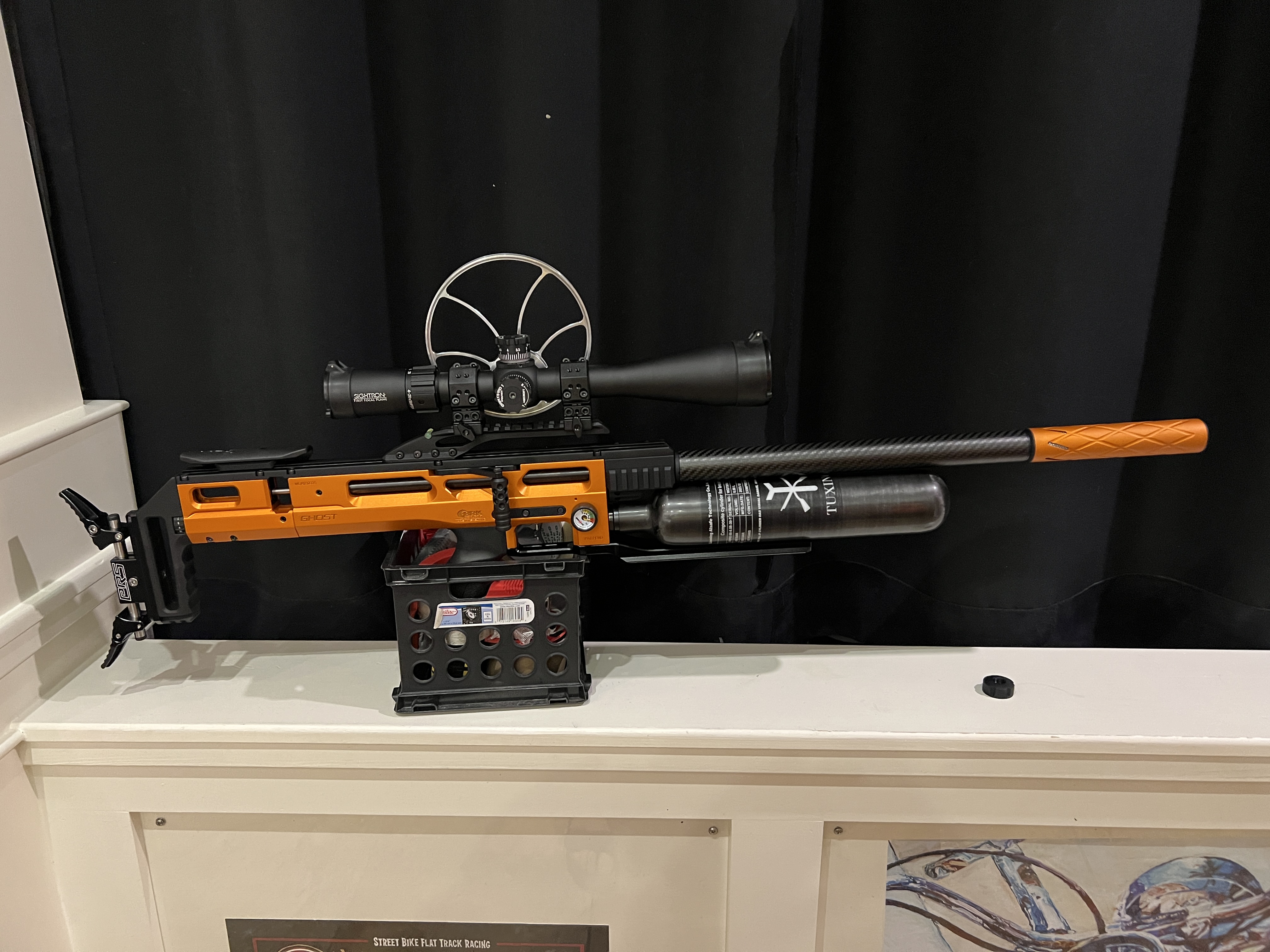

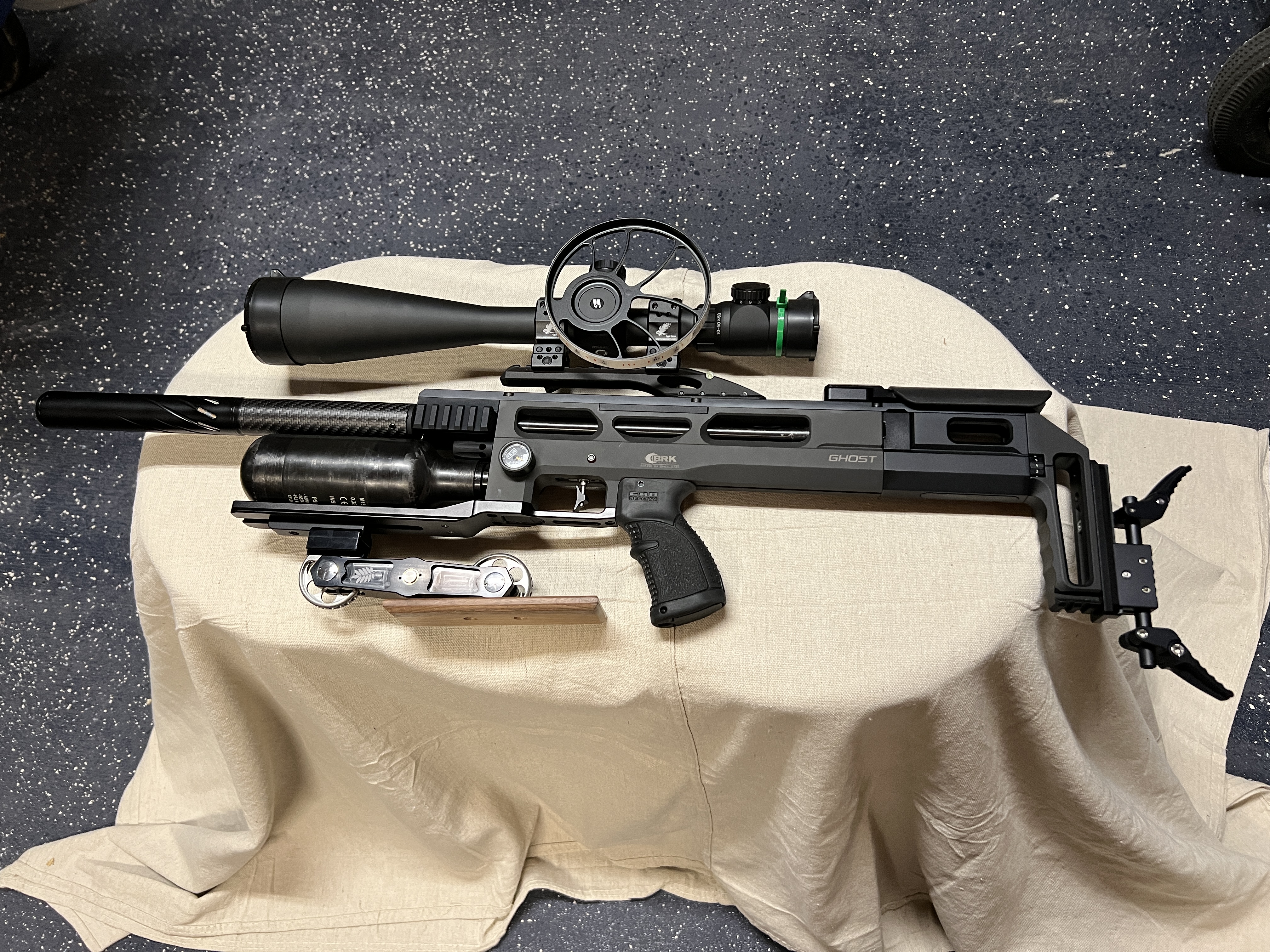

View attachment 473399View attachment 473401View attachment 473404
I always appreciate your replies and pictures of all your fun stuff. You definitely have tried lots of options!!
