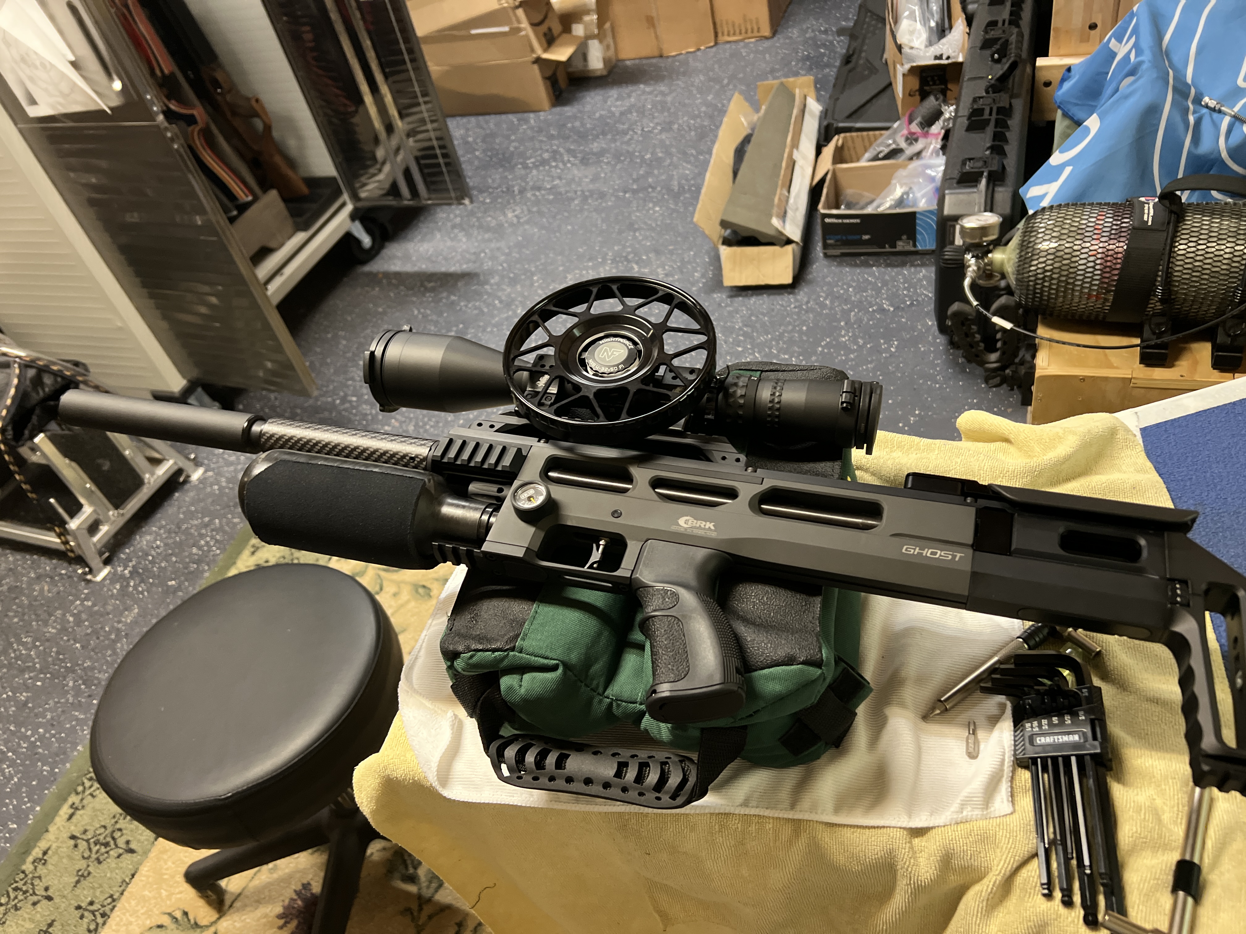

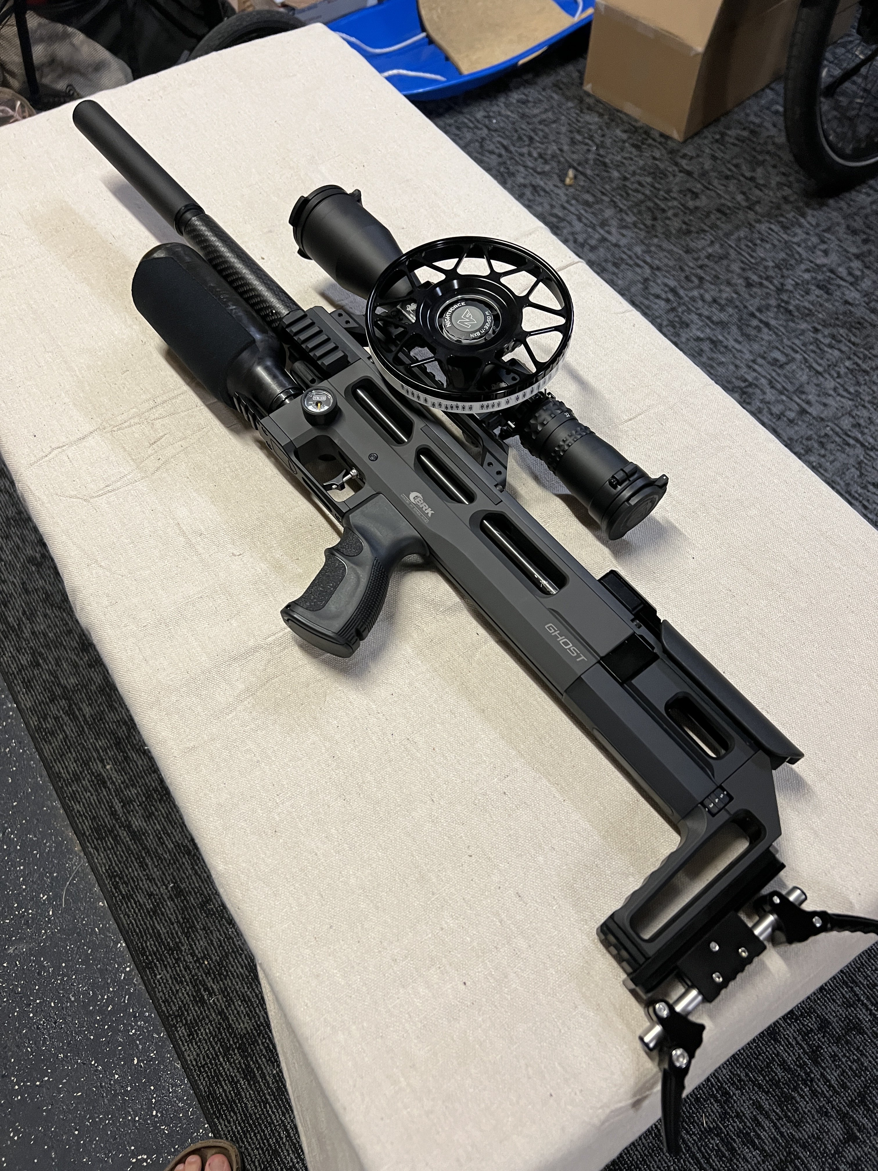

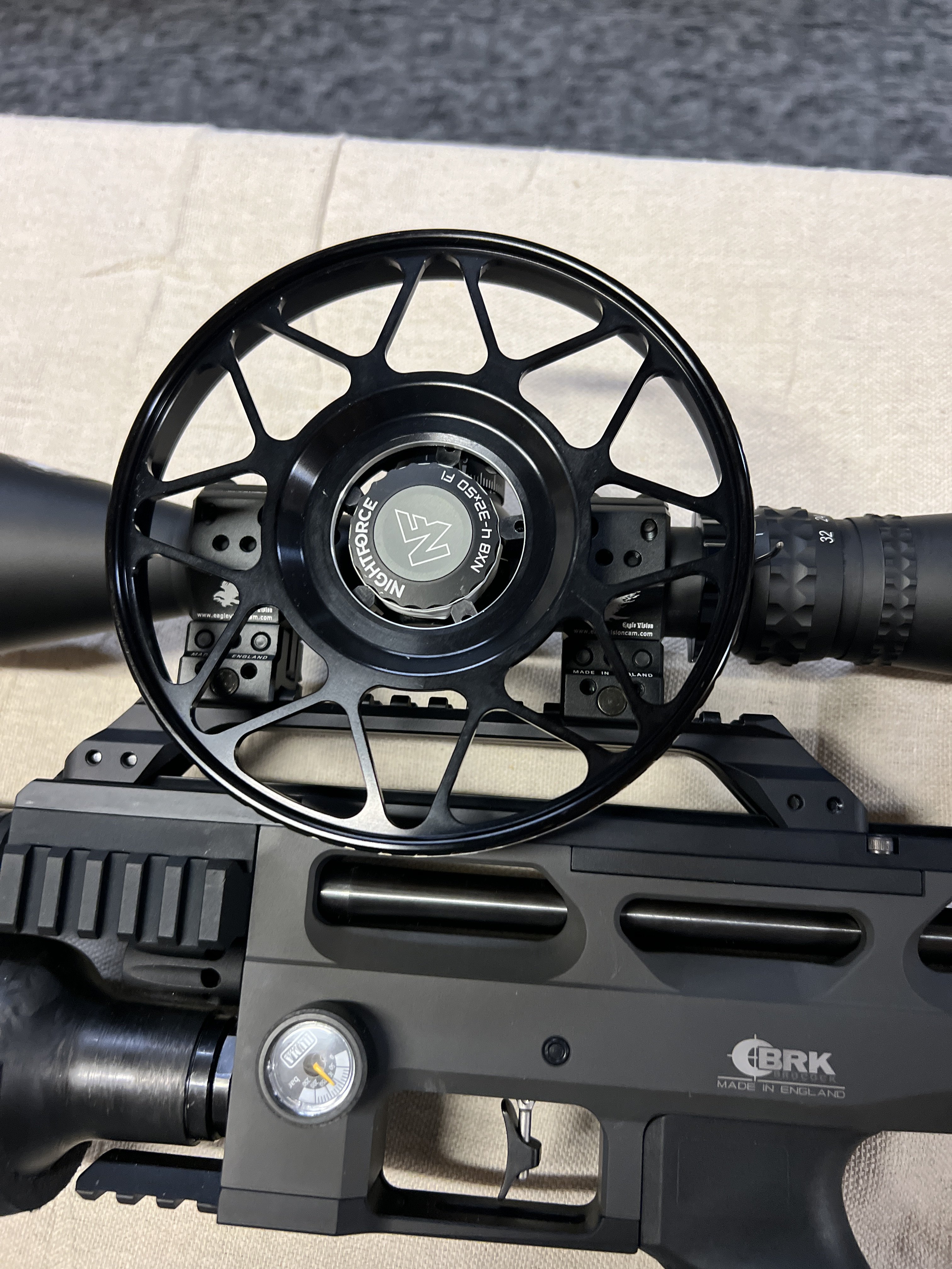

Busy day with airguns. Spent 3 hours with a Skout epoch then got to play with my new Brocock Ghost Carbine.177. Mounted a Nightforce NX8 on it with a big Rowan parallax wheel setup with StrelokPro and verified dope yard by yard. Very impressed with Derrick Walls trigger work! @ tenacious airguns dot com. Bullpup platforms can be difficult for FT because too often the center of barrel to center of scope is excessive and difficult to get a good eyebox. Nonetheless- success!
11 lbs of awesomeness.
