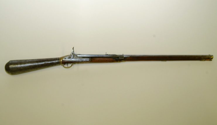

The air rifle that started it all, carried by Lewis and Clark during thier adventures. Came in .46 and .51 cal, 4 ft long and capable of shooting at 1000 FPS and putting a ball through 1 inch pine at 100 yards. Loaded with 20 balls and hand pumped could shoot 80 times on one bladder which was also the butt stock. 1500 pumps were required to fill each bladder.

I could swear the originals filled to around 800 psi and made around 100 FPE.
950 fps with a .46 round ball is around 280 FPE. How many of the 20 could do this speed? If it was a significant amount of them...
Well what did they know that modern big bore makers don't is all I'm saying. To me, 20 shots at anywhere near 100 FPE is hard enough to believe.

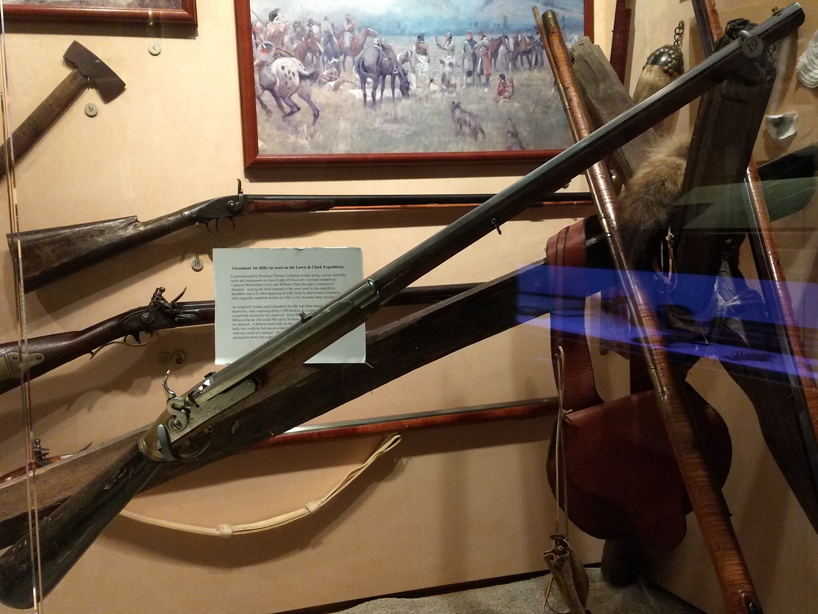

Just saw one in person at the National Firearms Museum. The gun is a monster. Not something I'm gonna be able to hold up for long. I thought it was Beeman's, but it's on loan from a Mike Carrick.

Later Girandoni type guns were built differently.
The early "real" Girandoni uses a long flat spring.
Later Girandoni type guns generally use a heavy V-type spring.
I've shot my original .44 cal Girandoni type gun and it can do right around 630FPS (plus or minus a few FPS at the start each time) but that is a slightly smaller round ball, but it's also a shorter barrel, lighter cut rifling, and it uses a heavy V-Spring
The L&C gun, it'll hit the mid 500's. I think with a little experimentation with round balls, it too will get into or close to the 600fps range.
The nice thing with the RC&RK gun, it is an exact copy... so we can read what they got with their gun in velocities.
