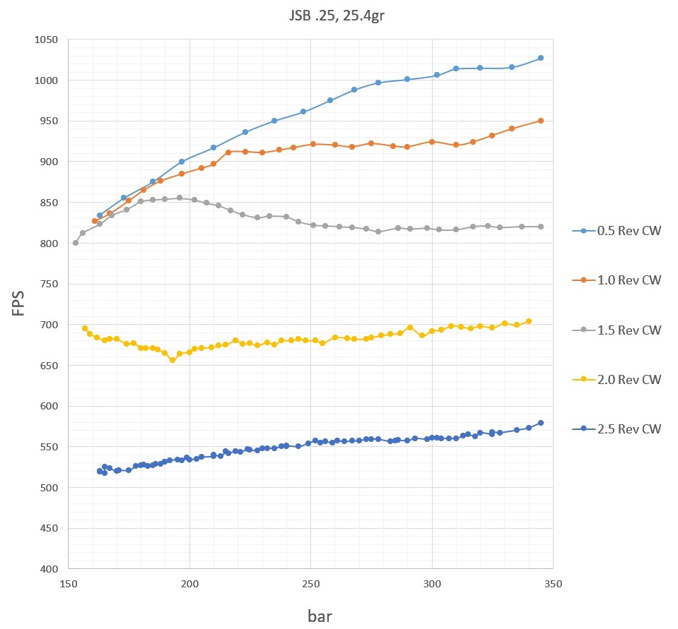

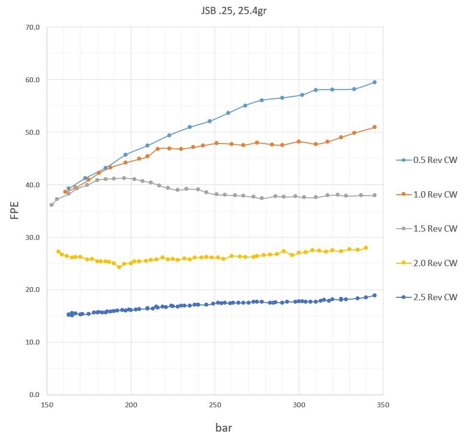

..More charts and data, for JSB .25, 25.4gr, same procedure.
It looks like the flattest setting would be around 750-770 FPS.
0.5 Rev CW
no. Bar FPS FPE
1 345 1027 59.5
2 333 1016 58.2
3 320 1015 58.1
4 310 1014 58.0
5 302 1006 57.1
6 290 1001 56.5
7 278 997 56.1
8 268 988 55.0
9 258 975 53.6
10 247 961 52.1
11 235 950 50.9
12 223 936 49.4
13 210 917 47.4
14 197 900 45.7
15 185 875 43.2
16 173 855 41.2
17 163 834 39.2

Thanks!
Thank you for putting this together and posting it. Very scientific and useful

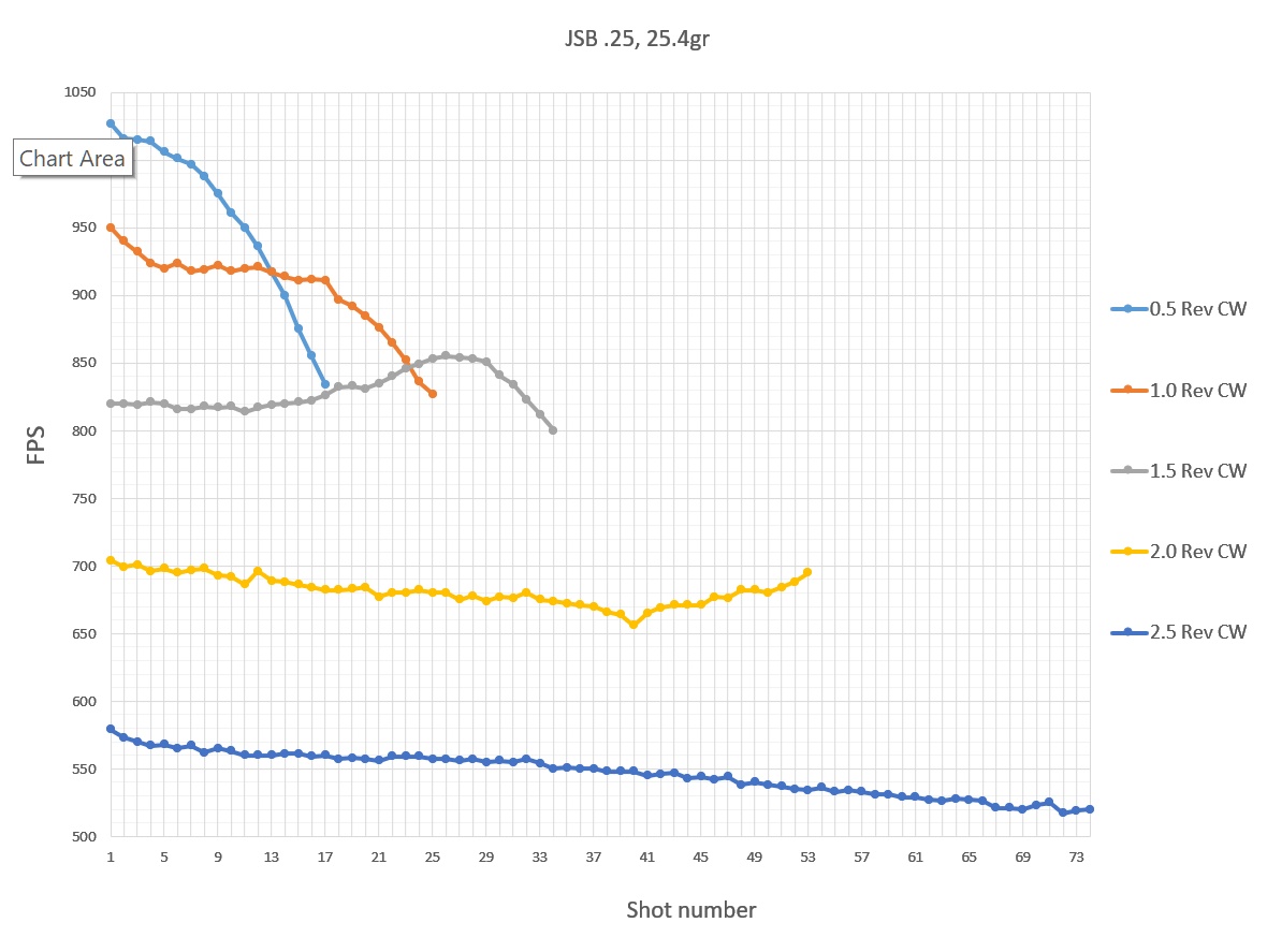

There is a minor flaw in this data, that has only very recently come to light: the power screw can sometimes unscrew itself, all by itself, which looks like a sudden onset of a gradual increase in power for every subsequent shot.
- the yellow line for 25gr starts going upwards after shot no. 40 - it should be going down with the same slope all the way.
- the green line for 16gr does this as well from the outset; it should be going down like the rest of the curves.
Reactions: Airgun-hobbyist
Interesting !! That's great to know and makes total sense.
I kind of like the auto adjusting power screw
