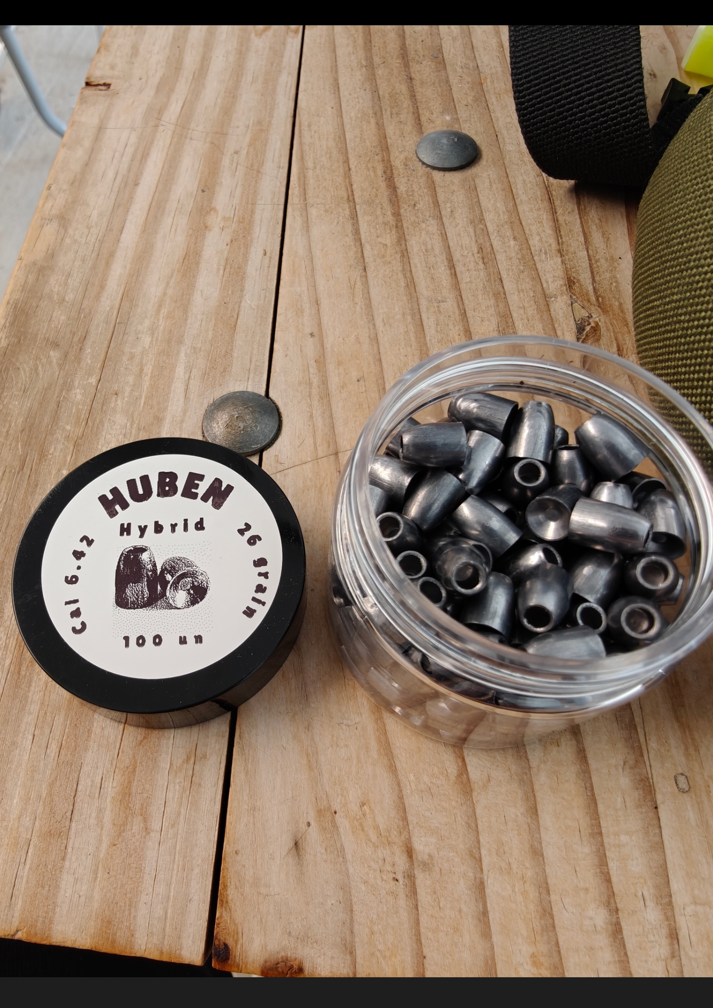

First it is a pistol, not a rifle. Pistols are typically used at short distances. The GK1 is NOT a plinker. It is powerful enough to damage unintended infrastructure. I own a V1 and a V3 in .25 and have hit pigeons at 100 meters. It is also a revolver and its munition retention in the magazine is a chamfer machined into the magazine's bores that catch the skirts of pellets. Slugs do not have a skirt and the only way they can be retained is friction. In other words, the gun is not designed to use slugs, nor do slugs at the intended short distances, add any value., only more cost If your intended use is for high power and exceptional accuracy is your requirement, then the .25 is superior to the .22 . The GK1 is also loud. It needs a good moderator. The higher the power selected, the louder it is. Only you know your intended purpose. Your call.
Despite claims that slugs are no good for the gk1, it is the only thing I shoot in mine. The only pellet that did any good was the GTO, but they are so light they don't even swing my steel targets when they hit. I shoot Varmint Knockers 28gr .223 slugs, and when scoped have gotten 1" groups at 50 yards. The slugs do get a dent from the pseudo rifling in the cylinder and stay snug. The thing I have learned from going over several K1s and GK1s with Kelly is....the magazines are not consistent from batch to batch, and different batches seem to like different ammo sizes. My 2018 magazine in my K1 only like .2193 slugs, and the v1 gk1 only likes .223...

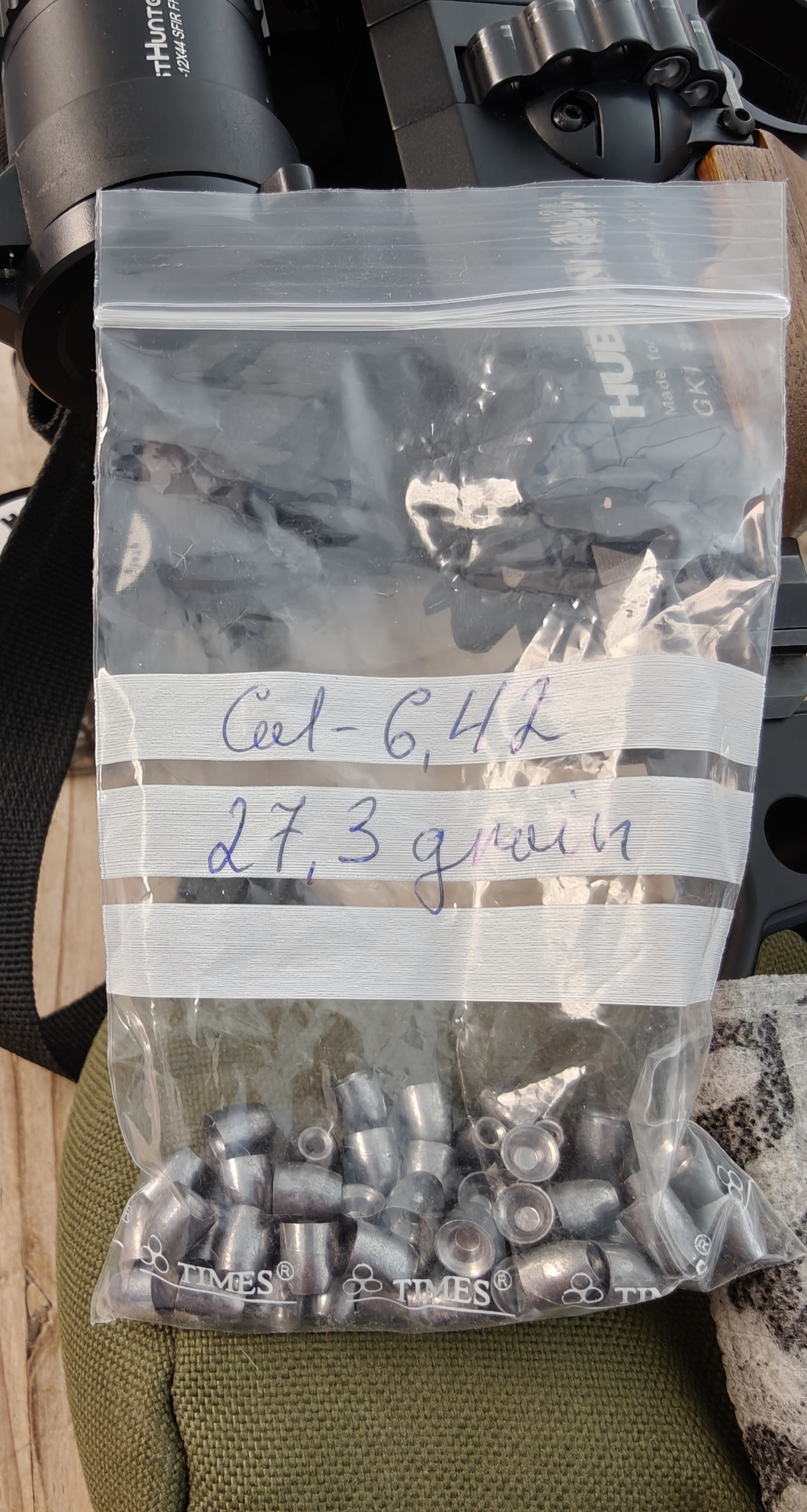

Tengo munición del calibre .22 y del .25. Ambas son muy precisas, pero la del .25 es extremadamente precisa con balas de 6,42 mm y perdigones JTS de 25,39 granos.
Atentamente.
My vote is for .25. I don't bother with slugs and just shoot JSB 34gr pellets. Pushing them right around 40fpe. I can get a full mag from a 250 bar fill and the shots are accurate and hit with some serious authority for a pistol this size.
In general I believe the Huben K1/GK1 is a better .25 platform than .22. They wen't weird on the measurements and none of the .22 pellets really do amazing. In .25 pellets and slugs just do much better.
