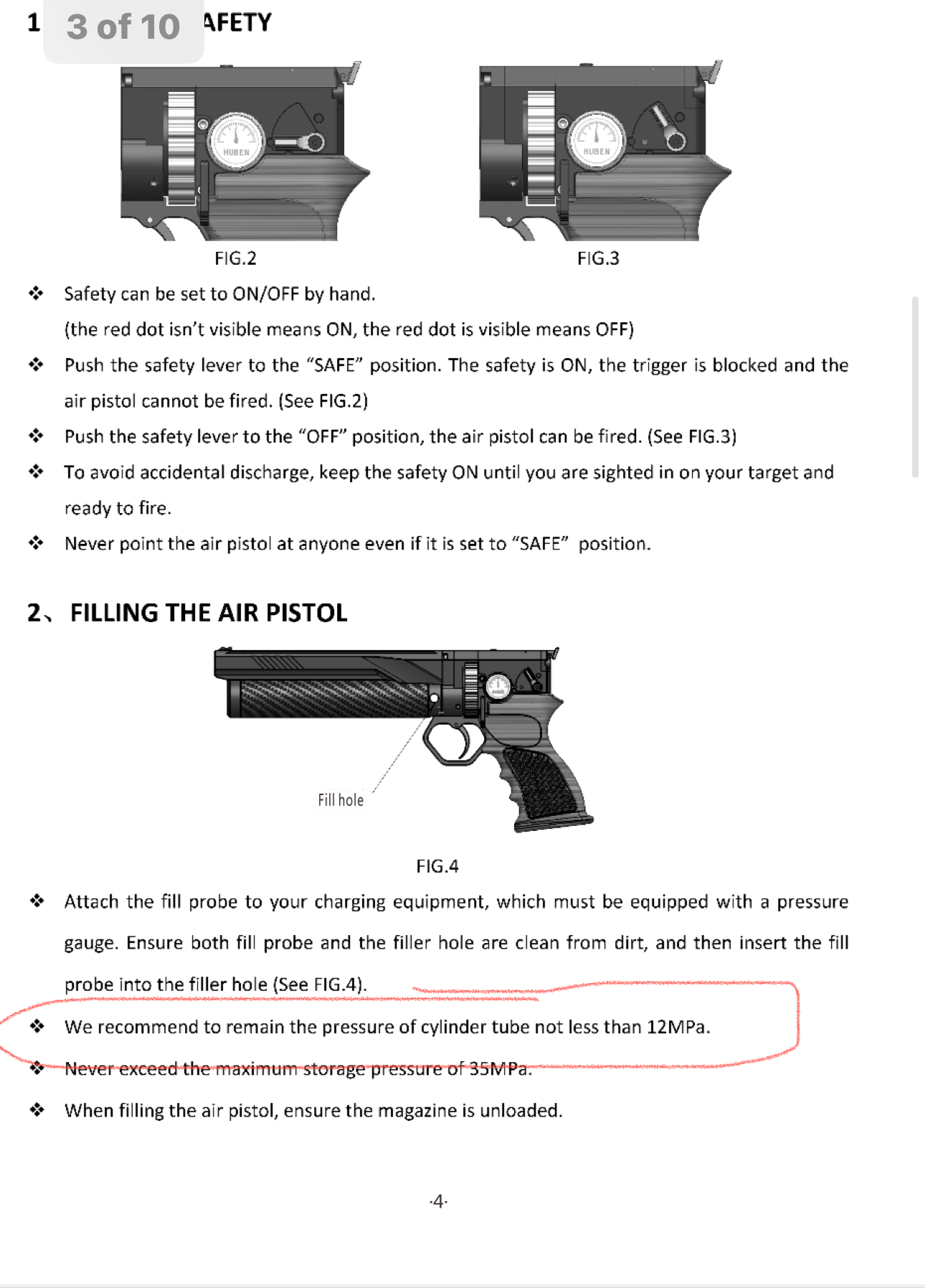

@rcrawford58 No, I haven't encountered this issue. You had 7 mpa left in the reservoir? What was the reservoir pressure level when you started your shot string? It sounds to me like you shot your GK1 down wayyyy too low. I don't tend to shoot past 12mpa before refilling. The operating pressure range is covered in the owner's manual. I suggest that you read over it.
If you read the instructions before you use it, it warns you to not operate the gun below I60 bar.or there abouts. It won't fill because the valve is now jammed open. You caused this issue, not the gun. To remedy this, you need to disassemble the valve assembly and reassemble the gun.

I'm confused. MPH is miles per hour. I suspect you mean MPA which is an abbreviation of millipascals, escentially atmospheres or BAR. The gauge on your gun is marked 0 to 40 mpa. Your owners manual , that you obviously did not read, clearly states not to shoot the gun below 16 mpa. After your 12 shots the gauge was reading 7 mpa? If so, at least one of your shots occurred with pressure below 16 mpa. You also stated your 12 shots were at maximum power. So how did the gun get adjusted to maximum power, because it was not delivered to you adjusted that way? That indicates to me that you shot the gun many more than 12 times just adjusting the power screw.

@rcrawford58 Page 4
