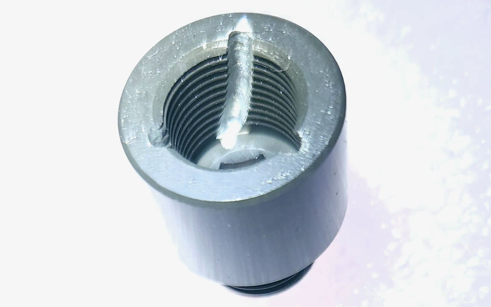

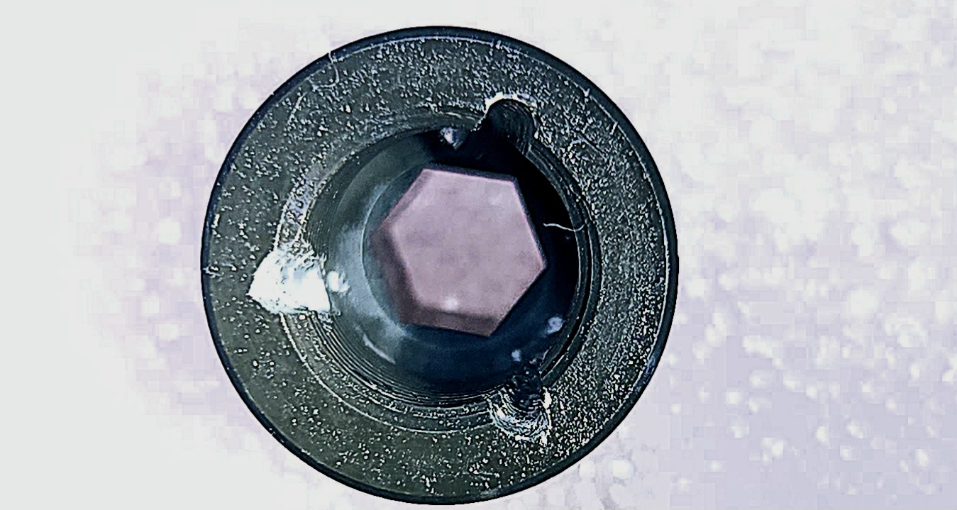

Procedure: This is relatively simple and not by any means conducted in a professional manner. It’s an experimental hack. The first step was to mod the NEAG moderator collar that I have as a spare after buying the nicer adapter from Zach at Ares. A basic stripping function was provided by drilling four holes (eventually 9/64in each) at an angle into the adapter so that they are exposed in front of the barrel to allow air to pass into channels indented in the exterior of the adapter. Basically a bunch of careful drilling and dremeling. I then cut 5 pieces of CF from a template and sanded them to press fit into the five (let’s call them apertures) in the base of the shroud. This took a couple hours of careful crafting. Thankfully, all 5 apertures are the same size but this step could be made much easier by having 3D printed plugs/inserts made that could be fitted from the inside. Anyway, I press fitted my pieces and then glassed them in from the inside. I then drilled 2 holes in the rear most sections at 7/64 to provide venting. I really should have taken more pics but I tend to get on a tear with these activities. Here is a pic of the shroud and adapter collar showing the mods:

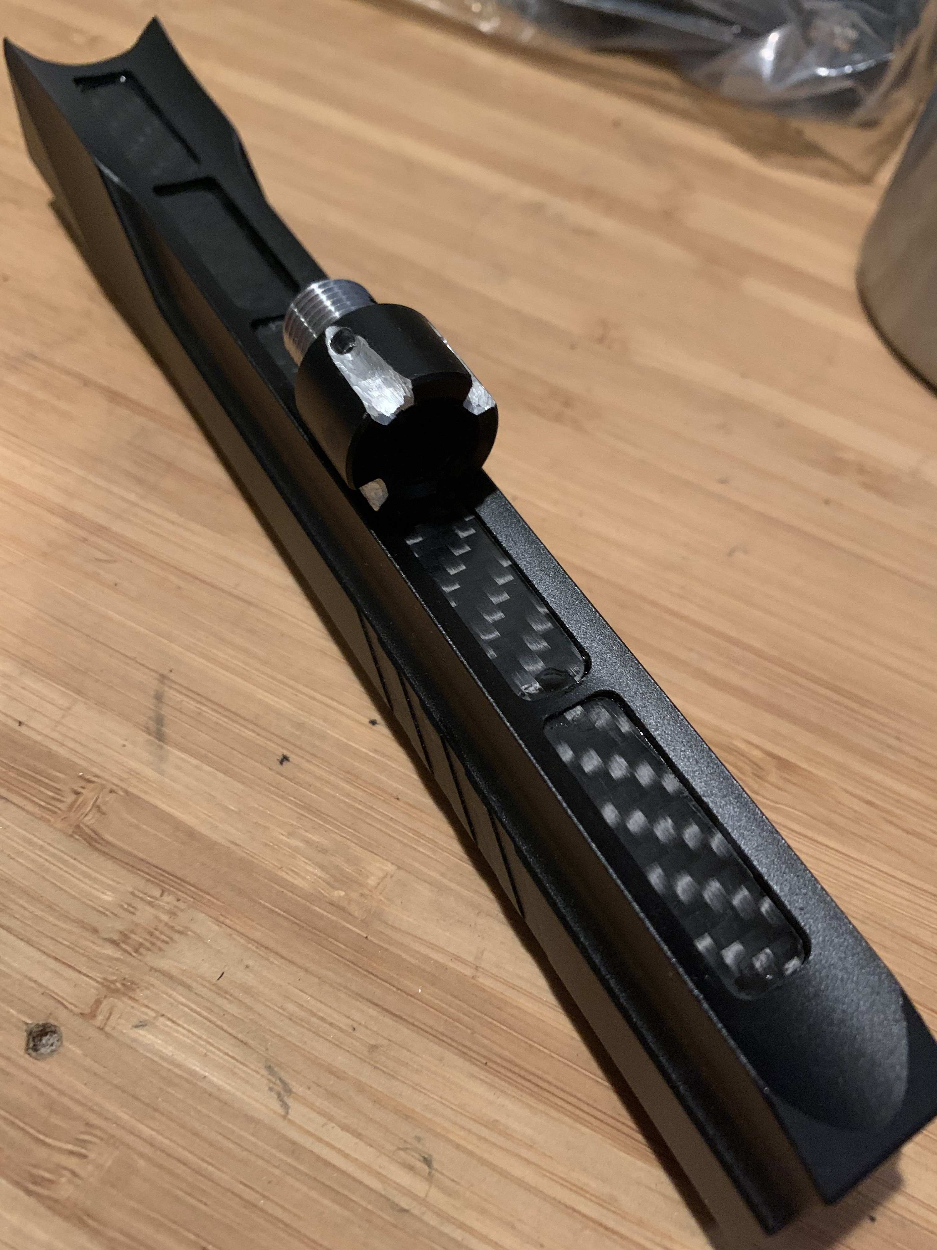

With the interior glassing, the shroud was deemed to be air tight and very solid so then it was just a matter of putting things back together. While the mod adapter collar is irreversibly modified, the shroud could be reverted by knocking out the pieces from the outside. The only other addition was a piece/plug of magic eraser foam (about 1 in long) fitted inside the shroud and around the barrel at the magazine end to disrupt a pressure wave.
Testing: Initial test involved dry firing with a sound meter 3ft away and at 45deg forward of the muzzle with no moderator. Having the unmodified Ares adapter, I could perform a comparison because the Ares adapter has no way to pass air into the shroud. An average of 10 shots with each adapter provided a difference of 4.7dB in favor of the active shroud. To put it into context, if you own a GK1, you’ll know that it is louder dry firing than it is with a projectile. I would say that the difference made by having the shroud active is about the same as dry vs. live firing.

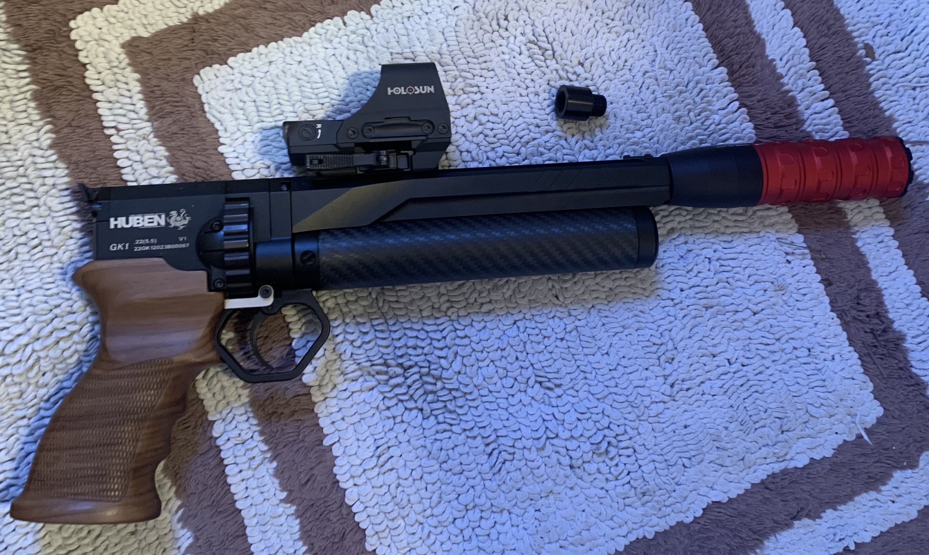

This AM, I had a chance to do some real testing and configured the GK1 with my widescreen (grotesquely large) Holosun dot and IA1350. Shooting GTOs at 905fps/21fpe. Note that the GTOs (for reasons I don’t understand) are louder than lead pellets even at a lower power output. Anyway, here’s the rig and the “control”, Ares adapter:
The same testing approach was used with the active mod collar (leveraging the shroud) and the control Ares collar. 10 shots with each taken from the same starting pressure (290bar) gave a 3.7dB average difference, again favoring the shroud. With the shroud in play, to the ear, there is a notable difference and I can say that the GK1 is now midway between its unshrouded state and my K1 rifle in terms of noise. There is no resonance from the shroud and the glassed CF inserts show no signs of movement or other deterioration.

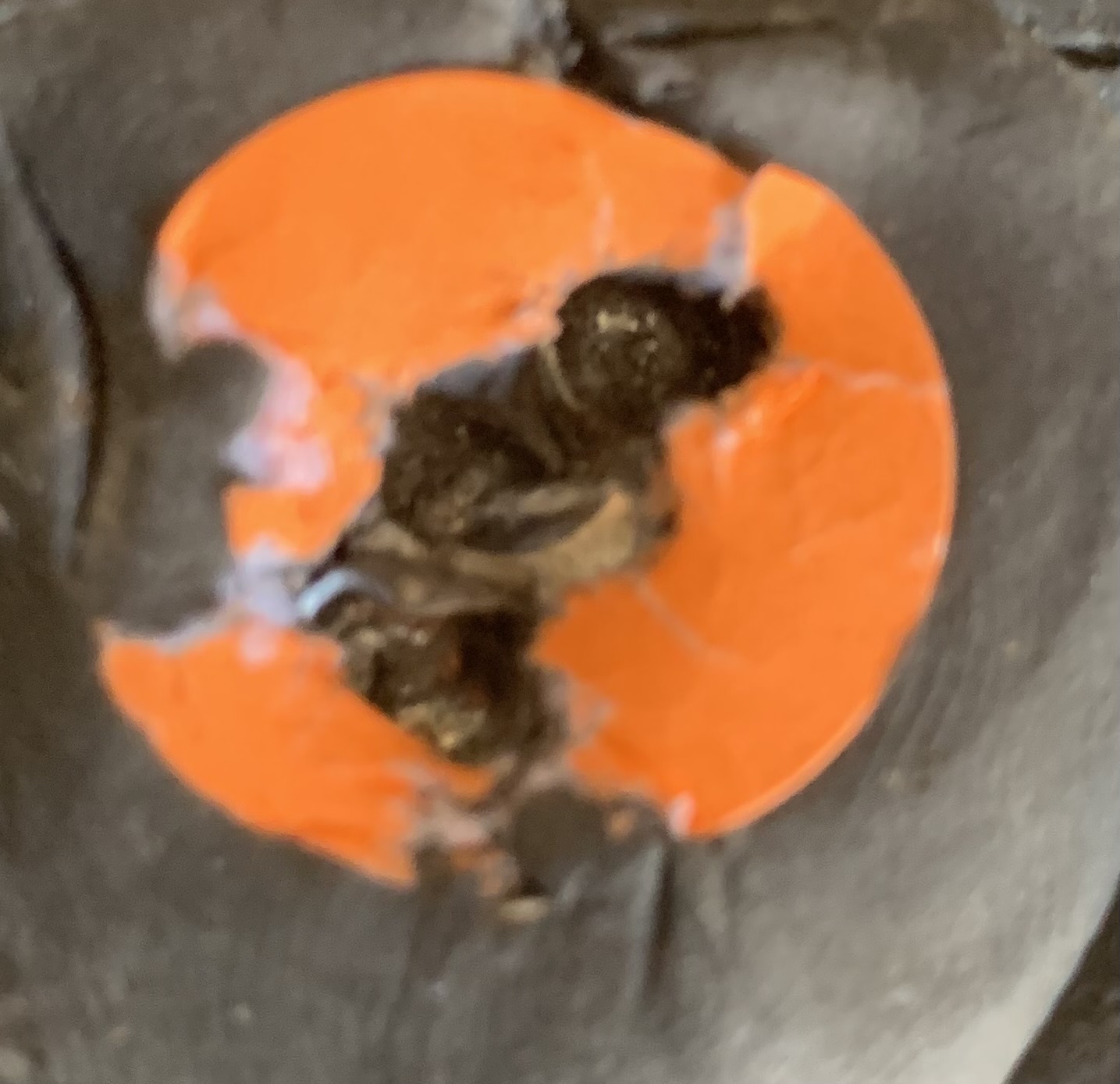

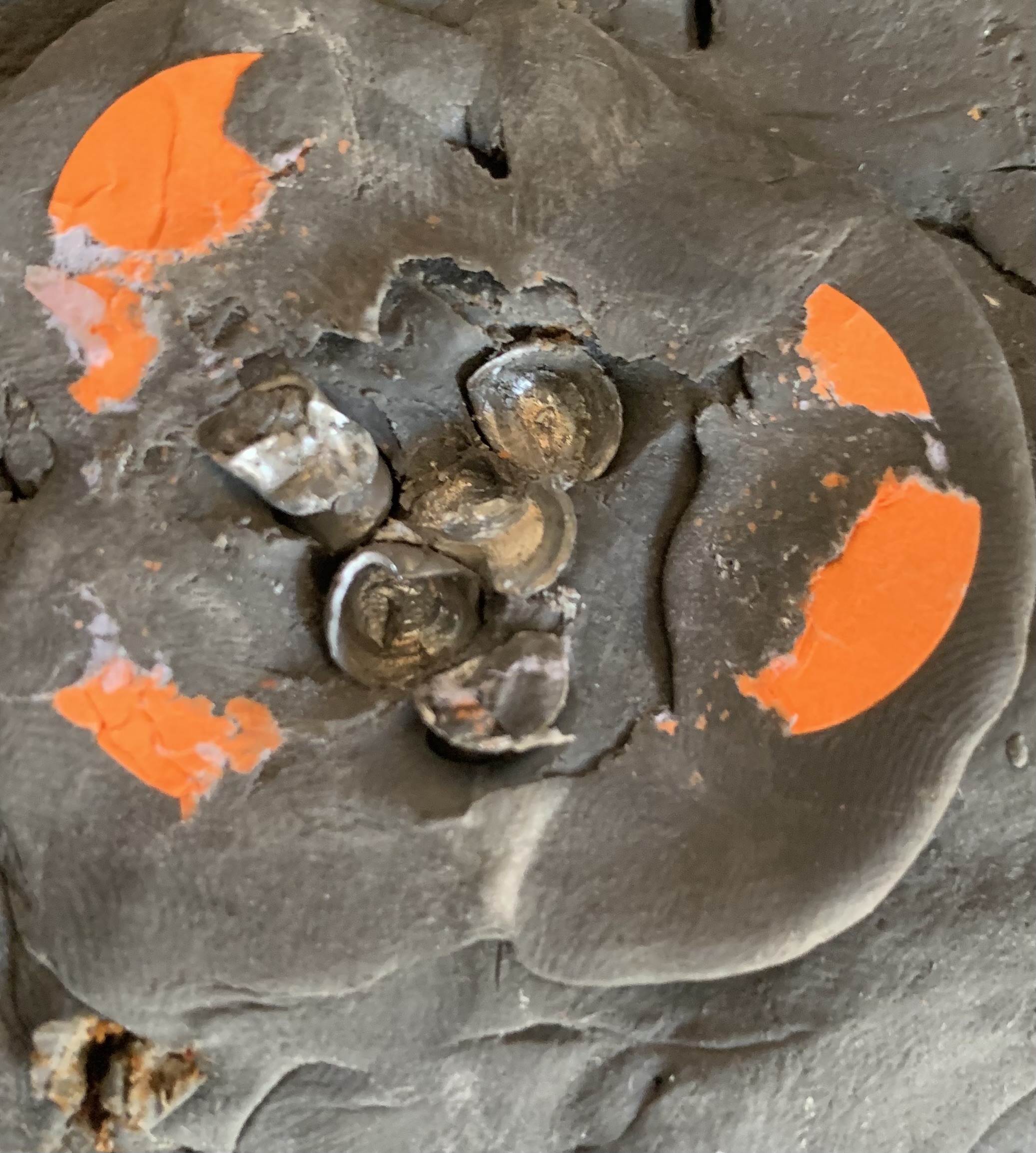

Of course, another key test is to determine that the pistol still shoots accurately. For this I shot the GK1 with functional shroud into a duct seal target from supporting bags at 35y. I know from past experience that it makes <1/2in groups in this manner with GTOs. To be thorough, I wanted to make sure that it was accurate at both the top and bottom end pressures of my typical shot string, which has an ES<10. Therefore, I made 5 shots from 290bar to 270, then shot off target at a spinner then returned to the same testing target putting in another 5 shots from ~230bar down to 210. As usual, the accuracy was top notch and I can confidently state that the shroud has no negative effect:
3/4 inch sticker on the duct seal, previously damaged by a couple sighter shots on left that were removed (I’m a terrible cheapskate with stickers)
Moving the sticker, you can see more clearly and yes, this is actually 10 pellets, mangled together!

Bernie - at this point, I am not keen to poke it again for fear of upsetting it because it is shooting so well. It really is just a matter of sealing those openings in the shroud and drilling/dremeling passages in the adapter to allow air to pass back. Regarding the former, making some carbon plates was simply the easiest option for me but there are other ways to do it. I was more concerned about drilling the adapter, because it was done manually with a hand drill, but it’s not too tricky. It would be great if someone could machine an appropriate adapter. The upshot is that this mod really quietens things down. Here’s a little clip shooting a spinner at 45y. It’s no louder than opening a can of soda and obviously, the sound you hear is inside a room!

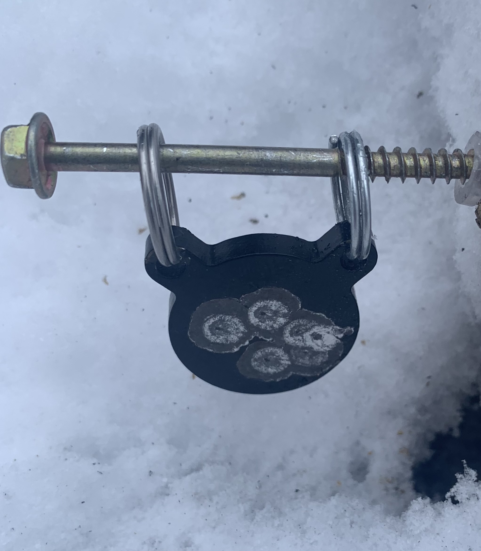

I cannot complain about the accuracy. Hit my 1in spinner 6/6 at 45y in a snowstorm just now. Our powdery Utah snow is a great assistant in reading the wind and I always do better in biathlon when it’s snowing!

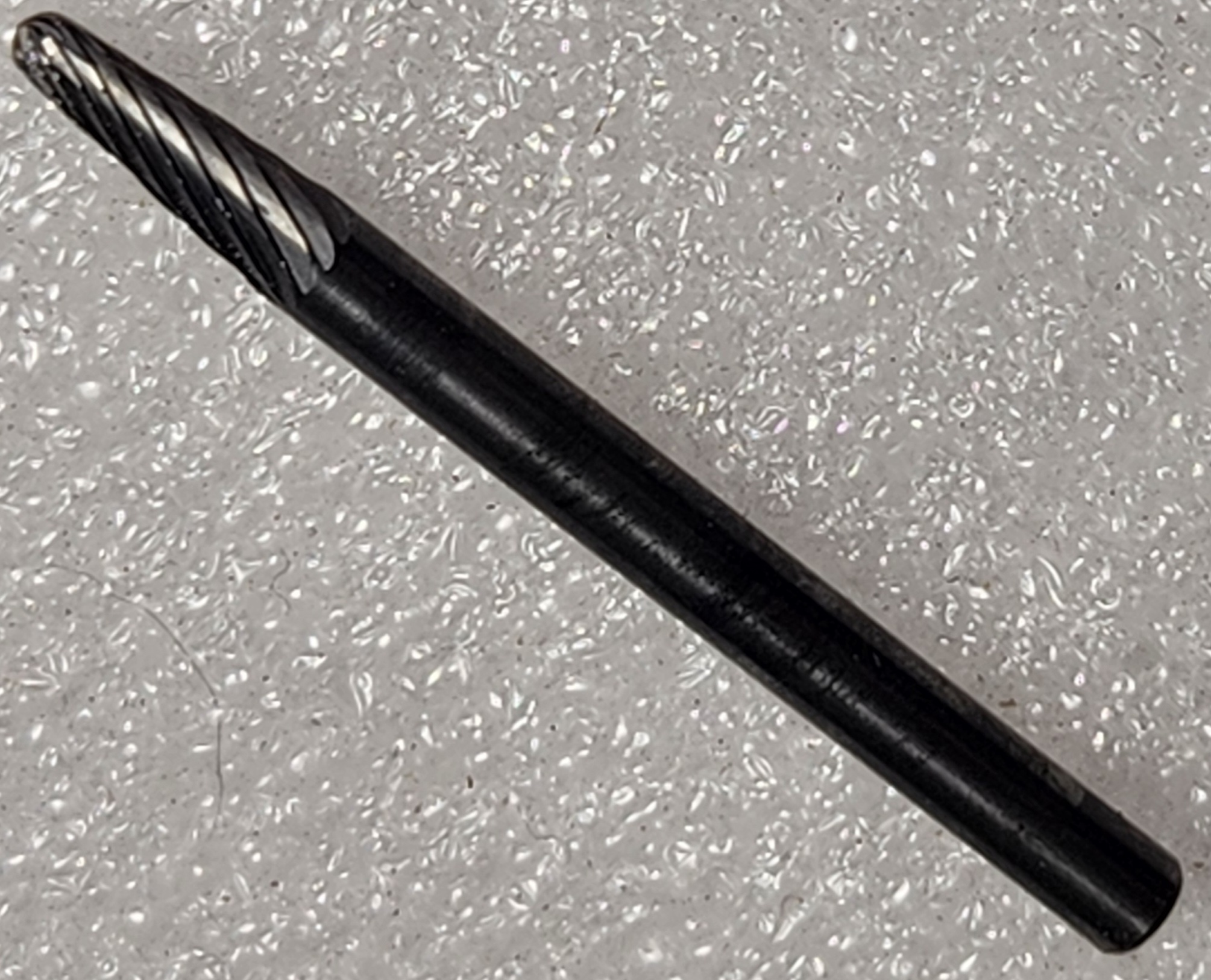

I took another path in porting the barrel adapter. To connect the roughly 4mm gap between the barrel's muzzle and the end of the adapter's threaded bore, I used a Dremmel and small carbide bit to carve 3 channels into the adapter's inside threads, which connects that gap to the inside of the barrel shroud. It achieves a result similar to yours, just from the inside.
I thought about cutting 4 channels and may try that on another adapter.

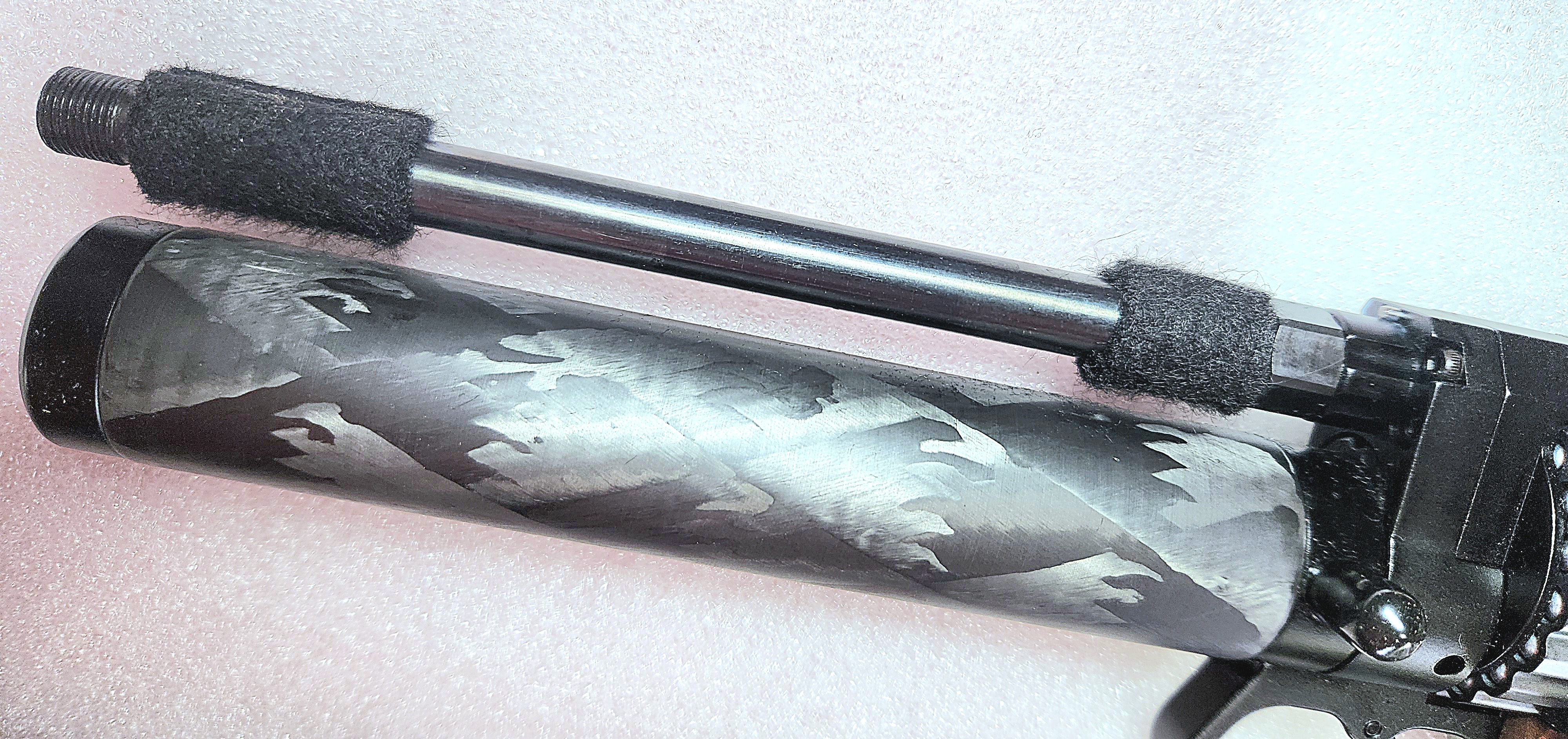

To dampen resonance, I wrapped adhesive felt around the front & rear of the barrel.
Since the bottom of the shroud actually contacts most of the air tank, I did not seal up its bottom openings. During shooting, there is some air that vents past the shroud/tank union.
Now the Shadow suppressor is about as quiet as the Weihrauch, prior to porting the adapter. And, it's still shooting the same tight groups as before.

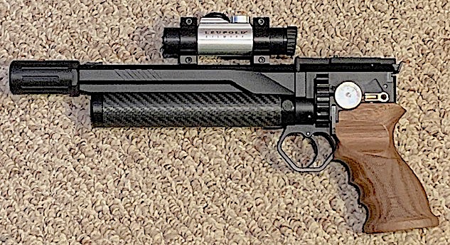

Just for the sake of those hesitant to take power tools to their GKs (like me); I've found the little Huma Mini 30 (mm outside diameter) moderator using just the 40mm long section (without the two other 20mm long sections) to be very effective at taming the muzzle bark, while extending the overall length of the pistol only about 1.5".
And of course the Mini 30 can be lengthened another 20-40mm by screwing on the other included 20mm sections for additional bark moderation (as I also use it on my .177 Brocock Wolverine rifle).
