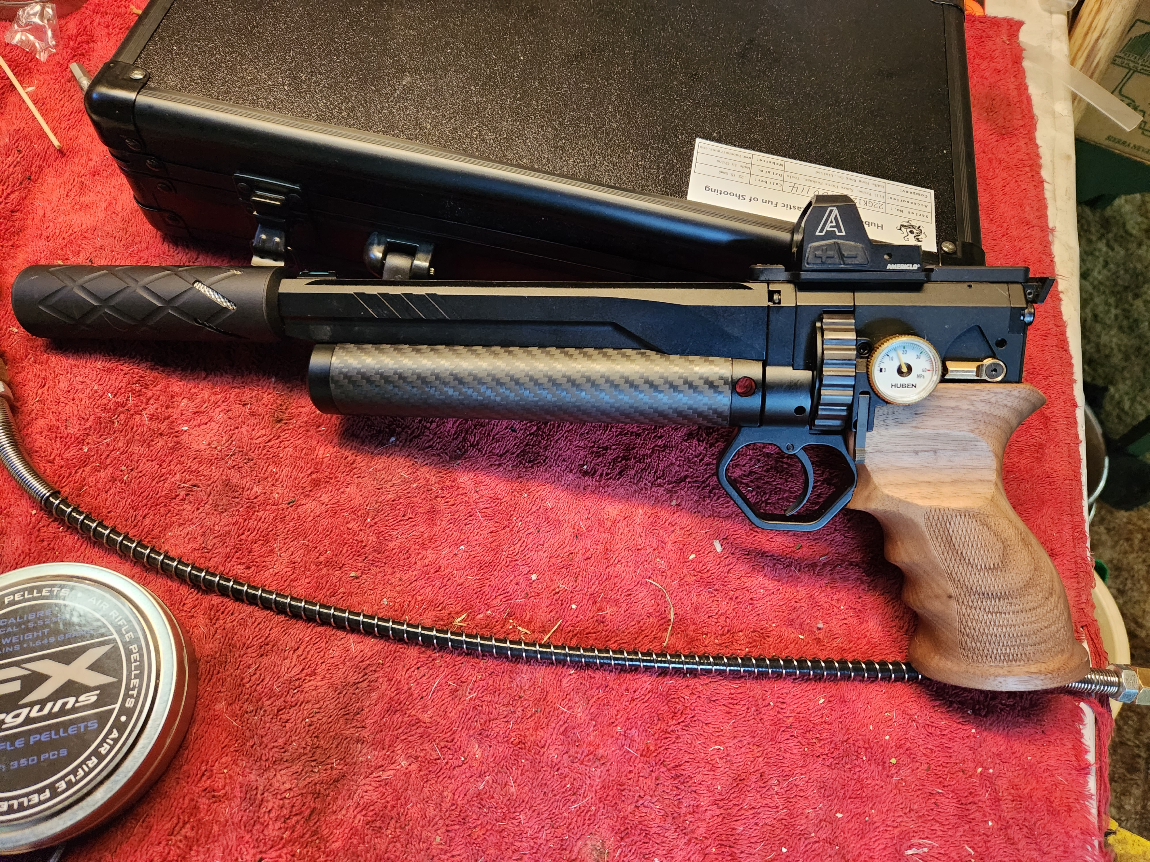

I think I finally got my recipe for my optics.
Holosun red dot as pistol and holosun with a primary arms 6x as a carbine. I can finally see shots clearly in both holds.
I added the factory cheek piece to my stock. The 6x flips to the side when I take the stock off.
The final touch may be going for a cf moderator to lighten a tiny bit.
