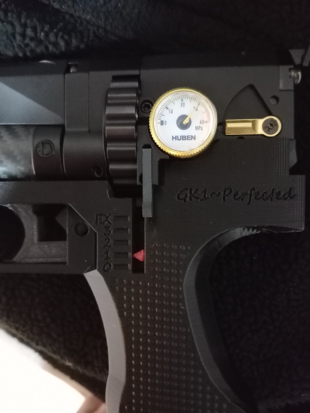

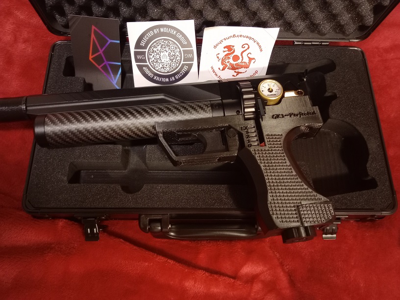

The GK1P (Perfected) is almost finished, I need to check more tolerances with test prints and polish a few things, but you whould have it soon on cults along with my loading gate and moderator and treat correction mod.
In resume, is a new handle that eliminates the waste of space of the original (that protudes far beyond the upper slide) and incorporates an adjustable power wheel on the base with indicator (up to 4 revolutions, can be limited with add on piece to comply with local airgun laws), plus detachable rear stock, plus optional piccatiny rail down the tank, wich I found it pretty stupid but people like those.
I also changed the trigger system, now its press on instead of rotation axis, I like those more, less prone to double shot than the original I think, the rotation still happens and no extra pieces needed, the trigger itself push a rotation lever, that allow to place the trigger further, even made custom ones to fit position.

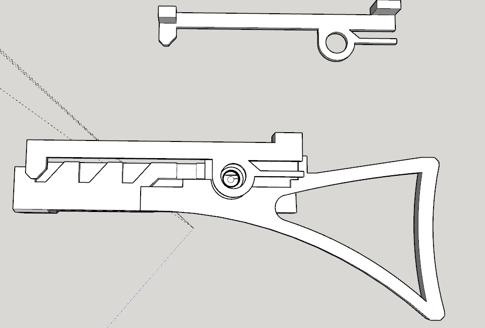

I changed the diana chaser/cp2 rear stock system for a better and more solid alternative, just plug it on the back and screw, I also want to make it retractable with numerous length positions.

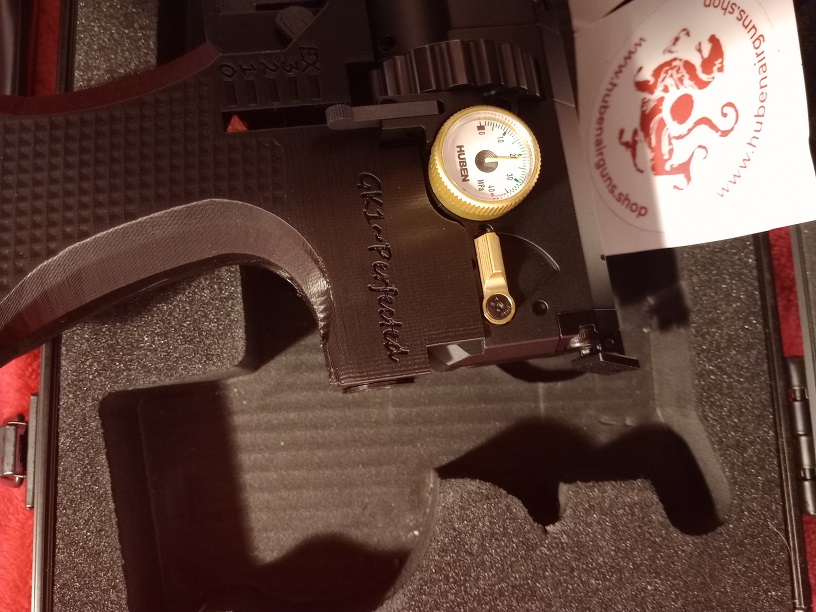

Almost done, I will try to finish it today and post the design at Cults, because if not, I won't be able to work on it for a full week. (Model showed don't have attachement bolt to comply with my local gun laws that allows me to have a customized gun, but not to actually done the mod myself, so just printing everything without the attachement part to check if everything is in place and works, yes, I print another stupid piece with the attachement and nothing else to check if that is also in place.)

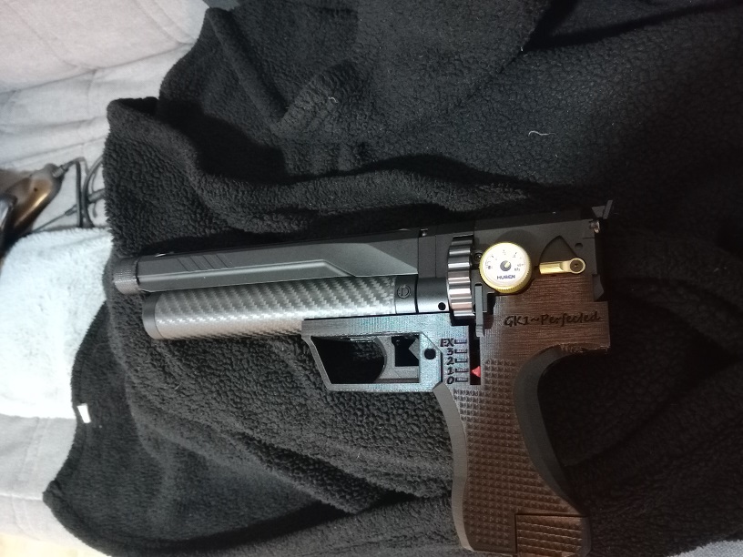

The handle feels much better than the original, and solves completely the extra space taken of the original bulky handle, trigger is moved forward, I will also add a furter moved trigger for those of you with big hands, and maybe a big hand model of the grip itself, but for now, I'll be lucky if I can print it all in time to check the model and publish the regular handle.
Well... I can't finish today, have to go tomorrow and I won't be having acces to a 3D printer on a week. A tolerance have failed and the trigger mecanism is not working properly, is just a piece that need tweaking and testing. Damn... really close.

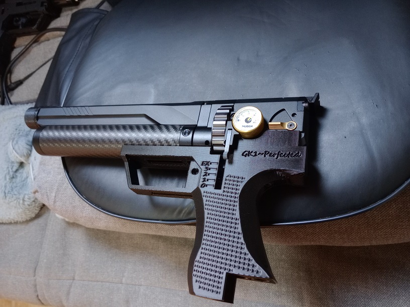

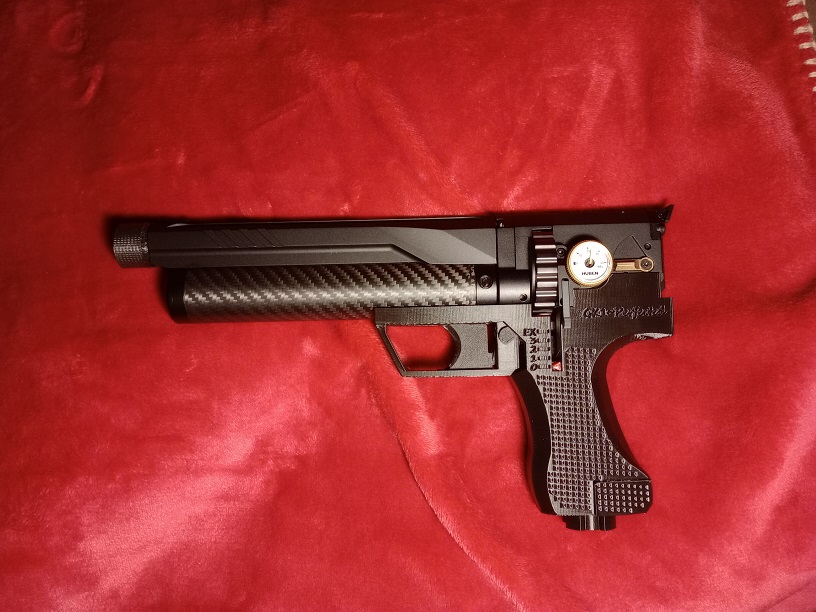

Still, this is the final look that will have, it also alters the point of balance of the gun, now is more centered so it feels less heavy on the hand and is easier to aim quickly.
Holy poop, I could cry right now... its done!!! its done!!!
I will post the design to download when I finish the instructional video of how to ensamble it. I changed the trigger mecanism cause I found the old one a little stiff, now is on pair with original.
The regulator dial goes up to 4,5 revolutions, also comes with custom limiters for diferent country regulations. GK1 is a bit shorter as it should, no extra space due to the handle, point of balance is also better, at least I prefer it this way, feels more natural and centered, just a bit weight to the front, instead of all of it. Sadly, only compatible with V1.
I also include a left hand version, I can't change the side of the indicator due to internals, and you will also have the molest charging rod of the original design that Huben solved in V3, but at least the grip is ergonomic.
I will upload this adjustable rear stock soon:

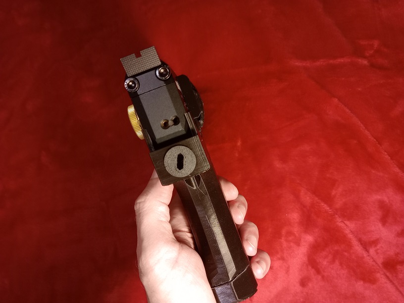

View attachment 435798View attachment 435799
View attachment 435788View attachment 435789

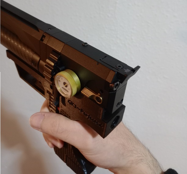

Yeah the placement of the web of your hand in the back of that grip is way to low for my liking, makes the rear sight way to high from the hand position, Looks akward,...guess it does not matter when in carbine form.
