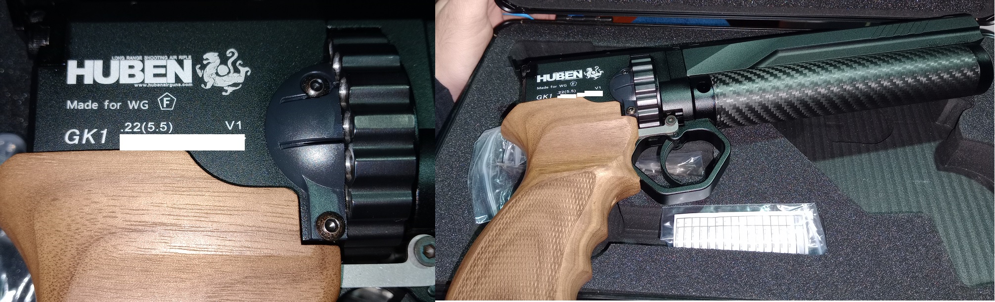

Huben GK1, Thoughts on the good and the not so good.
Well... I purchased the thingy, even if I stated that they have no shame to overprice it so much, and I even take a crusade to made a 3d printed 80 bucks max on materials (the pcp kit for the crossman 2240 and a crappy barrel from Gamo) pcp, double action, 23cm pistol with small game power, that for stupid legal reasons I can't even print in my country (but I found someone that can on his) to teach them a lesson...
But finally I purchased the thingy because... I like airguns, and this is the best thing ever produced in pistol format, even if its overpriced has f***, and lucky me, I get the V1 version that is more expensive than the newer V3 versions... for some reasons.
Don't even shooted yet because I only have .177 pellets in my house and no airgun shop in my entire city, well, I dry fire it to adjust trigger sensibility, so I cant talk about accuracy or any feeding/shooting problems yet.

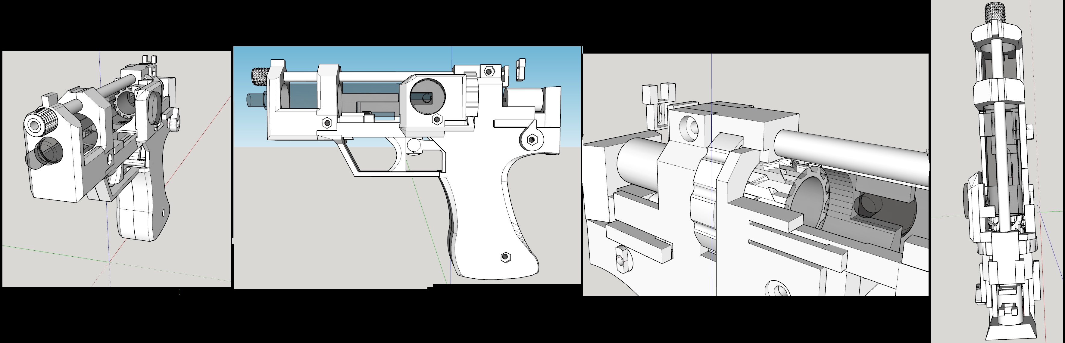

Things that can be 3d improved:
A plug to cover the charging port when you are not filling it!
Another grip that not protude out of the upper body of the gun. It will have to replace also the trigger guard and maybe the transmision rod to advance the whole trigger further.
A loading gate that don't cost 28 bucks, cause theirs is also crappy 3d printed.
Tuning gear connected on the regulator to adjust the power at any time, plus mechanical numeric indicators, it can be done... but for some reason the manual states that you must turn the valve just a quarter every time.... why? I don't see any mechanical problem with not doing it that way.
When I finish the Cheapo/poor man's Huben GK1, I will compare the two, and then maybe I'm gonna start making 3d mods for the GK1, wich I can never use on mine for legal reasons on my country.

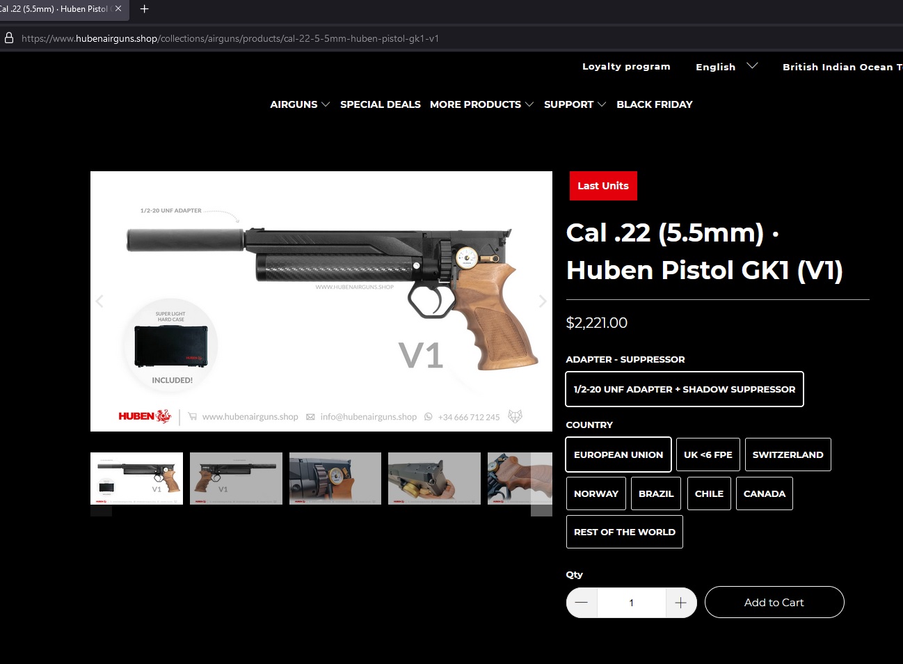

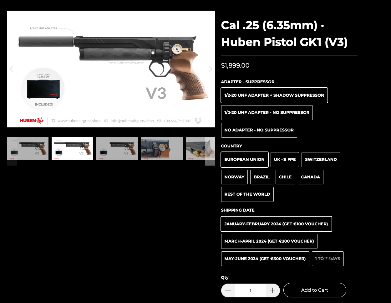

2.221 Dollar for the V1... (1.999 Euro on my country)
I payed1.399 just before they split into V1 and V3 and price start ramping up, and they send me recently a V1, so... lucky me, I guess... Still I don't get why the V1 is more expensive.
Well, the "shadow suppressor" and the adapter are provided with this one, which explains the higher price tag.
