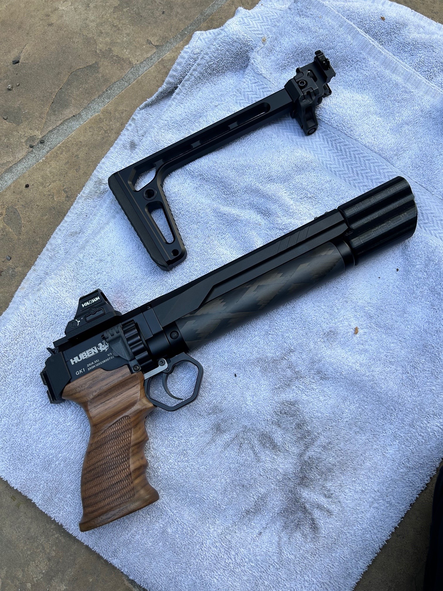

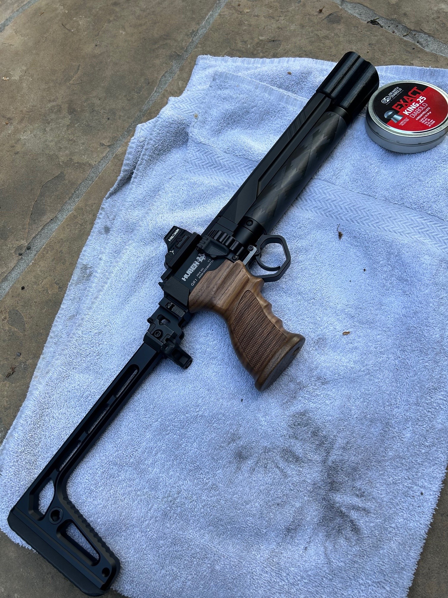

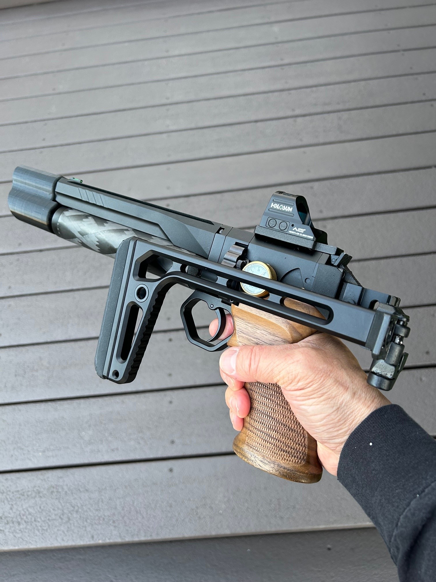

To me the GK1 is all good and cannot find any real not so good aspects. It to me is not overpriced for a pistol that can shoot at air rifle velocity with incredible accuracy and do so in semi-auto reliably. You can get the pistol for $1250 at Ares Tacktical whom also provides great support at https://www.aresairgunstactical.com/Air-Pistol_c_189.html
Yes you can say it would be better with a removable mag but I am not sure about that as this design holds either 17 or 19 rounds depending on the caliber and with the mag fixed I feel it is more reliable.
There are so many aftermarket parts to enhance it that hose to me have solved any minor improvements most would like. The huben3dparts.com loading gate that allows you to load 3 pellets at a time, their low profile red/green dot mount that puts the sight in the rear where it should be, the dust cap they also sell, and look up "TorqueMaster" here on the forums and he can 3d print "Subscribers" moderator designs (the 2.75" shorty I use 90% of the time and the 4.5" version the 6.5" oval). After all of those on my GK1, I cannot think of any short comings. Oh I forgot I just purchased the rear picatinny mount from huben3dparts so now in a few seconds I can turn the GK1 into a mini carbine and have 3 points of contact to shoot past 25 yards!
The reality is the Huben GK1 has smoked the entire air pistol market as there is nothing remotely close to this performance at any price!
