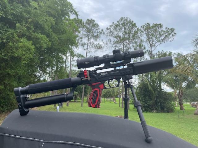

I’ve owned 2 leshiy2 and a gk1, I don’t like the L2 trigger. If they would change it I would get a new one. Both my leshiy2 are gone, I’ve still got the gk1. The gk1 trigger is way better then the L2 or Sidewinder s. The factory gk1 mod is pretty good, it’s much easier to shoot accurately for me because of the trigger. On both of the L2 I’ve owned I couldn’t squeeze the trigger otherwise it would start bleeding off
I’ve owned 2 leshiy2 and a gk1, I don’t like the L2 trigger. If they would change it I would get a new one. Both my leshiy2 are gone, I’ve still got the gk1. The gk1 trigger is way better then the L2 or Sidewinder s. The factory gk1 mod is pretty good, it’s much easier to shoot accurately for me because of the trigger. On both of the L2 I’ve owned I couldn’t squeeze the trigger otherwise it would start bleeding off View attachment 484472
I believe the trigger is its weakest link although as PasadenaMike said with practice you can overcome the trigger issue. I can with regularity get 1/2-inch groups out to 50-60 yards. The original Leshiy had a so so trigger also but there was a spring and steel ball aftermarket thing you could do to make it better, kind of like a 2stage trigger. A firm grip and full commitment works pretty good for me with the L2.
