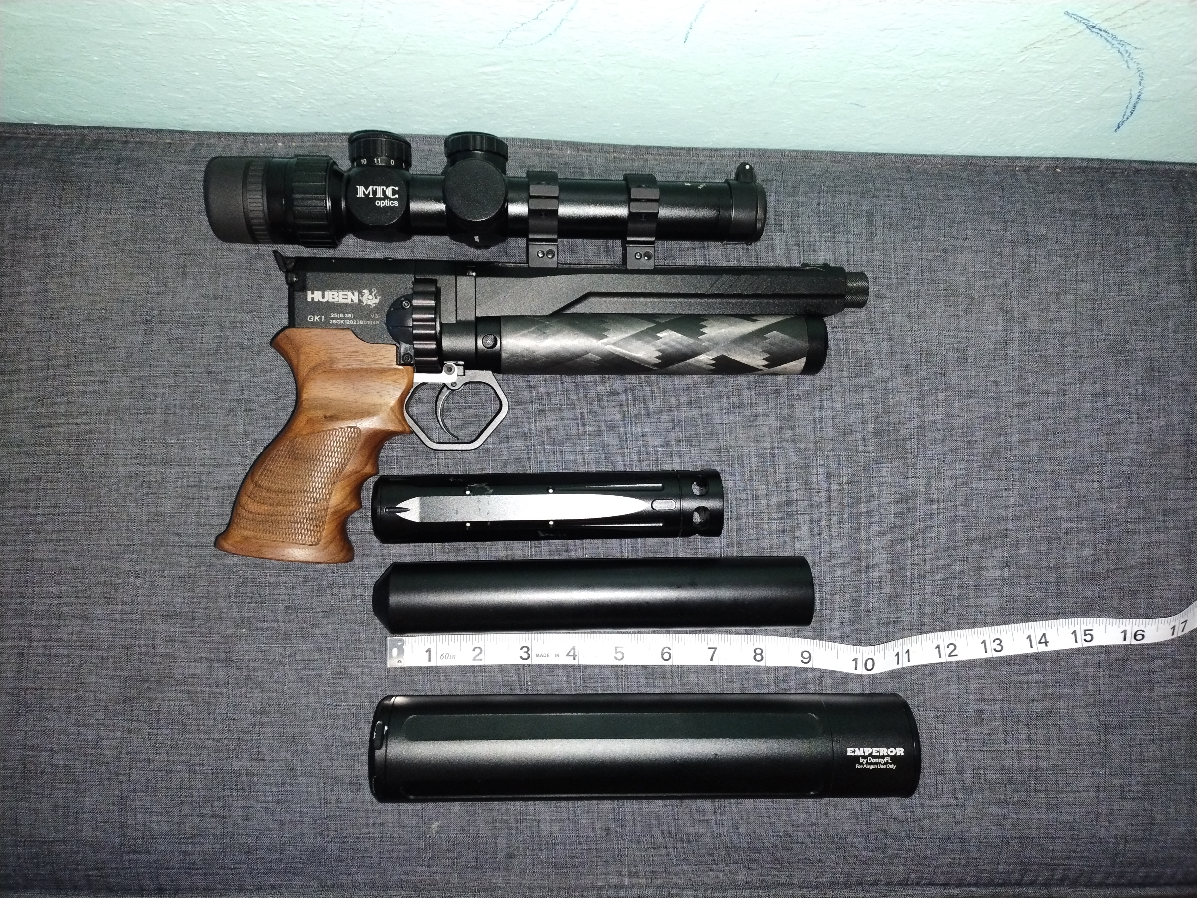

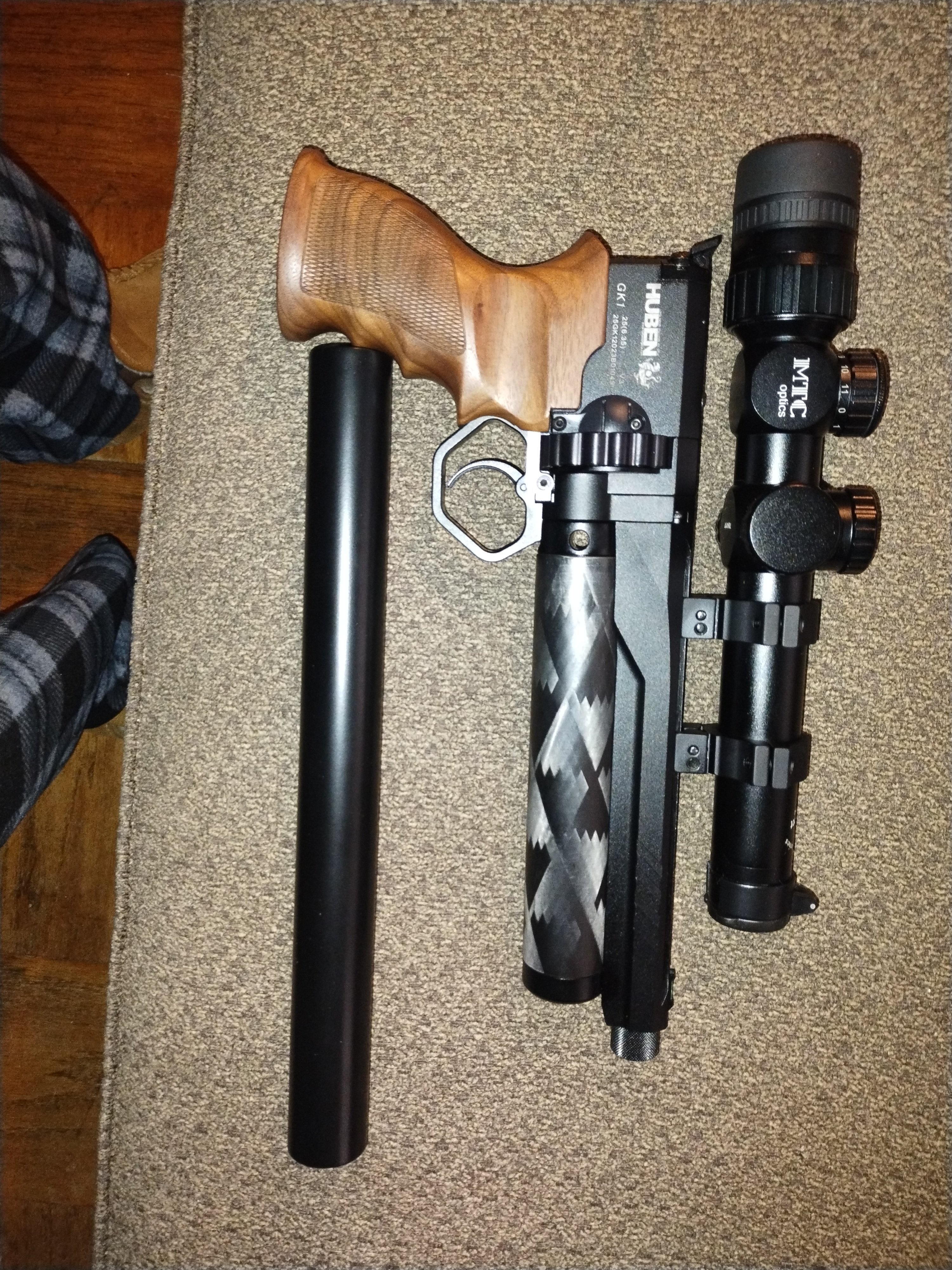

I feel where you're coming from, seeing GK1 users using small moderators and then saying it's quiet.
I knew going in that a short barrel & high power was going to be loud, so I had Neil Clauge make me the smallest diameter length not important, moderator (pictured).
If it's quiet you are looking for, the middle moderator is also made by Neil Clauge and does a better job than the Emperor and costs less.
