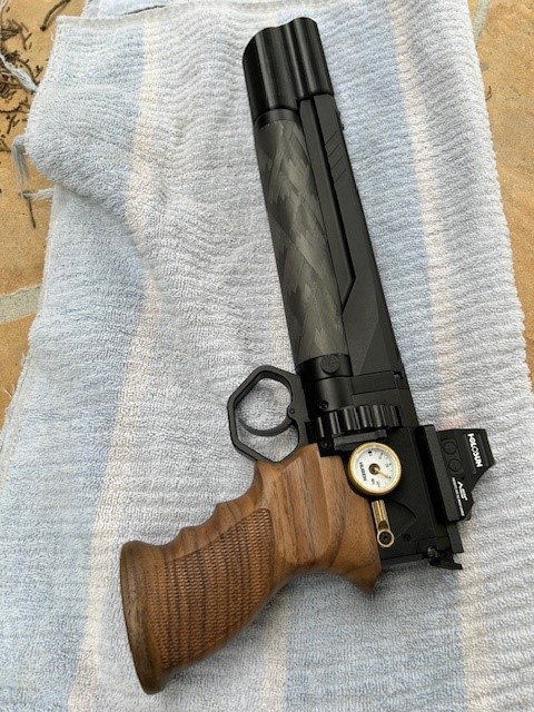

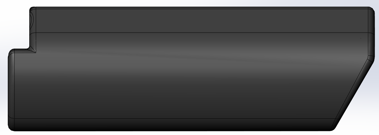

I am happy using the moderator Torquemaster made for me and I have over 4000 rounds with no issues...
