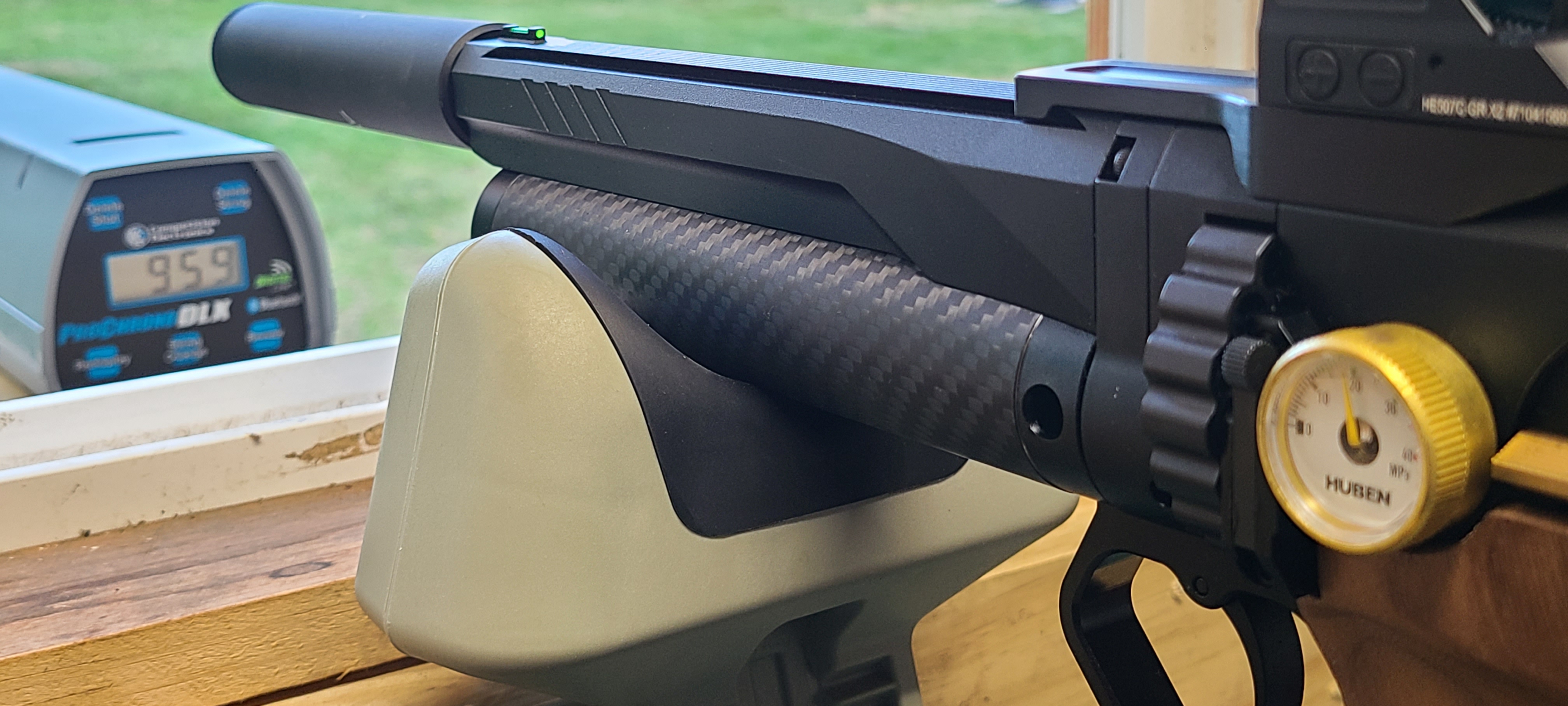

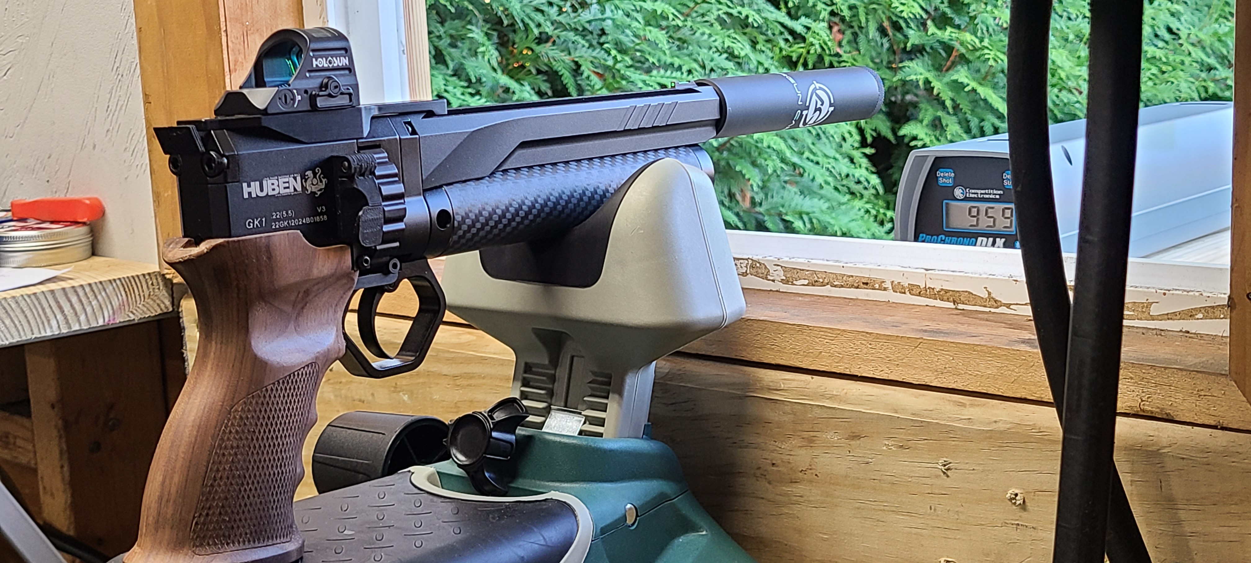

Wow!! First time shooting with my Donny FL Tanto and it works well. No hearing protection needed. It slightly obscures the front iron sight, but not enough for me as a shooter to adjust. My first group looked tighter. I’m going to keep shooting to see if that’s a consistent trend.

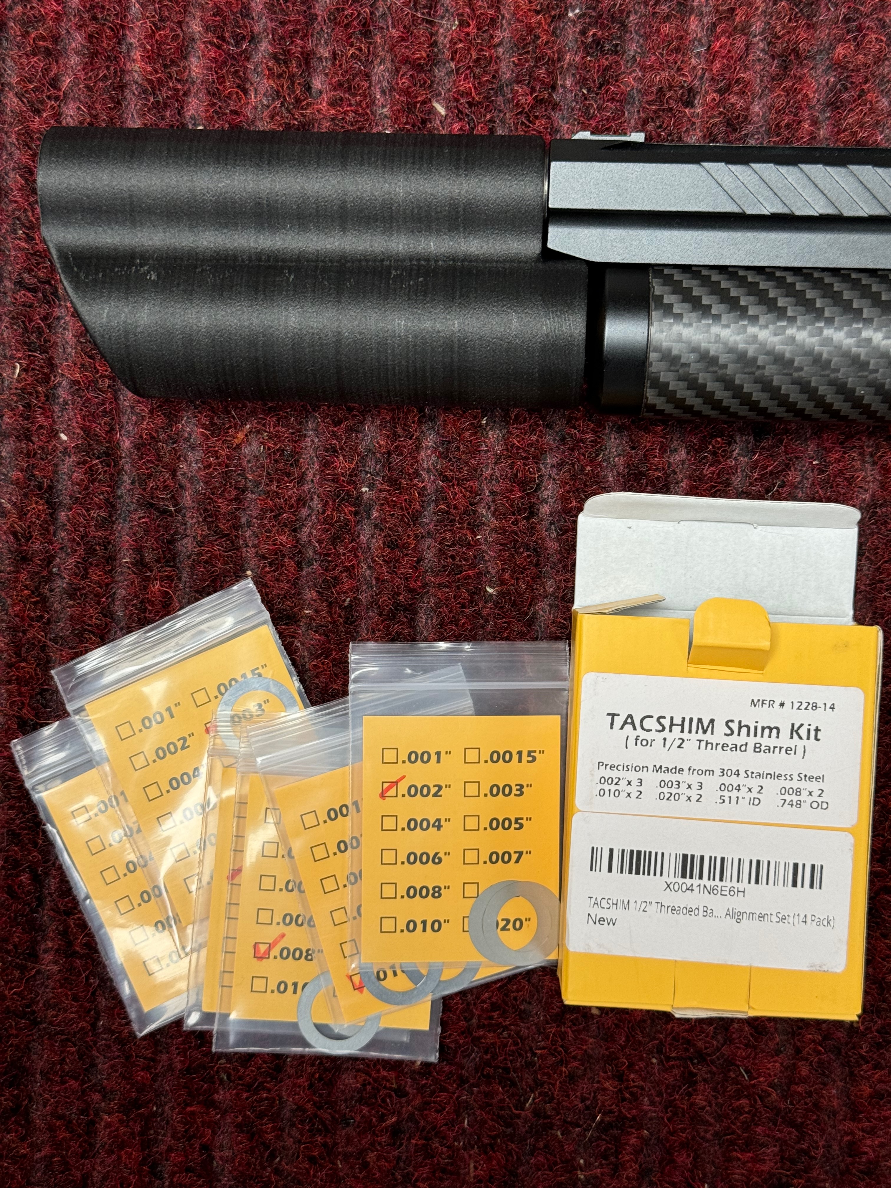

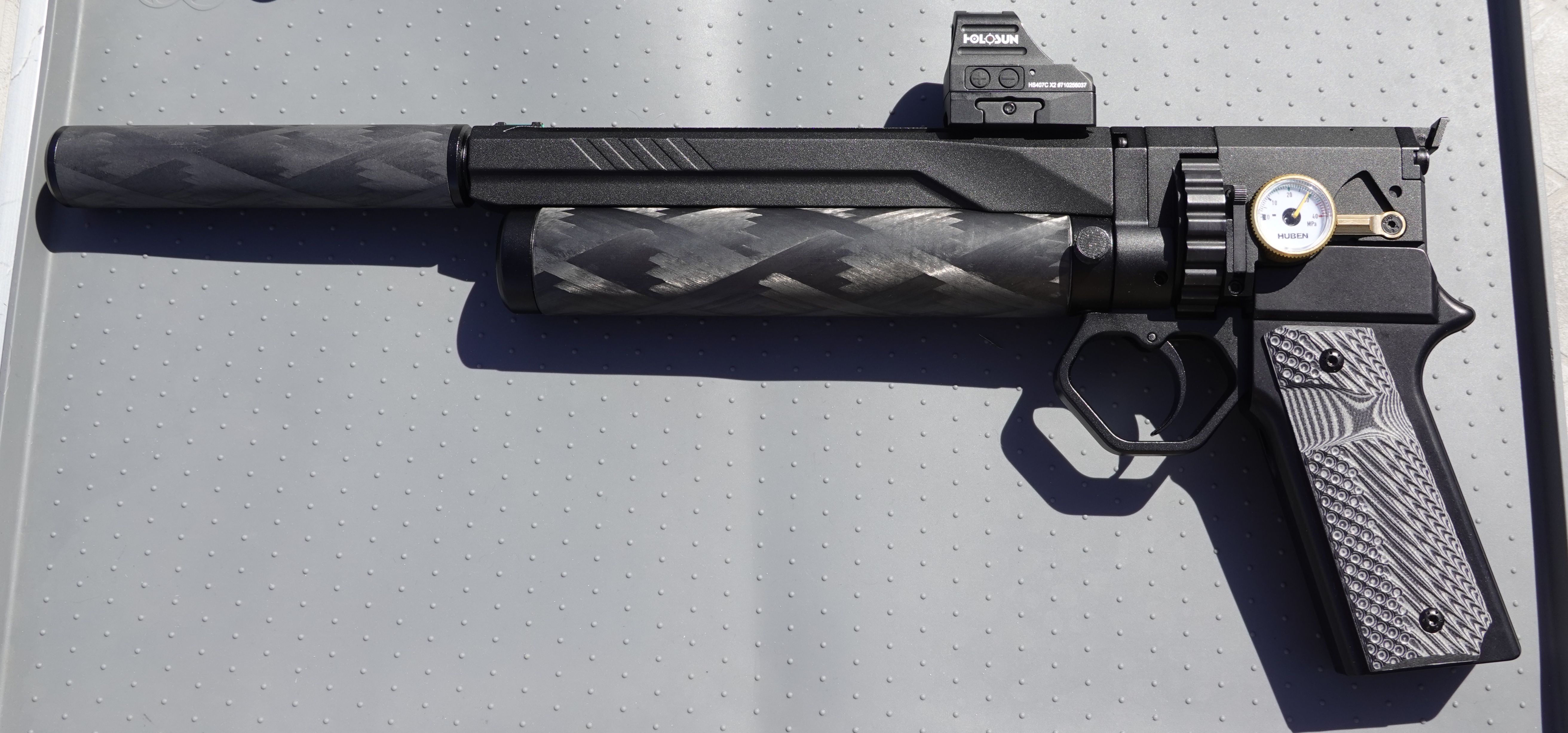

Using a 3d printed moderator. I used Bambu PA-CF filament for the first time and I am super pleased with the results. Perfect thread profile, no stringing, good surface finish, 10g lighter than print in PETG with same settings. Since the moderator I'm using is not cylindrical it needs to be "clocked" using some sort of spacer in order to line up with the gun when tightened up. I bought some 1/2" barrel shims for $10 delivered. Very handy, easy to justify buying... I have enough shims to do multiple guns.

I didn't know about these washer shims, and made my own, by making and grinding a washer by hand to fit. Tedious, to say the least, and hard to keep them flat. It's astounding that 5 degrees of error is only about 0.0007" for a 20 TPI thread. [ 1/20 * 5/360 = 0.0006944" ] By the third washer, I got pretty good at making them and quite a bit faster. Good to know about these pre-made washers!

Seems to me that if you print the moderator then shims ought to be a piece of cake.

Printing is tough to keep the necessary tolerances required to avoid a shim. Its possible, if you have the original CAD file to make a minute change in dimension, or even to slightly rotate the start of the female thread. I'd think rotating the helix might be easier than adjusting the thickness to the precision required.
Simple FDM printers are ok, but they are not terrific at holding dimensions, at least not to 0.0001". Part of it is the precision of the printer, and the other part is the precision of the slicer. I've printed U-channel sections to hold a DRO read head, and the slicer really has issues with getting the inside dimension correctly, it's not one of the things that is optimized. Likewise overall length. It's close, but not micrometer close. Simply a limitation of the technology, and how well one's machine is calibrated.
Basically, it's not very easy to print a precision shim to the tolerance required, which demands 0.00014" (1 degree) accuracy. You can fudge it a little, but not by much.

I use a 3D printed one on my .25 GK1, it does a really good job making it backyard friendly and is only 3" long. The diameter is 25mm, so the iron sights can be used.

I recently acquired a .22 V1 that came with a Huben Shadow suppressor. Shooting JSB 16gr @ ~660fps, the Shadow is astonishingly quiet for its size & weight (5.25", 2 oz).

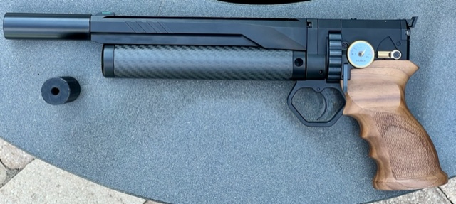

I have several more airgun suppressors on various guns which were tried out on the GK1.
The Weihrauch is considerably quieter but is 7.5"x1", weighs 4 oz & slightly obsures the front sight. However, I could still hit small targets @ 20y with the open sights.
The Huma 30-4 is almost as quiet as the Weihrauch, 7.2"x1.33", 4.6 oz & completely obscures the front sight. As a 3 section, it was similar to the Shadow.
The Huggett Astille-Plus is as quiet as the Weihrauch & has a slightly lower tone, 7"x1.44", 6 oz. In its shorter form, it was only slightly quiter than the Shadow.
Both Buck-Rail (thin & thick) suppressors are quite a bit louder
than the Shadow.
The Subscriber/Torquemaster 2.8", GK1 specific suppressor is in between the thin & thick Buck-Rails. It lives handsomely on my PP700-SA, shooting JSB 16gr @ 500fps.
The S/T 6.5" oval, GK1 specific suppressor is a bit louder than the Shadow. However, it is designed to suit this gun at much higher velocities. To be fair, I'll need to up it's power and compare the 6.5" oval to the others.
So far, the Shadow is my favorite for this pistol because it surely is backyard quiet, looks nice & proportional on the GK1, and its weight is nearly unnoticed when shooting one-handed.

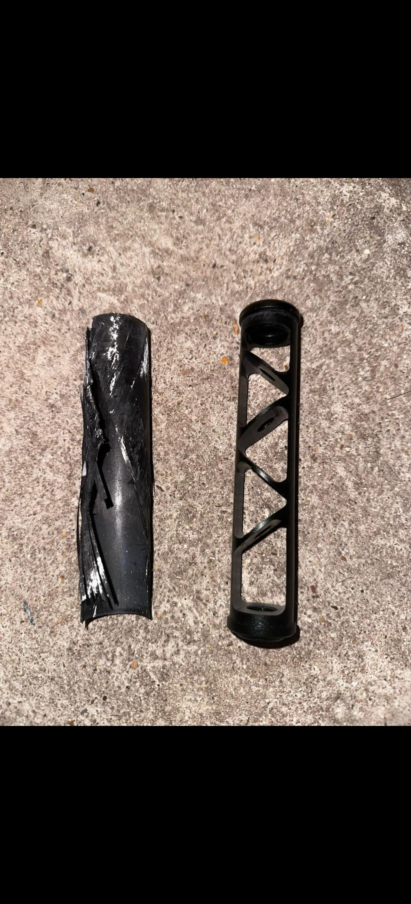

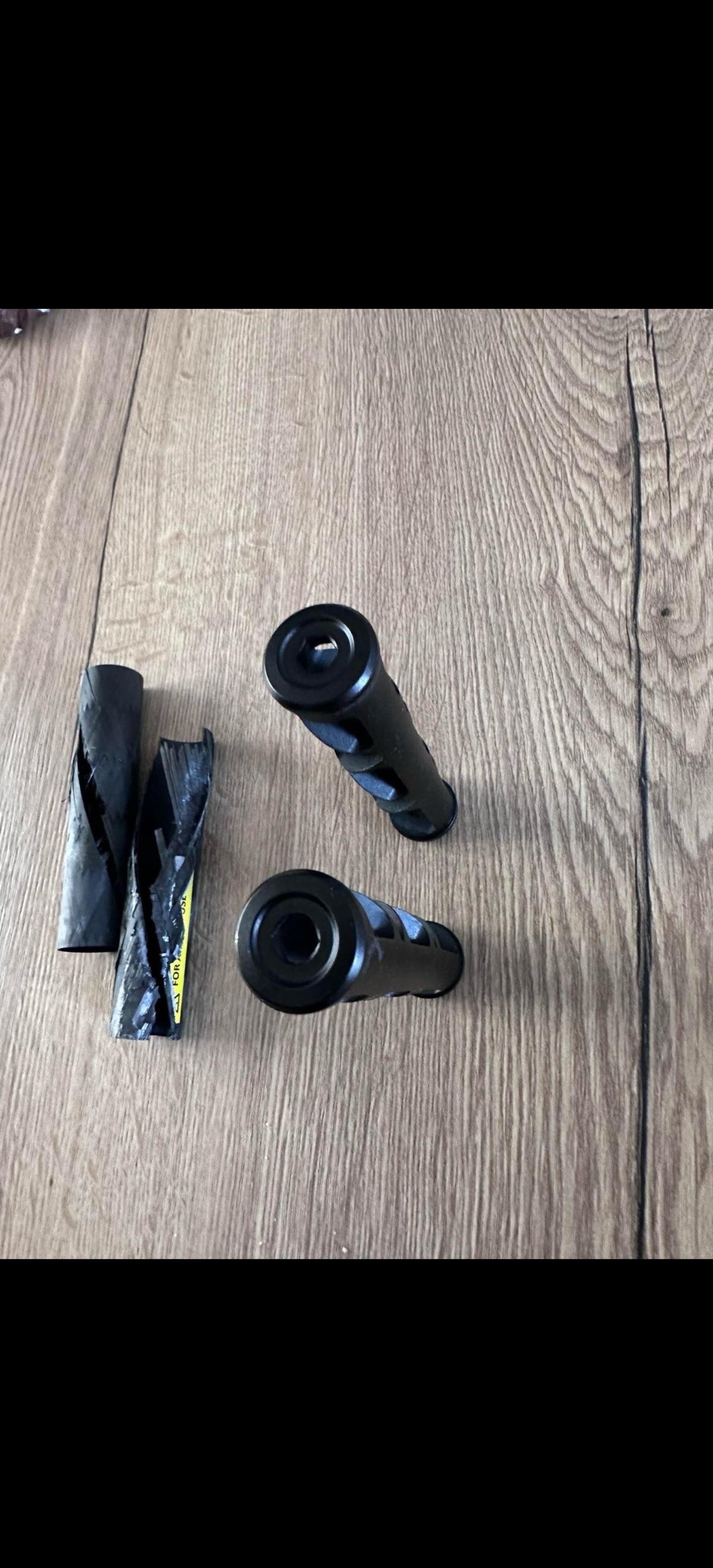

Mike,
That rapid disassembly is not surprising. In fact, the original write up in which this LDC was developed stated that your warrantee expires, if your GK1 dumps the air tank.
It is like a 5 MPH rated bumper taking the vehicle structure with it, should you crash at 50 MPH.
I trust that while the event was ear-splittingly loud, it was not harmful. That the plastic bits flew forwards and outwards.
Your picture suggest very good layer to layer adhesion, as the fractures are through the material, not at the layer boundaries.
