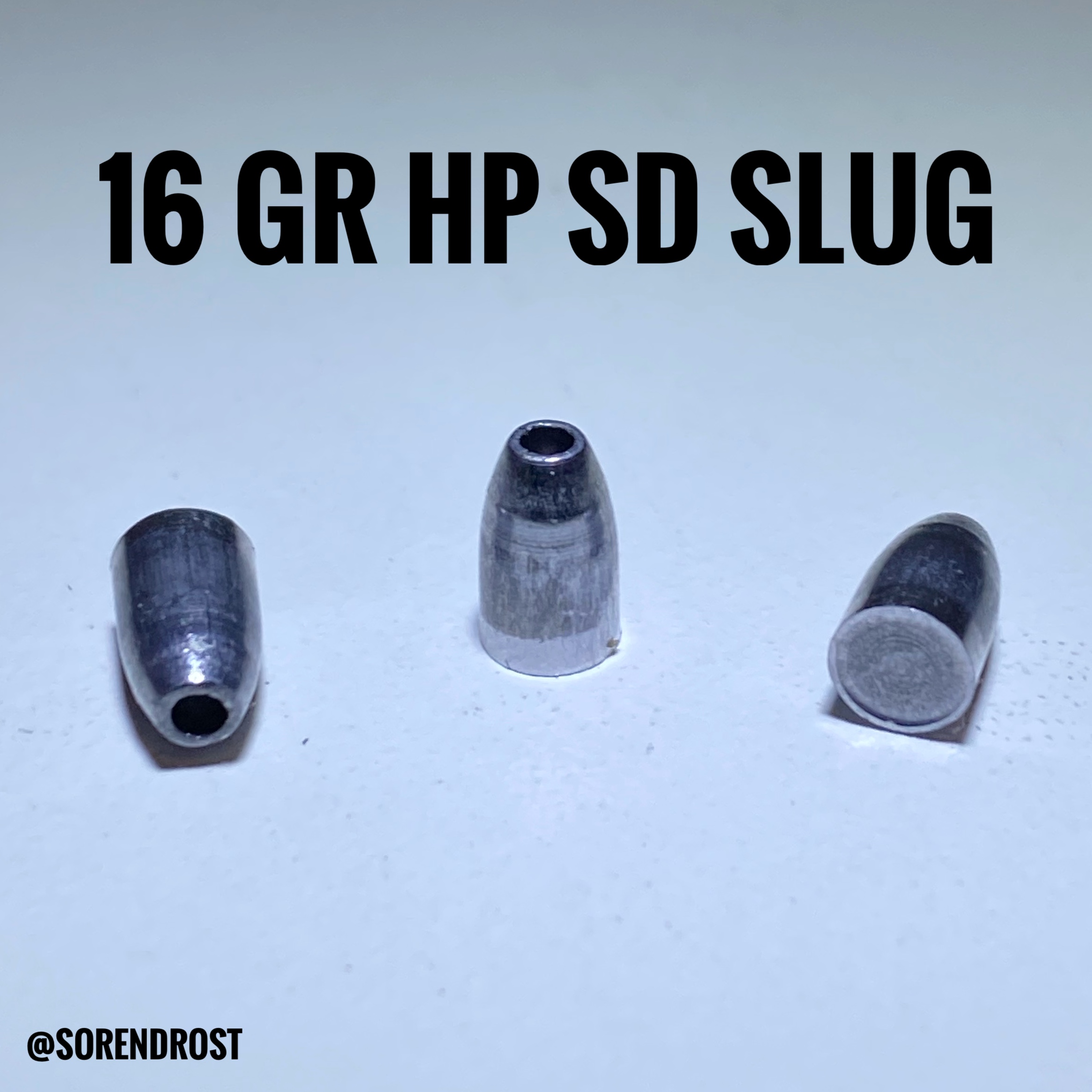

Enjoying my 16 gr slugs in .177 👍😃🎯

Hi buddy, what is the BC of these slugs? can you show any group as well? thanks
Hello @Esab , We have been here since 2018-19, Just when FX airguns took interest in working on the slug liner based on Matt's Input and Neilsen slugs. We do not compete with major brands because we make tools not slugs and our philosophy is Self sustainability rather than outright competition,
Now speaking about competition 2 RMAC PMC titles, NRL 22 PRS world championship is won by Patriot javelins ( we made those dies! ) So we deliver on what the partner demands. But we will give the option to make absolute high BC solid slugs or absolute mushrooming design or the regular Hollow point slugs,
total 3 design types and 3 die types and it will work on almost all presses.
