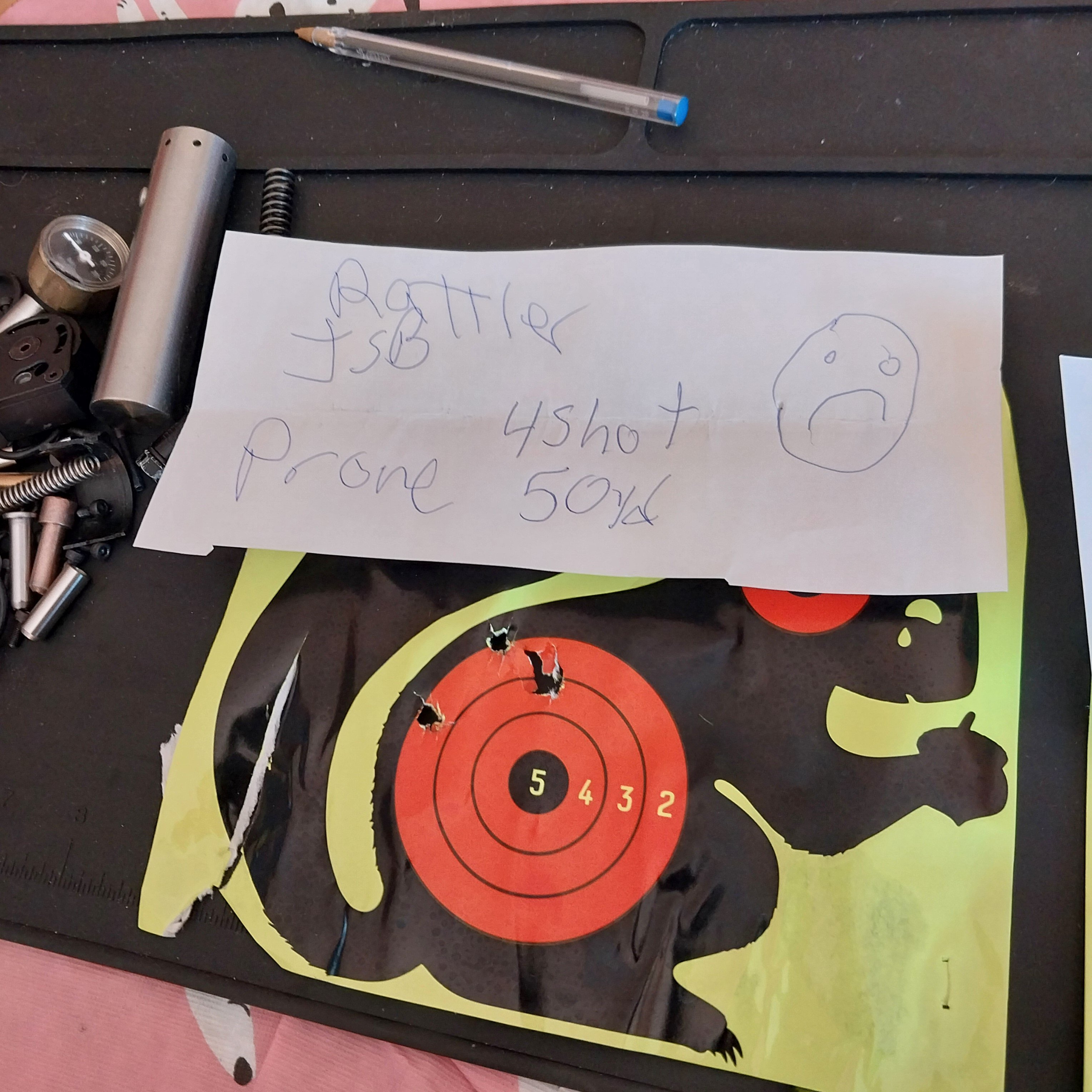

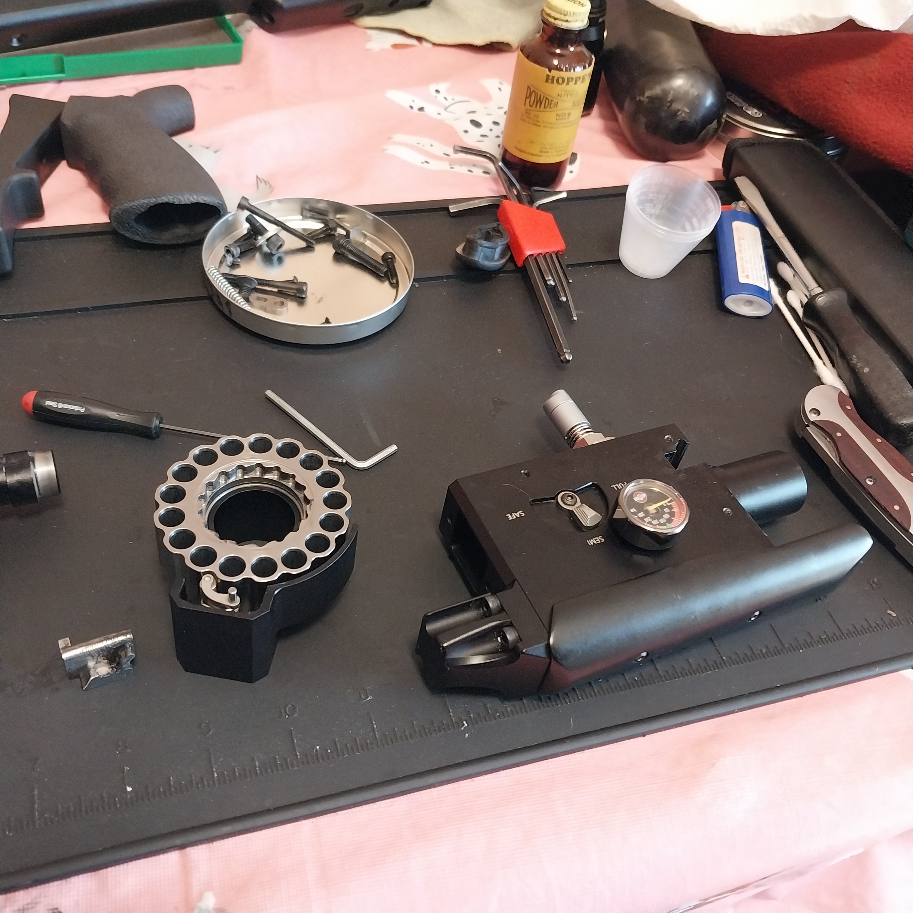

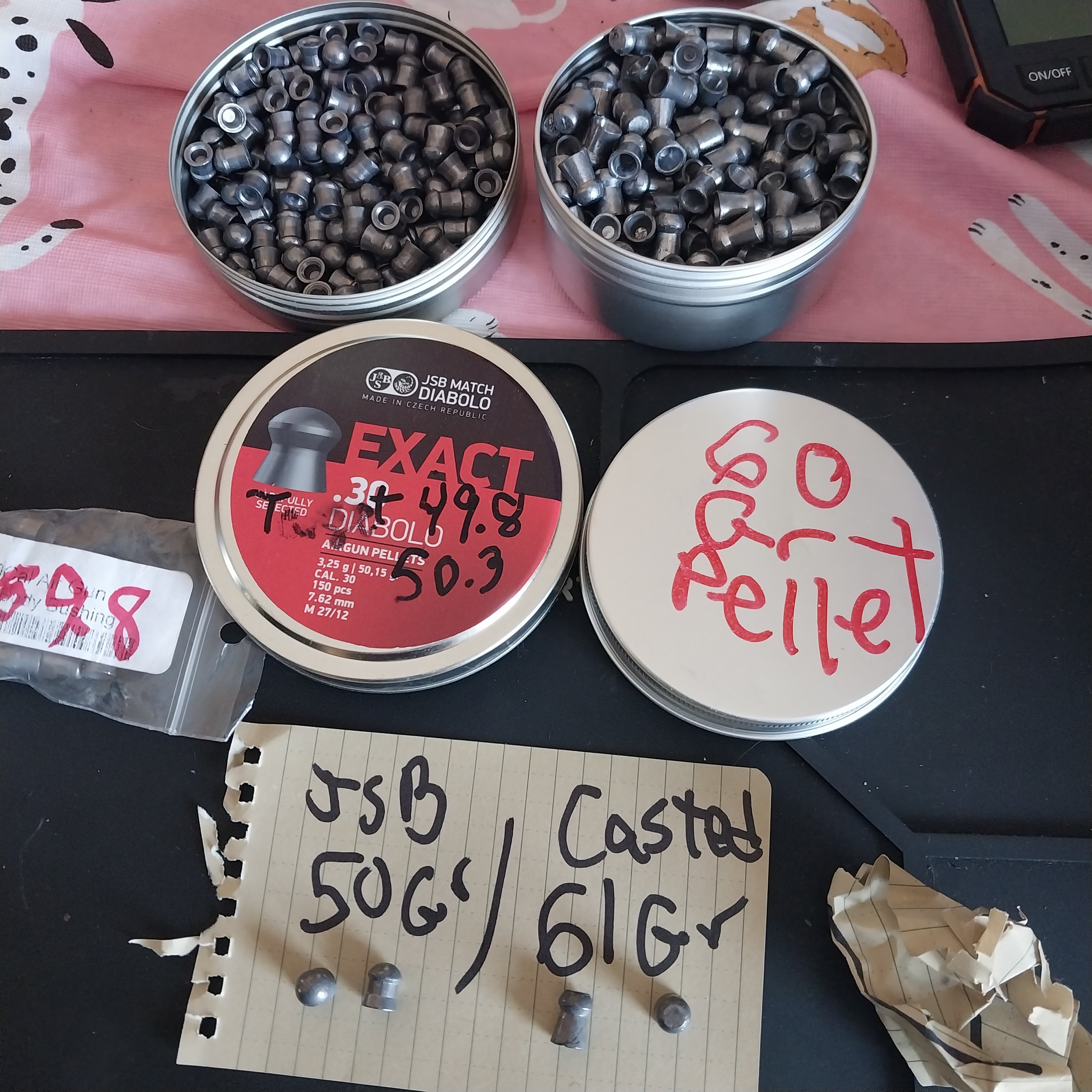

Loaded gun with pellets 60 grain ones , mag holds 17 after 3 shots it jammed , I had to remove barrel and hammer deformed one back in magizine , my reg started at 150 after gun jammed it dumped air in bottle ,
Next say jsb 50 gainers same thing 5 shots and jammed , next time I tried Gmi slugs and sam3e thing ammo jammed in magizine , and reg was 200 bar ,

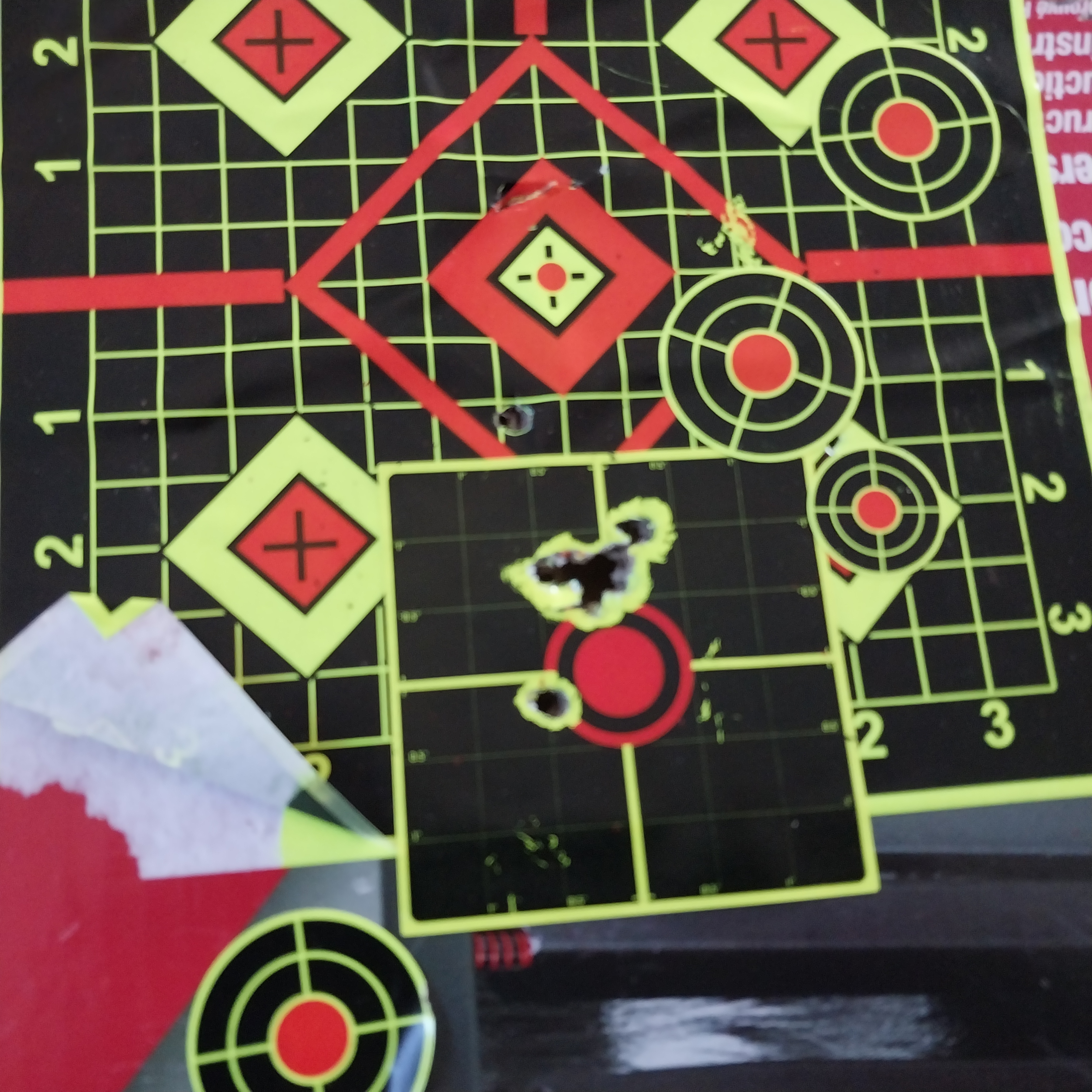

so I loaded 2 slugs at TIME and shot 10 rounds at 50 yards omg looked like I ahot it with a shot gun , I also tried 2 of my donnfl both gets got broken in my shogun and emperor i was not happy I called aoa a few times tried a few things like adjusting more air to magizine , this is semi auto and you can adjust this ,did not help and my reg was horrible , I ended out taking gun apart completely
I founf so many things wrong with gun , action , loading , reg it was horrible this gun was sold for over 2k . to make it worse , no diagrams anywhere online and also wrote to western 3x with no replies , Well I learned the LCS sk19 is same gun with many things on line for this pne ,
ok Lets dig into issues

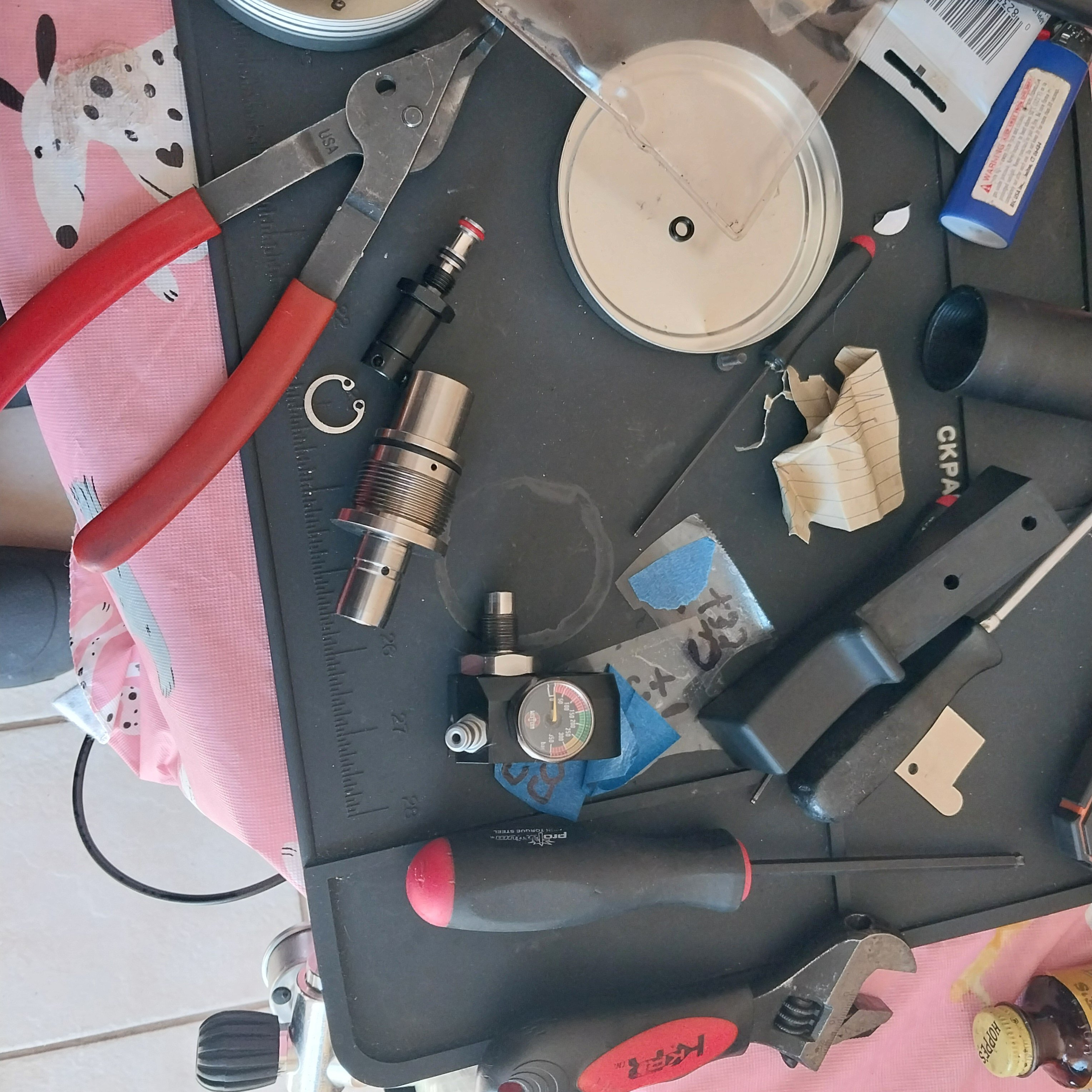

1 my regulator es was like 140fos , due to the fact the entire regulator was solid Rust all washers rusted together ,
2. there was rust on the piston for reg here it sealed along with sand or lead particles , I cleaned everything polished washers with 10,000 frit paper and oil and bore with jb bore polish , I reassembled regulator , I then refinished delron seat ,by hand I tried to flip disk but ended up cleaning debris and polishing it all flat again , and reassembled
3, Barrel , I measured barrel muzzzle and breech and also magisine , well mag ,300,, the breech .301 and muzzle ,294 . you wild think .295 would be best however in fully auto and semi auto ammo must stay seated or they will flop and jam , I tried every size and ended up with ,300 aS ,299 sould move and can jam , so , if I did re-barrelled it opt for muzzle ,298 like every other 30cal out there as this mush drag means have to clean more then norm ,
Barrel issues ok now for barrel flaws My barrel had 4 flaws , 2
being breech and muzzle not square and in middle it got tight then loose then tight , the crown was not square and both ends not square off by ,003 and ,006 , I checked up barrel in lathe squareed both ends , then i cut a 13degree crown , I then repaired a gouge near muzzle my guess is last owner sleaning rod hit ,
then I polished barrel on lathe i cur PEN MADE A CENTERING BUSHING , AND MY CLEANING ROD , i MADE A CAST OF MY BARREL WITH LOW TEMP LEAD 214F , I INSTALLED THREADS IN ONE END AND ATTACHED TO MY CLEANING ROD , AND PUT 240 GRIT AND POLISHED BARREL , THEN CLEANED AND THEN REPEATED WITH 480 GRIT CLEANED THEN 600 GRIT CLEANED

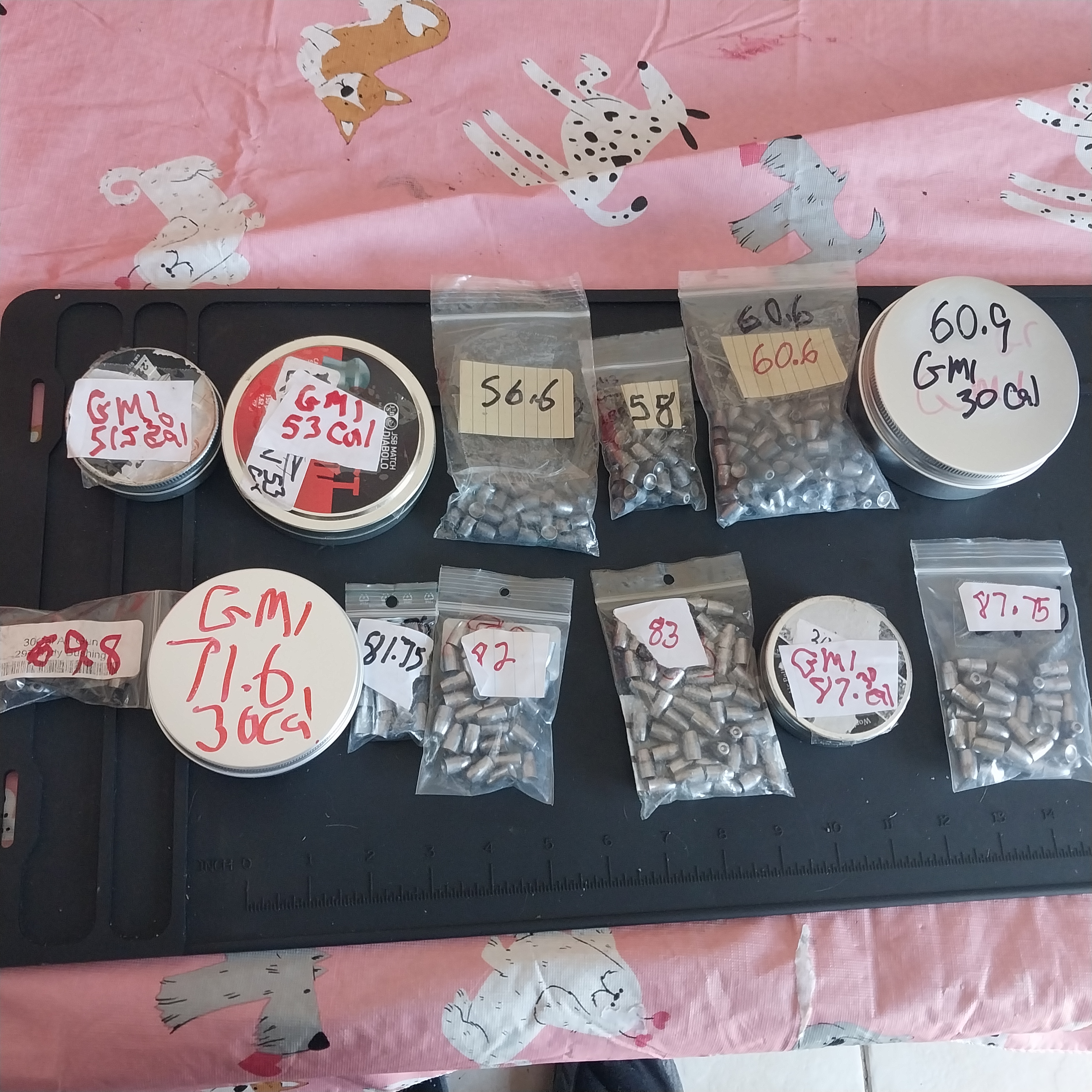

FINISHED OFF WITH JB POLISHING PASTE , NOW BARREL IS FLAWLESS , i THEN REBLUED MACHINING ENDS TO MACH BARREL AND REASSEMBLED , I THEN MAKE SLUGS 15 SIZES FROM 44 GRAINS TO 88 GRAINS , AND SHOT TODAY , THE GUN IS AMAZING THE SLUGS PREFORMED TOTALLY FLAWLESS WITH ANY SPEEDS NO JAMS NO MAG NOT CYCLING , i SHOT OVER 300 SLUGS TODAY , i NOW CAN POST PICTURES OF AMMO I MADE AND ALSO SOME GROUPS AND DATA ,

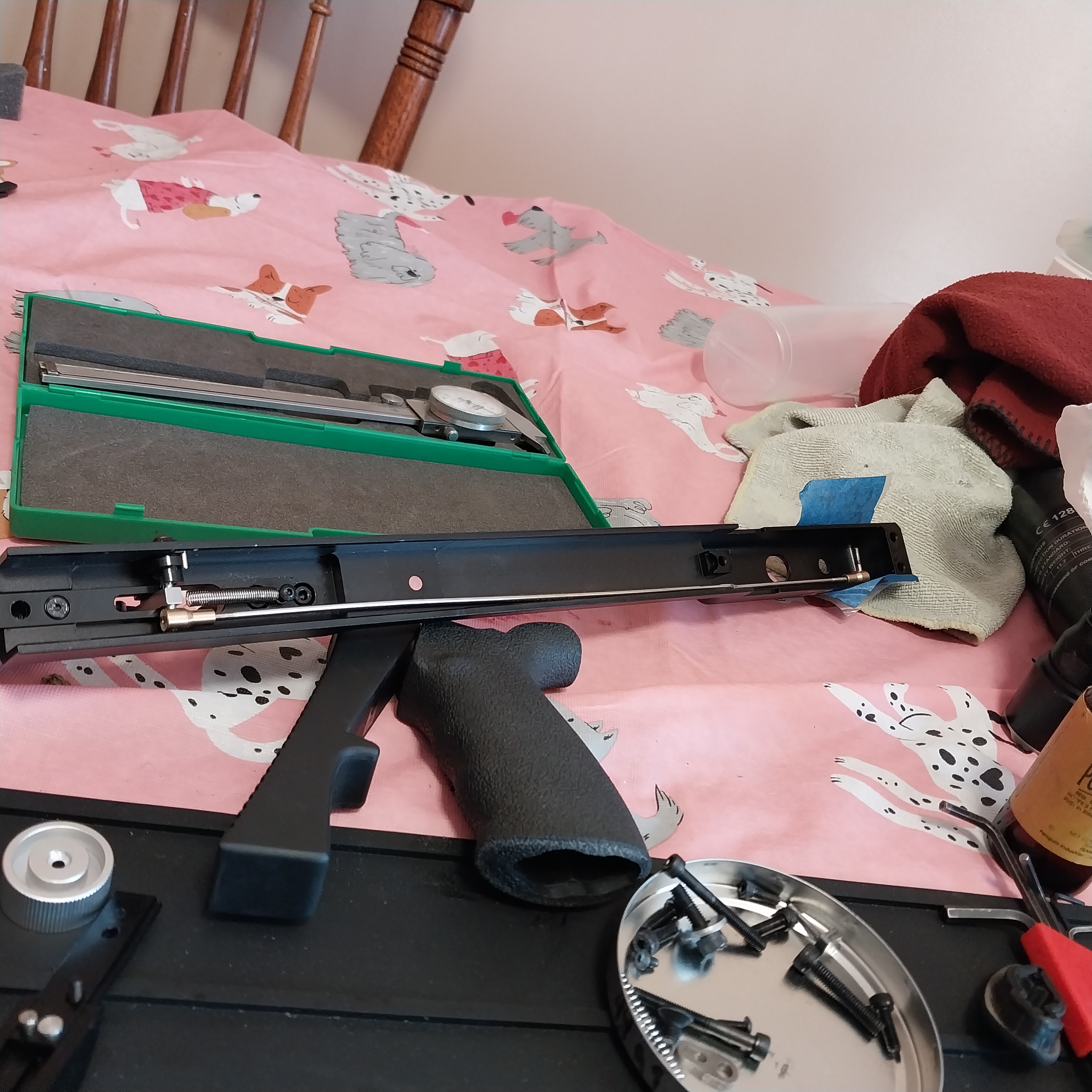

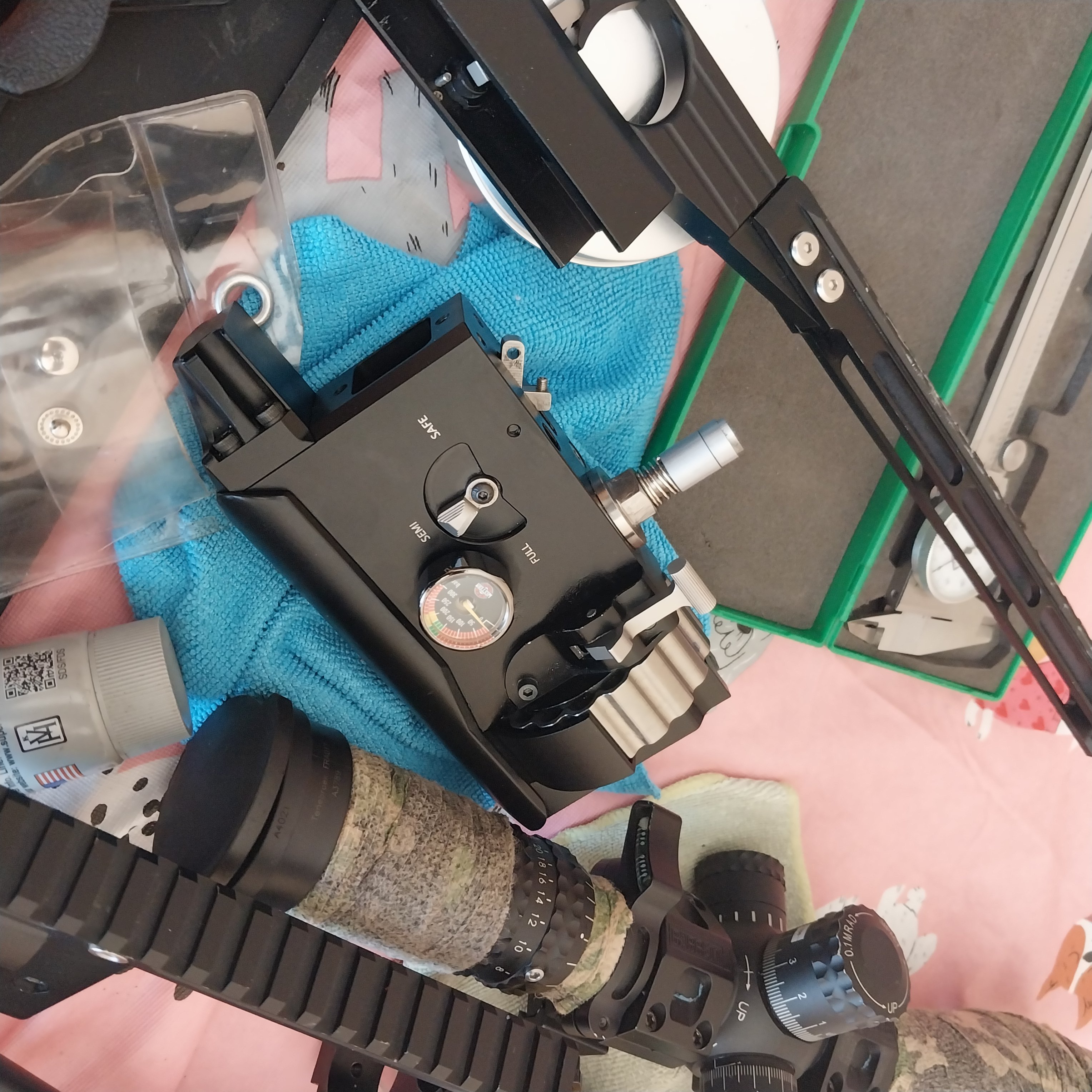

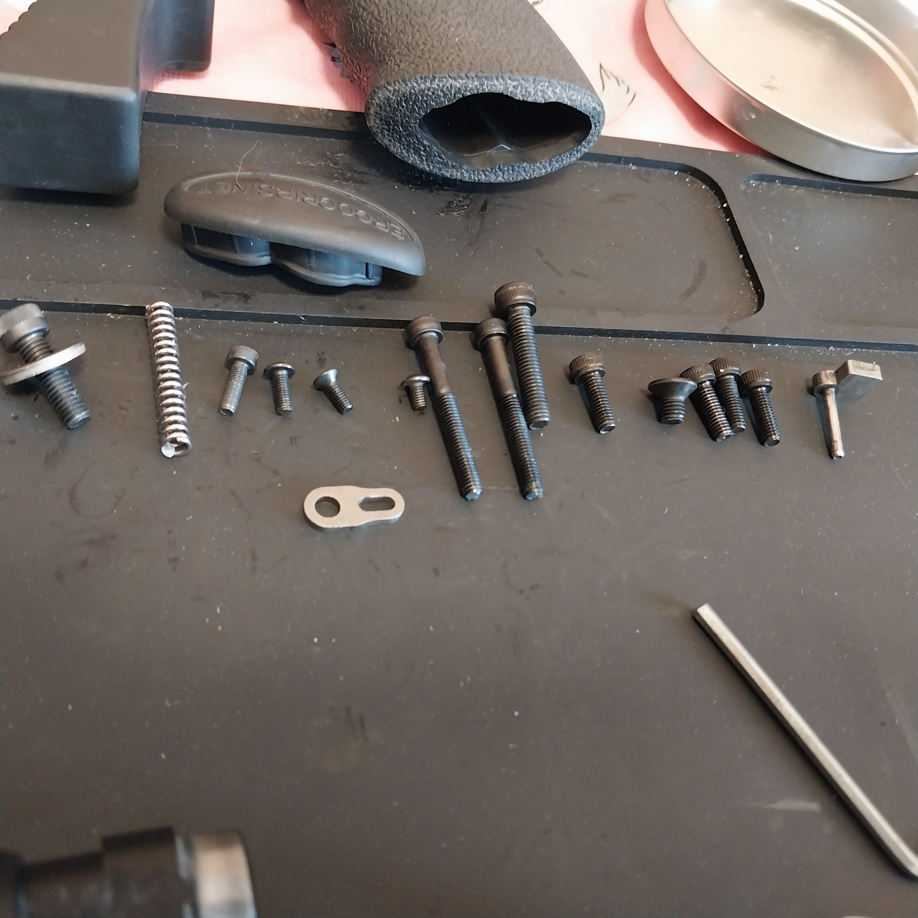

GUN APART

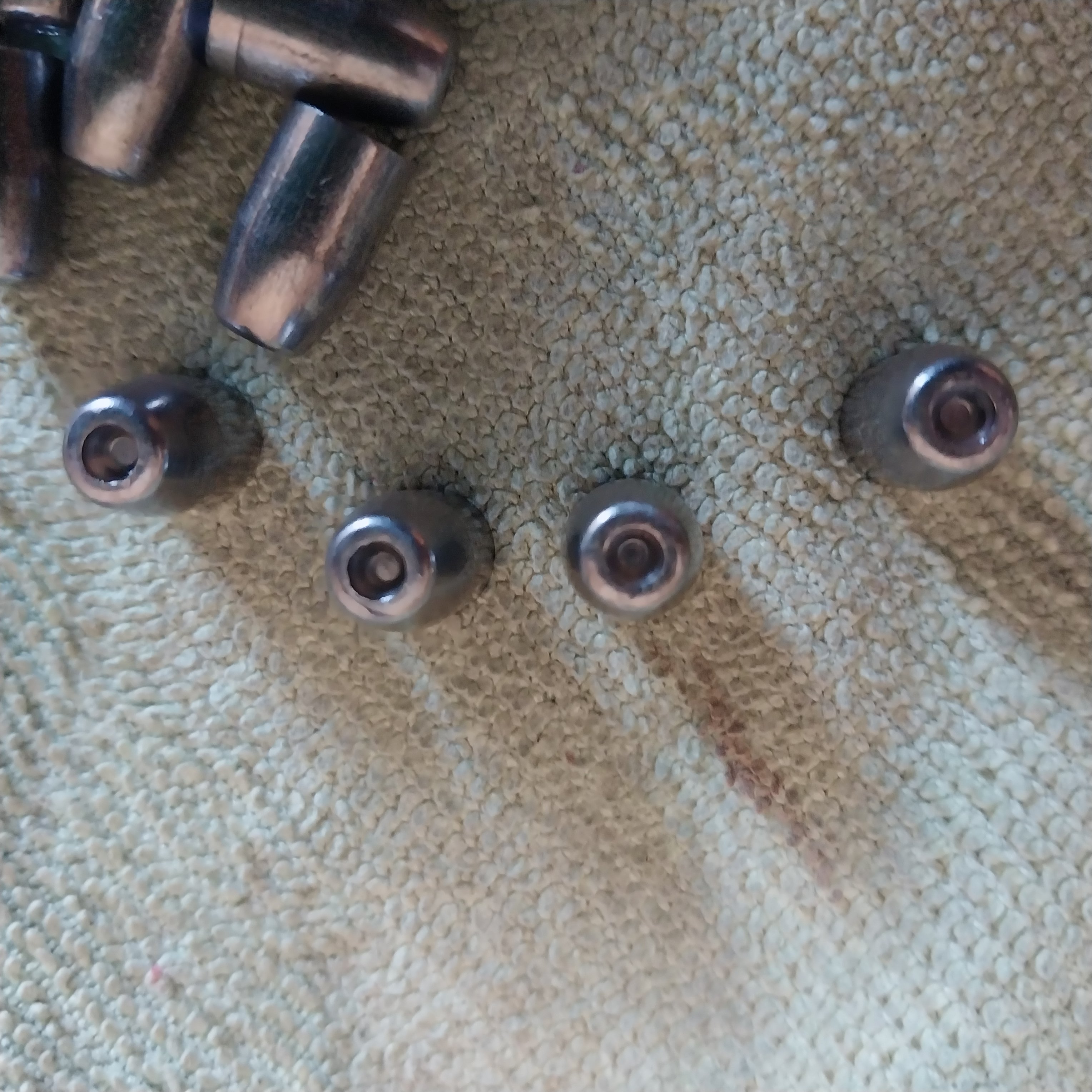

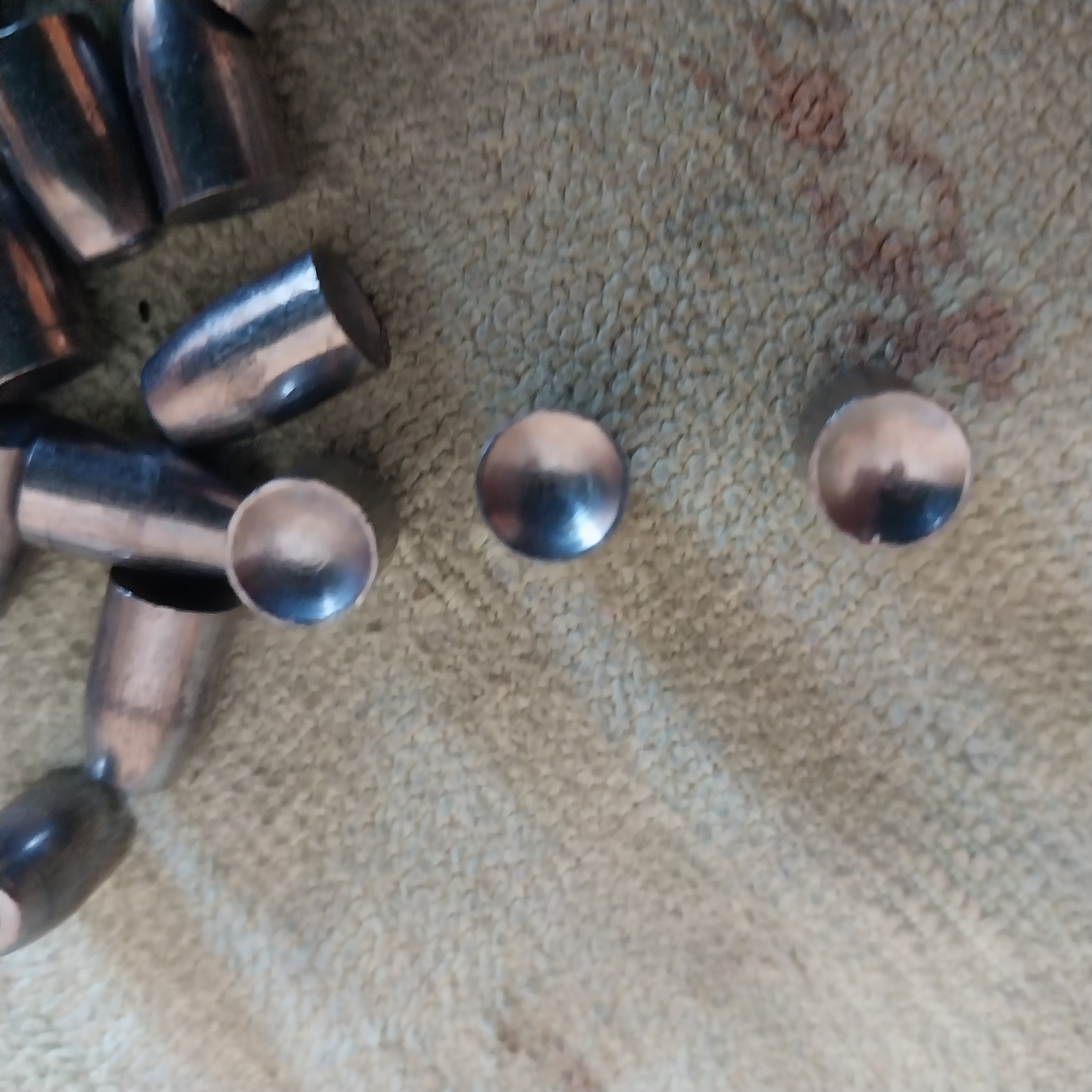

GMI SLUGS I MADE to tune and check accuracy and data

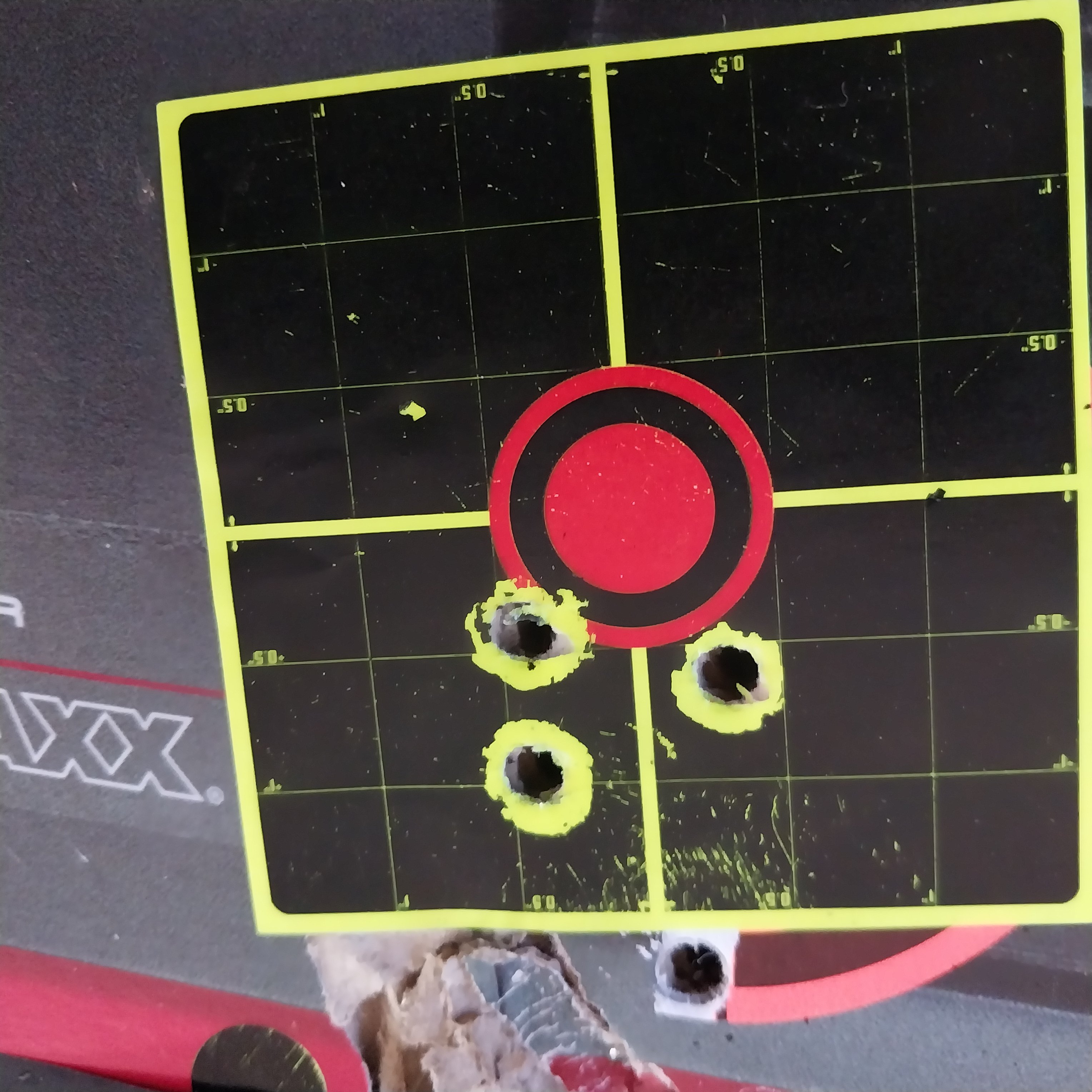

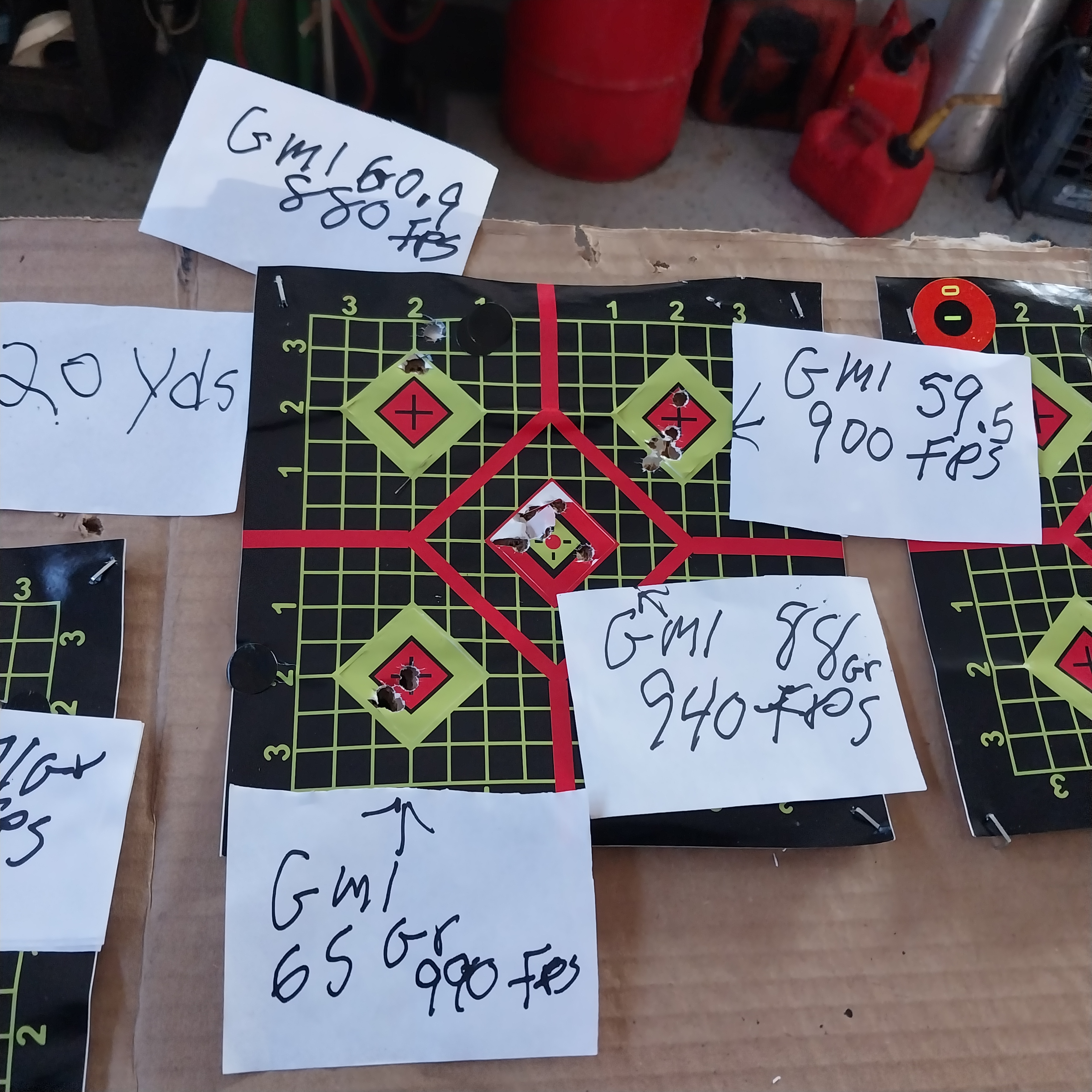

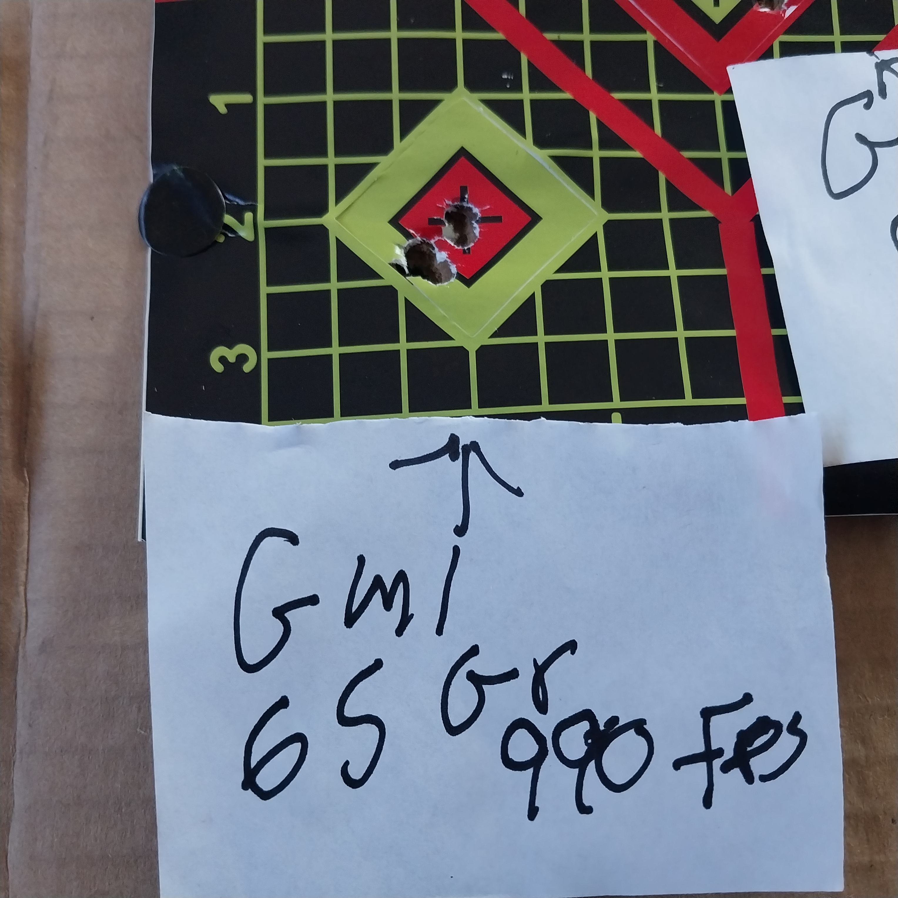

lastly here is groups after repairs and swaging GMI slugs , BTW these slugs best ammo I shot in my life , great performance accurate flawless and deadly expansion , they sure did their homework designing these slug tooling , thanks LOU

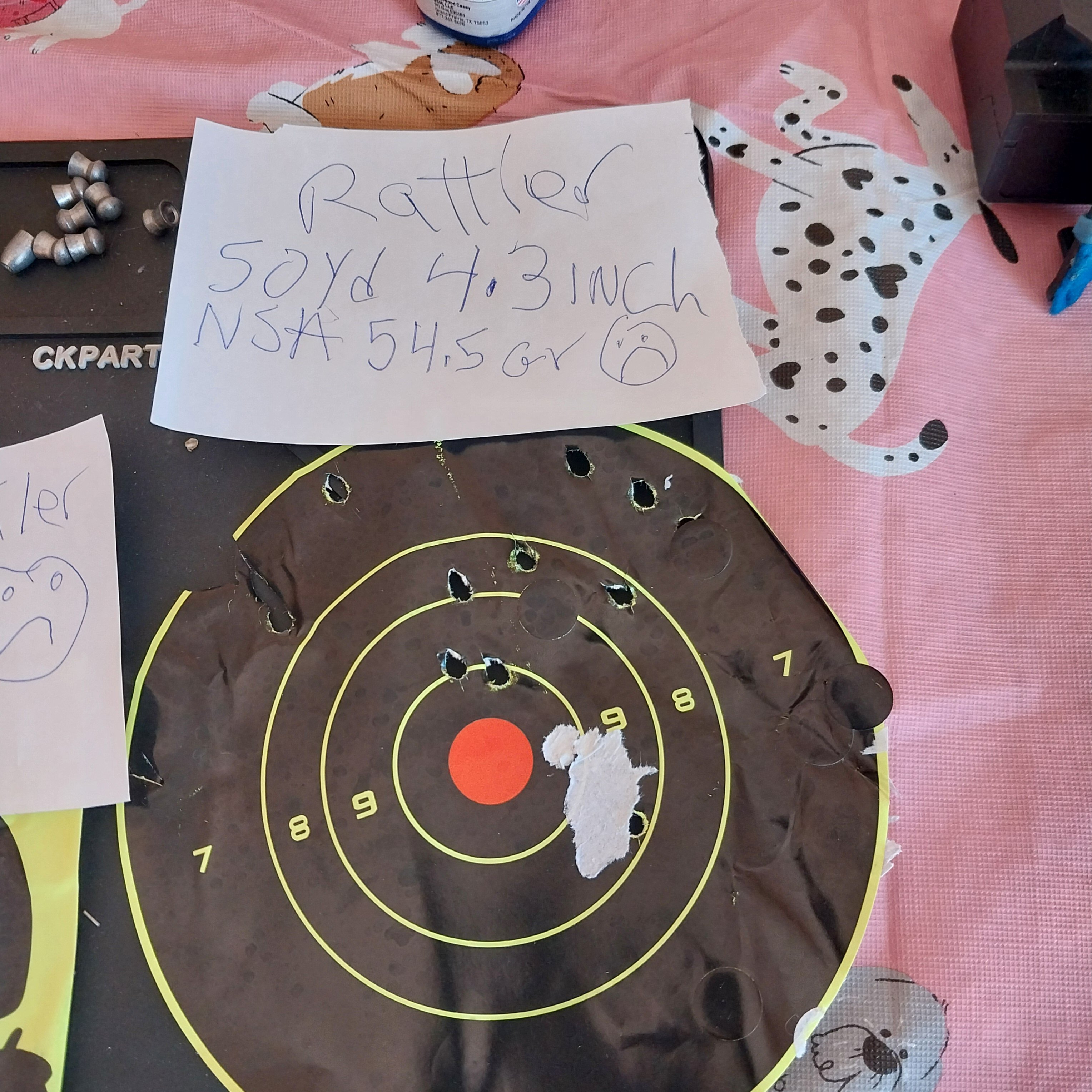

BEFORE WORK DONE
AFTER ALL WORK DONE GROUPS

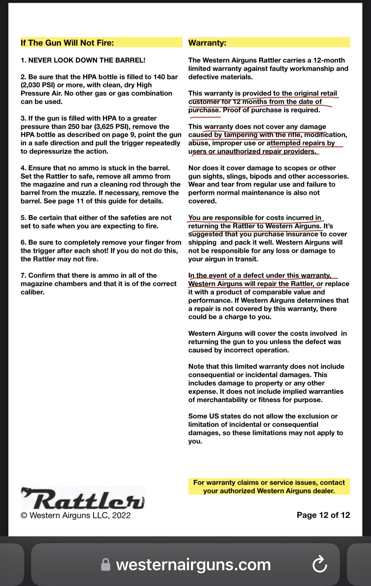

@MAUMAU Lou may have another perspective, but my take is this. The scary part is that it’s hard to attribute which issues that the soap encountered to the gun being used as opposed to issues that are the product of manufacturing or assembly. For a gun that costs this much (AOA sells these things new for around $2700, used around $2000), who wants to do this sort of work to an expensive gun? I’ve seen enough of them pass through the “used airguns” section on AOA’s site that I wonder, why does it appear that so many being re-sold?
Had the OP purchased his Rattler new, I think it’s safe to say that he would have shipped the gun at least once to the service center. If all issues were not ironed out, his gun may have been out of commission and traveling back and forth for months on his dime. This, in my opinion, is a worse situation to be in. It is probably the position that a significant percentage of Western Sidewinder/Rattler consumers may find themselves in because attempting to work on a new Sidewinder/Rattler voids the brief warranty period. Then couple that with mediocre customer service. The outcome can very realistically lead to disappointment for many disillusioned customers. One should not have to be an airgunsmith the enjoy an airgun, especially an expensive airgun.
Western Airguns Rattler warranty
source of warranty screenshot: https://westernairguns.com/uploads/1/4/4/1/144134631/rattler_instructions_web.pdf
I think buying new and encountering serious issues would be even more frustrating with this sort of warranty.

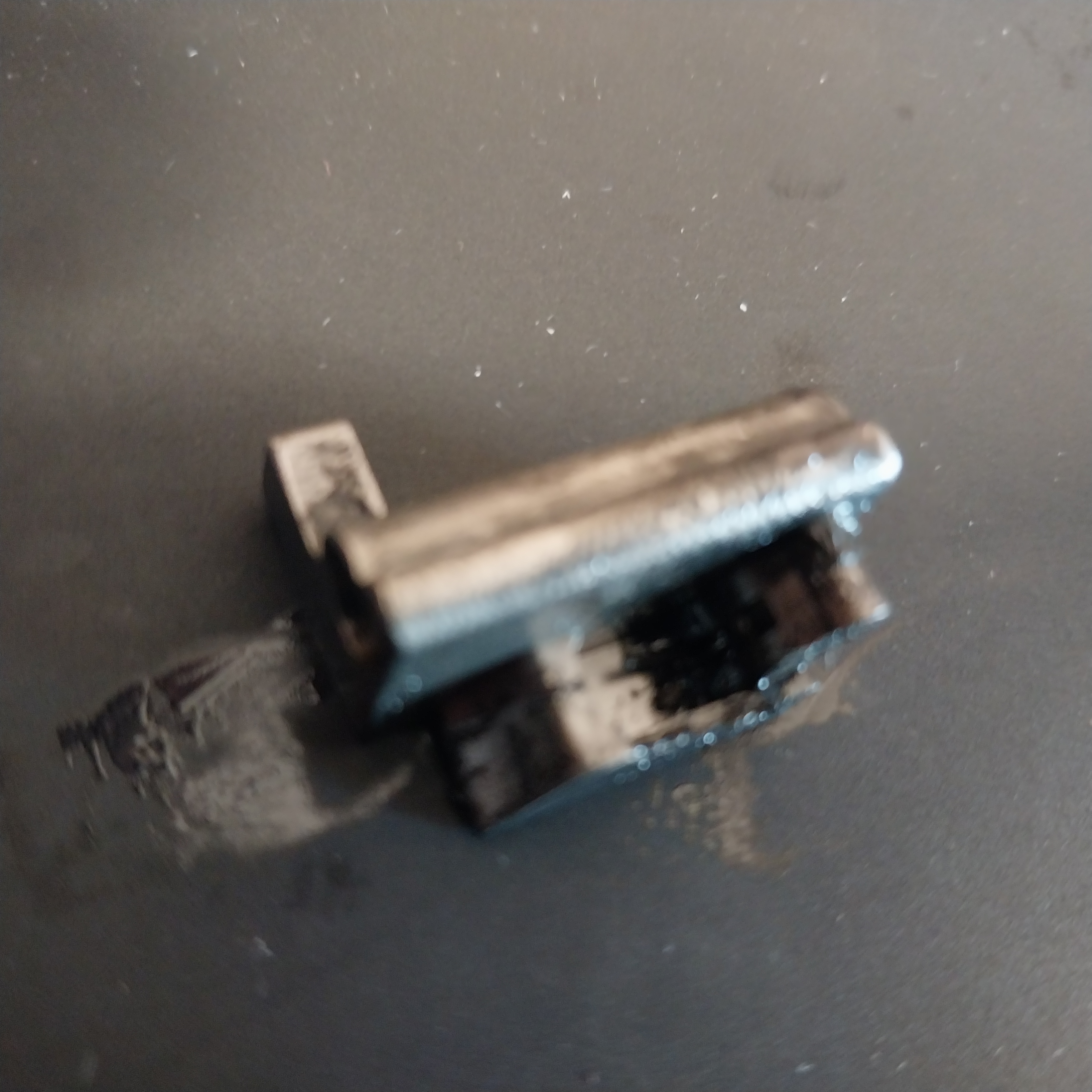

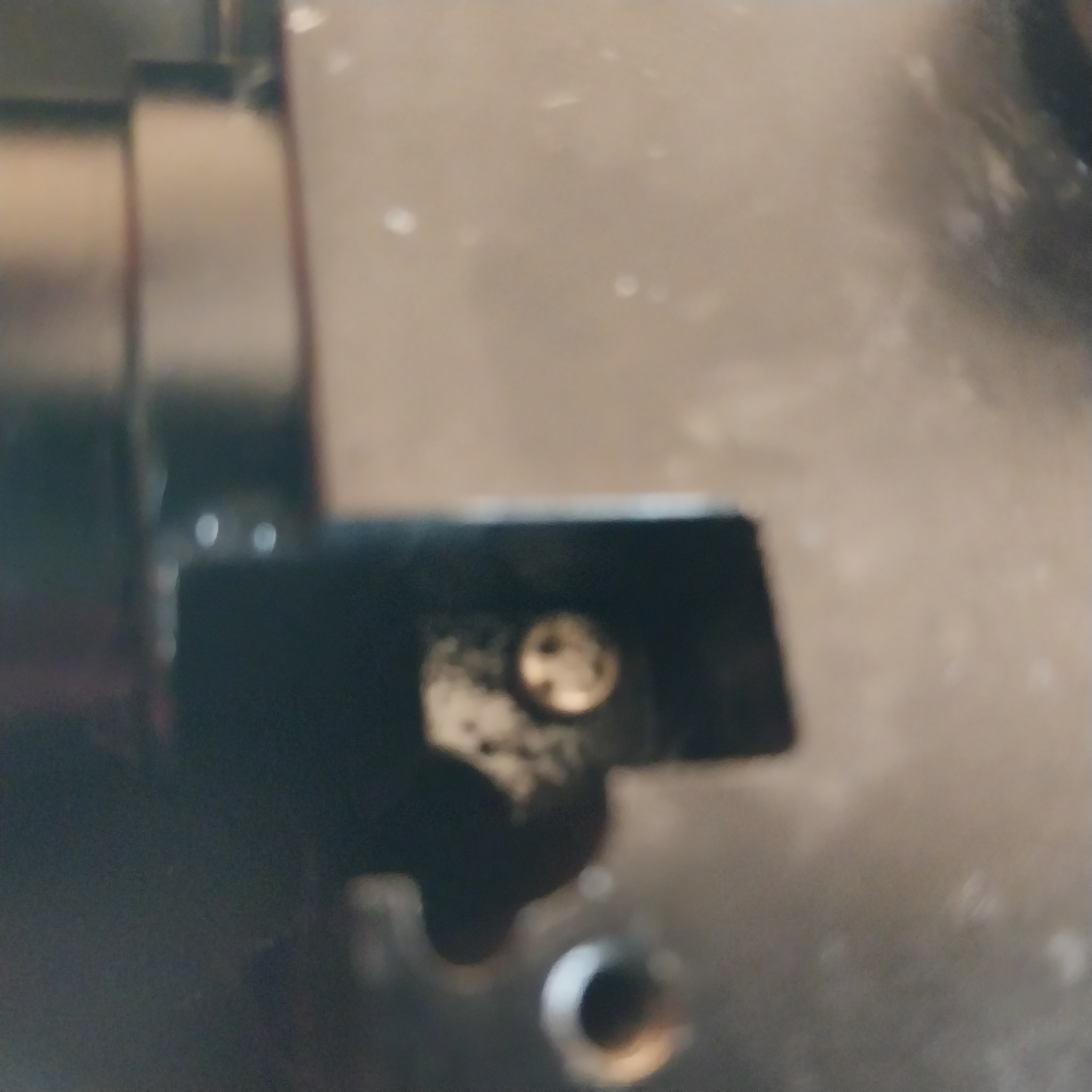

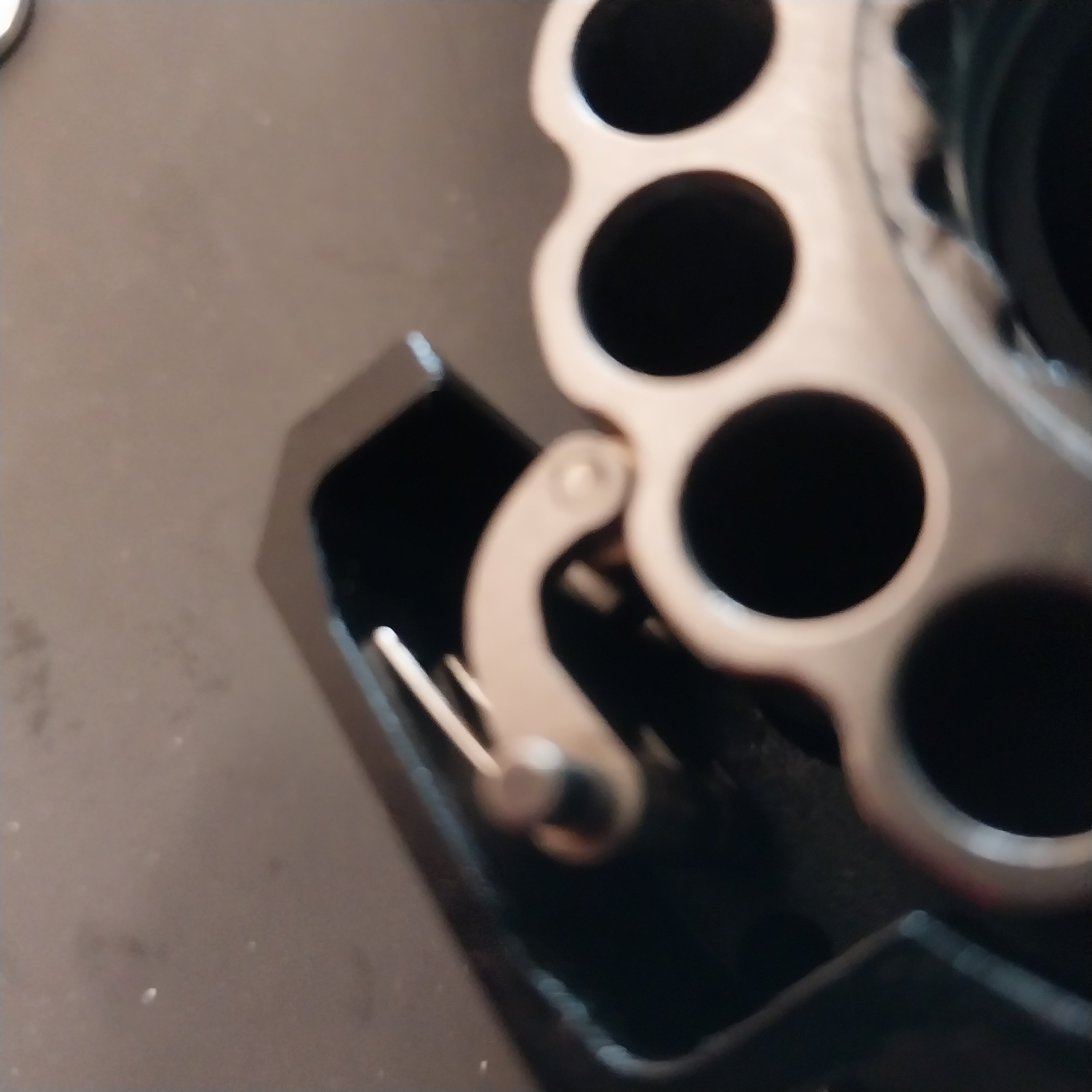

HI ken no it was not GMI slugs make NO changes it was gun , Please do not revise the 30 caliber It is by far best ever slug , this gun when I got it jammed even jsb pellets for any members reading or having jamming issues , the small square loading actuator was loaded with lead and the grease held debris this and also if you load a undersized projectile it will jam , they make this gun in 30 cal and 357 same applies to all ,
also western wont even answer customer I emailed them 3 times it was very frustrating , and btw the gun is so easy to service I hope for others with issues they post diagrams it is a $2800 gun , 90 percent of us do our own work and why would anything like cleaning out lead particles void a warranty this is totally absurd

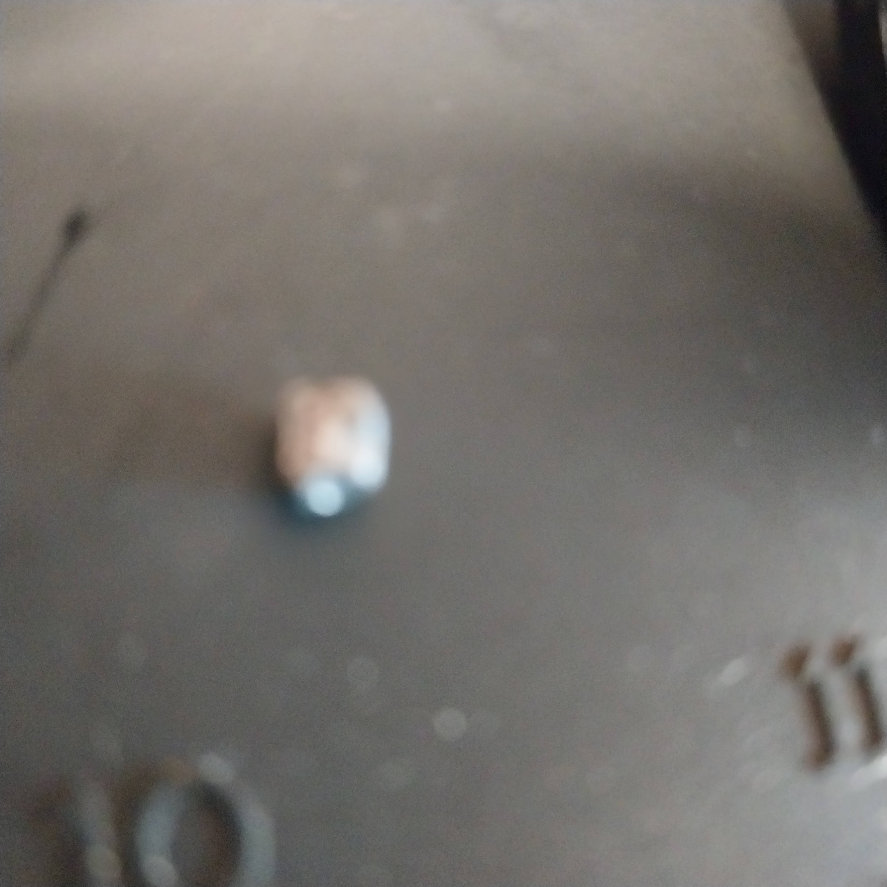

@jwrabbit123 Can we see close up photos of the GMI slugs that you swaged? If you can recover some from media like clay is wet newspaper I’m curious about how they expand. I don’t know if you shoot into various media to test expansion. Just thought I’d ask. And where did you find a 60 grain .30 pellet? Who makes those?
EXANA4CE HERE IS BEST PICTURES OF 88 GRAIN SLUGS I SHOT 2 YOTES WITH LAST NIGHT AT 345 AM , 1 @145 YARDS ONE AT 150 YARDS , PS EXIT HOLLE LIKE 1 INCH FROM EXPANSION PASS THREW @ 170FPE
