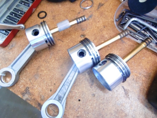

The Hen and the Tuxings have the same high pressure pistons.Dim. run 347th.-370th.length2.5"- 2 7/16" you should,nt have to bore it? listen when your all done turn it over with the fan and make sure nothings binding? if its going beyond TDC you have to raise
the base plate.
Well here is what I got measuring the Tuxing piston.
top end .383" or 9.75mm
shaft .361" or 9.19mm
seal .050 or 1.29mm
seal on piston with gap closed .39" or 9.9mm
How close I am I an not sure because of the tremors I have, but should be close.. But chinese manufacturing the tolerances can vary..

There is about .020 difference. I ,m going two different ways. When I get back home I,m making a new brass plston with ring lands
cut deeper to use Tuxing rings. I then will have too modify the rings to fit the groves. I,m also going to make some rings to fit the new
brass his piston. I really want to use the modified Tuxing rings. There cheap and can be bought a few places. I!m going to try both
by new week. Boring is a option also but being away from my compressor without looking at the sleave I do not know if there is
enough meat in the wall.
I will get back to you. FLy

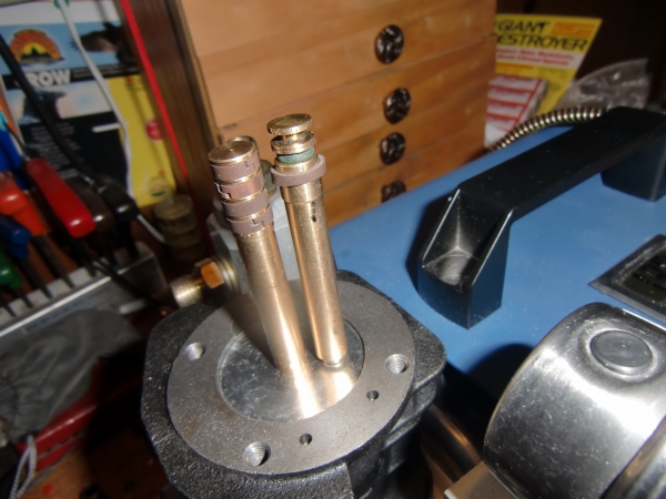

Fly may be correct, there may not be enough meat is the second stage sleeve to bore it out - I am going to explore simply making a whole new sleeve - I will also try turning down the hong-seng second stage piston and cutting the ring lands a bit deeper - I suppose it would not be too problematic shaving a bit of the plastic off the ring/seal gaps.

What I did was turn a Tuxing high pressure brass piston to the same dia as a Vevor & deepened the ring lands so the Tuxing rings fit & cut the ring ends
down so they will compress with out binding. Now you can buy Tuxing rings & just cut the ends of those rings down. I did this for a friend. It fits find but tomorrow
I need to check the clearance of the piston to the head, before I send it back to him.
Fly

I am also going to turn some PTFE replacement Vevor style piston ring/cups with solid walls and using a tapered cap screw to attach to see if I can increase the reliability of the stock piston.
