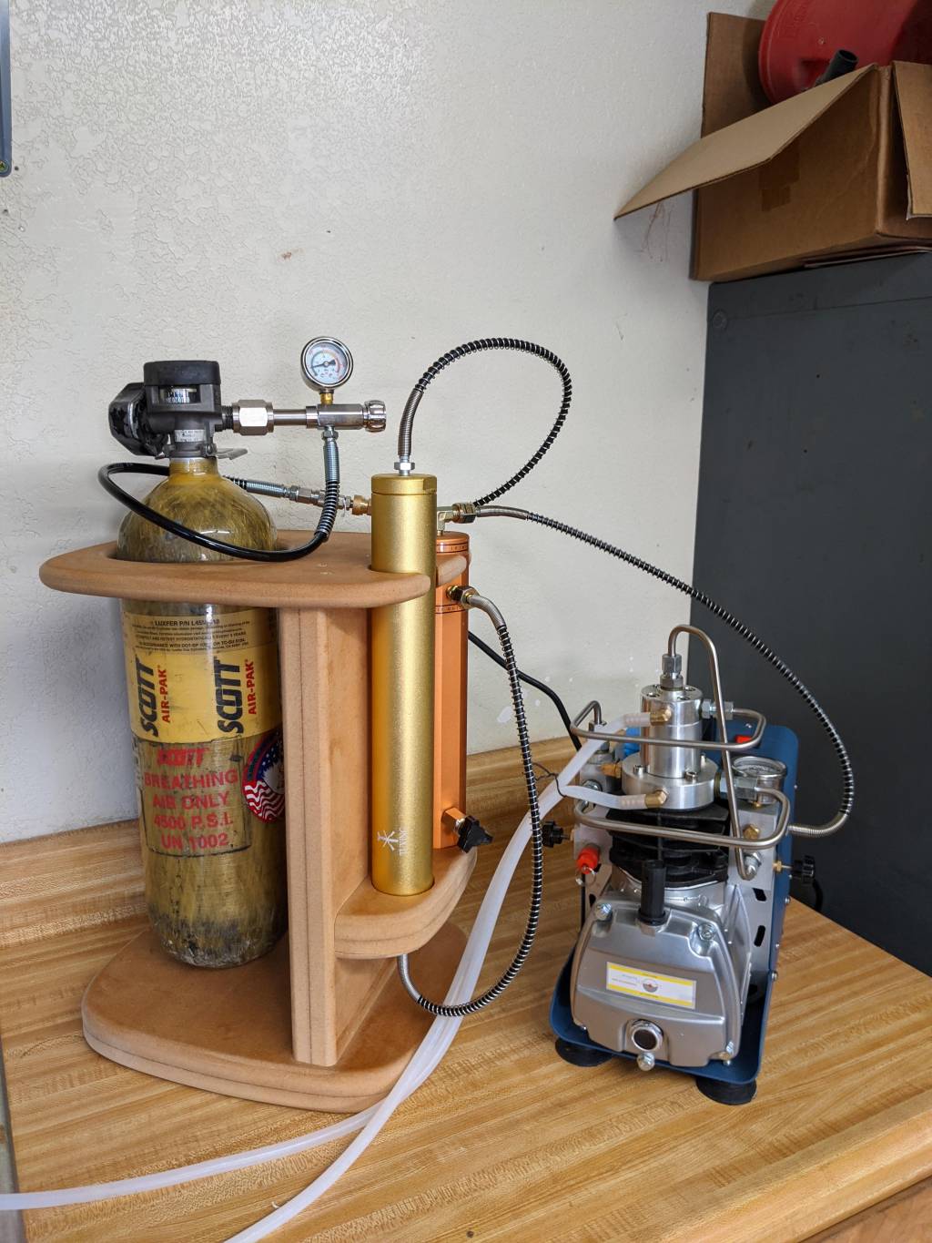

Here is my setup. I definitely wanted an oil water separator after I saw the standard Yong Heng inline filter after topping off a Daystate Huntsman. I found this one on eBay. I see they also make a double with oil water separator followed by a charcoal filter. If the charcoal can be swapped for molecular swivel, that might be the easiest and most compact solution. I had already ordered the Tuxing 3 stage gold filter so decided to build this rack and hold my SCBA bottle as well. It seems to catch a good amount of water even here in Arizona <20% humidity. Has anyone tested the air after a similar filter setup to know how well it works? I'm also curious if anyone has tested any of the $750-$1000 compressors? None of the manufacturers or resellers seem to say anything about filtration.

Wow! Very nice set up. In the process of building a new workbench just for this set up. Thanks for posting!!

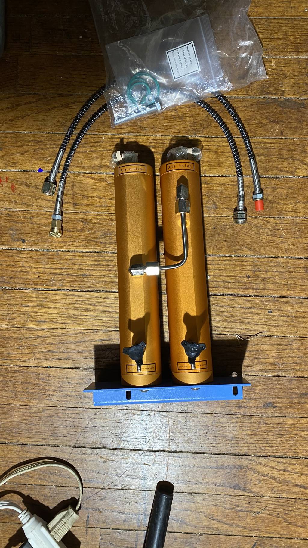

Thank you all for your input. Wish I could have found info on the water separator tower prior to my purchase.

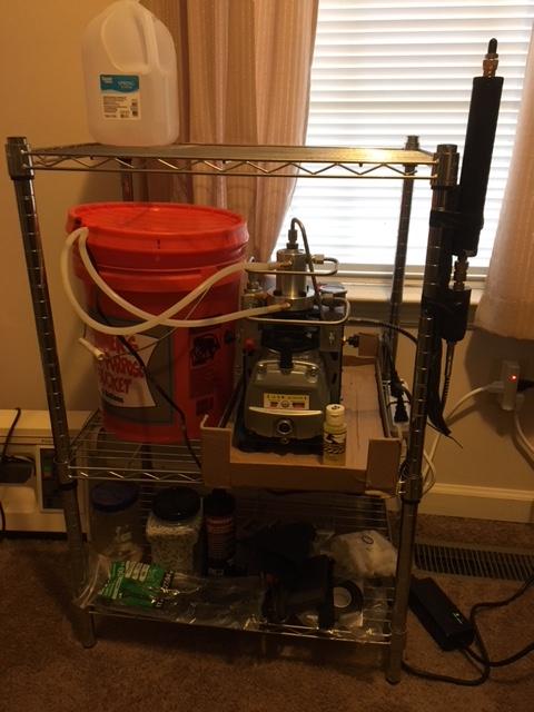

Not sure why I couldn't add text to the picture above. It's not perfect but it's working for me. The top shelf is where I set my tank or rifle when filling. The last black filter has a plug of cigarette filter at each end and a molecular sieve in between. Have never seen any water in my rifles or my tank. It's run indoors in a cooled or heated environment. Changes, since this picture was taken, are a plastic tote with a sealed lid for the water, and an additional fan that clamps on the shelf providing additional cooling air. Temps filling tanks never reaches 60c.
All: thanks for the complements on the setup. Woodworking is another of my many hobbies.
I built the setup to fill 30min SCBA bottles. There is a sink nearby that drains into my small citrus grove. I put the pump in the sink and let it run down the drain to water the trees. Pump stabilized about 60C. When I just fill one airgun, I can recirulate from a 1 quart container. I suggest this as a Yong Heng can be portable and direct fill without 5 gallons of icy water.
@Grandadmorgan - I saw that dual stage filter and really like the design. I believe the second stage is a charcoal filter which is intended to take taste and smell out of air for breathing. Is it possible to swap the cartridge or refill the cartridge with a molecular sieve? I would think that would be preferred for filtering any residual moisture.
I am in the process of setting up my newly acquired YH compressor and want to do it right the first time.I noticed that opinions differ in many aspects of maintenance and operation of these compressors.Apparently there are a number of ways to skin the cat. After sorting through a lot of good information on the forum here I decided to add the water separator in addition to the gold filter I already have.I particularly like jschwartlows setup.My question is with the purge valve on the water separator is it still necessary to periodically bleed the valves on the compressor when filling a tank?
