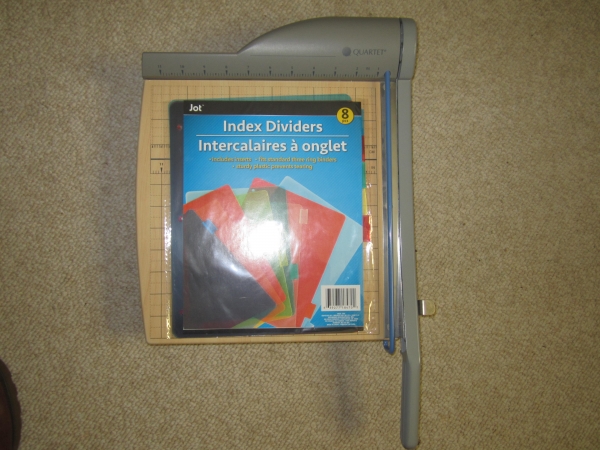

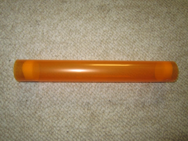

Here’s an easy fix. It only costs $1 for a package of 8 flexible plastic index dividers from Dollar Tree as pictured below. Each liner should last the filter’s lifetime. The flexible plastic index dividers are from their school supply section or obtainable from an office supply store. The only accessories needed are a 1″ or less round dowel rod and a straight edge paper cutter. If you don’t have a paper cutter, a T-Square or L-Square and a razor knife will suffice to square up the liner material. The liner is shaped by cutting the flexible plastic index dividers into a 10″ length and 8″ width and cutting off the divider tab. It needs to be rectangular 10″ x 8″ or less width so that when rolled on the dowel rod it is squared at each end. Place the rolled plasic liner into the filter housing, remove the dowel rod and it will expand itself and fit snugly to the inside wall. There is enough overlap that you get nearly two full layers of plastic lining inside the gold filter. Pull out the plastic tube to just beyond the filter housing threads and add 3/4″ cut lengths of the tampon that come with the gold filter as round end caps. One end is inserted to the bottom with the dowel rod and spaces the tube. Use the dowel rod to push it toward the bottom of the gold filter but not completely out of the partially pulled up tube liner. Pour in your 13X desiccant media, then insert the top end tampon section, then push the filled tubing down into the filter to the level of the threads. This way inserting the tampon caps is simple and won’t fray them from being squeezed over the plastic tube lining with the dowel. Air pressure expands the liner so tightly to the filter that it holds any moisture inside and is fully absorbed by the media. The tampon ends prevent any damp media from touching the threaded filter end caps. You now have a home made cartridge for your gold filter that fits it perfectly with no leaks, acid leeching, or air channeling concerns.
Yes. The interior unthreaded length inside the filter is 10 inches. If you fill desiccant to the level that leaves one tampon halfway beyond the threads then screw the endcap down it compresses the media between the two tampons. The liner expands to fit the wall diameter under its own tension. As soon as it is pressurized it is tight to the outer wall so no air can channel past since it is an exact fit.
