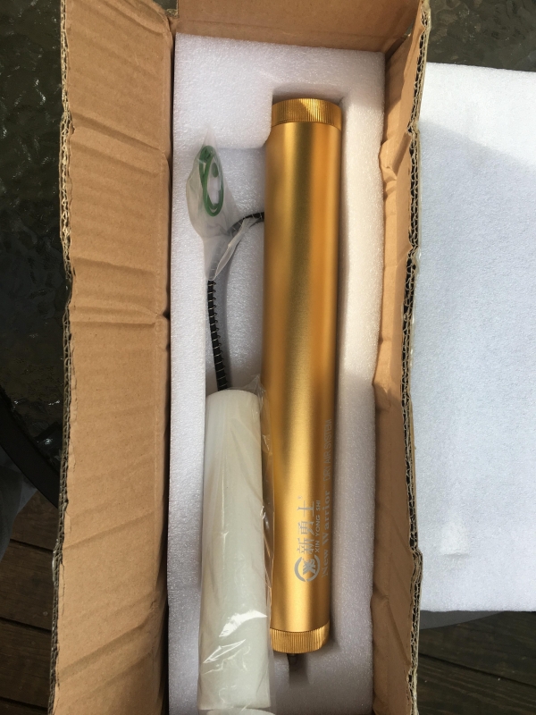

I purchased the gold filter with the activated charcoal, ,molecular sieve and desiccant inside rater than the cotton. It's not clear to me which end goes toward the compressor and which end goes toward the tank or gun. Also, is it better insert the black device that comes with the YONGHENG containing cotton between the compressor and gold filter or between the gold filter and the tank or gun?
2. Small filter that comes with YH goes between Compressor and Gold filter. It’s not necessary, but if used, I would use it as a pre-filter. Easy to change out the cotton every couple of tank top offs.

Eddy1840, connect your compressor's air output hose quick connect to the male foster on the input of your gold filter. The hose on the other side of the filter then connects to your tank or rifle. The gold filter just needs to be inline in your system between the air output of your compressor and your tank or rifle.

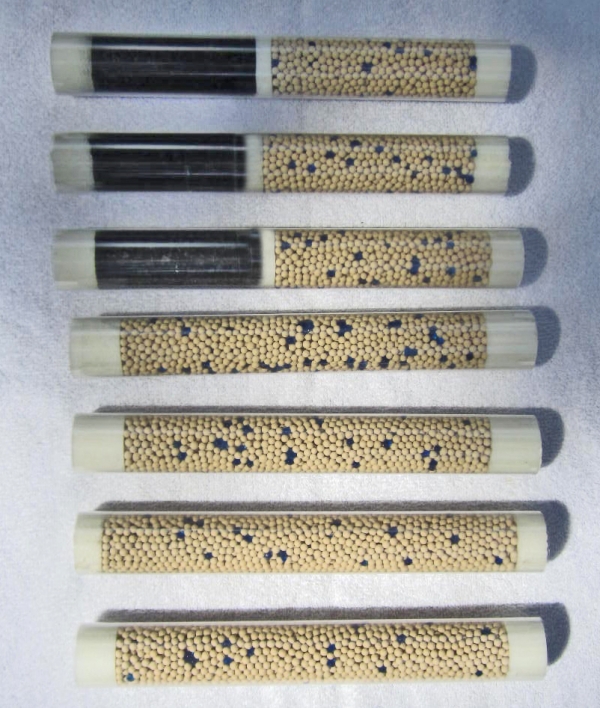

Thanks, Duster and Dennis for your kind words. I make desiccant only or desiccant and carbon filters that specifically fit Xin Yong Shi and Tuxing filters. Surprisingly, they have different internal diameters. Tuxing gold filters sell in two different end cap versions so vary in internal length as well. I make cartridges that fit each variation for a correct fit. Several are available on the classifieds for anyone interested. Here is a photo of some which are available. A Xin Yong Shi is 1 mm larger in internal diameter than a Tuxing so my filters are sized for each brand.
