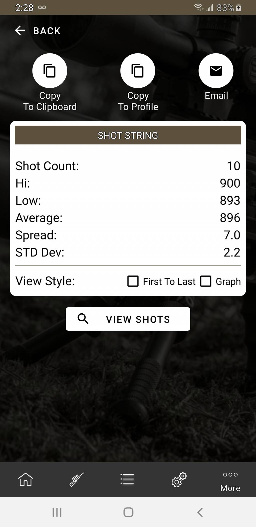

Better. Least i know my gun is fine now. This is actually with the power wheel on 1. I didnt have time to do a full run through...got to about 10 or so on the power wheel. Micro is 3.
While the numbers are good. Gun has a noticeable ping now. Snappy and still dead nuts but definitely louder.
I'm going to try to get rid of the ping with the quick adjuster and the valve, after i find the power curve. I believe it was starting to peak (920ish) round setting 10. I was in a hurry but i dont think there was that noticeable ping when i was further away from macro 1.
Crazy how going all the way down on the macro wheel increased fps.
Takes a bunch of ammo to do this. After you make a change seems to take a couple shots before you see true results. You dont really know till you do! ;)
Thanks everyone who gave any input. And dont stop. lol Any idea why i am getting a noticeable hammer sound? especially sense i decreased hammer?
What happens if close valve now? Does it affect the fps? Some ppl run it wide open?
I like to close the valve till it just starts affecting fps
Going to adjust valve tomorrow. I think my apex will be round 12 to 14 at my current reg. Whenever it is thats when ill start closing the valve lil by lil.
I really want it to be as quiet as it was before. When i first fired it i wasn't even sure it fired? lol
