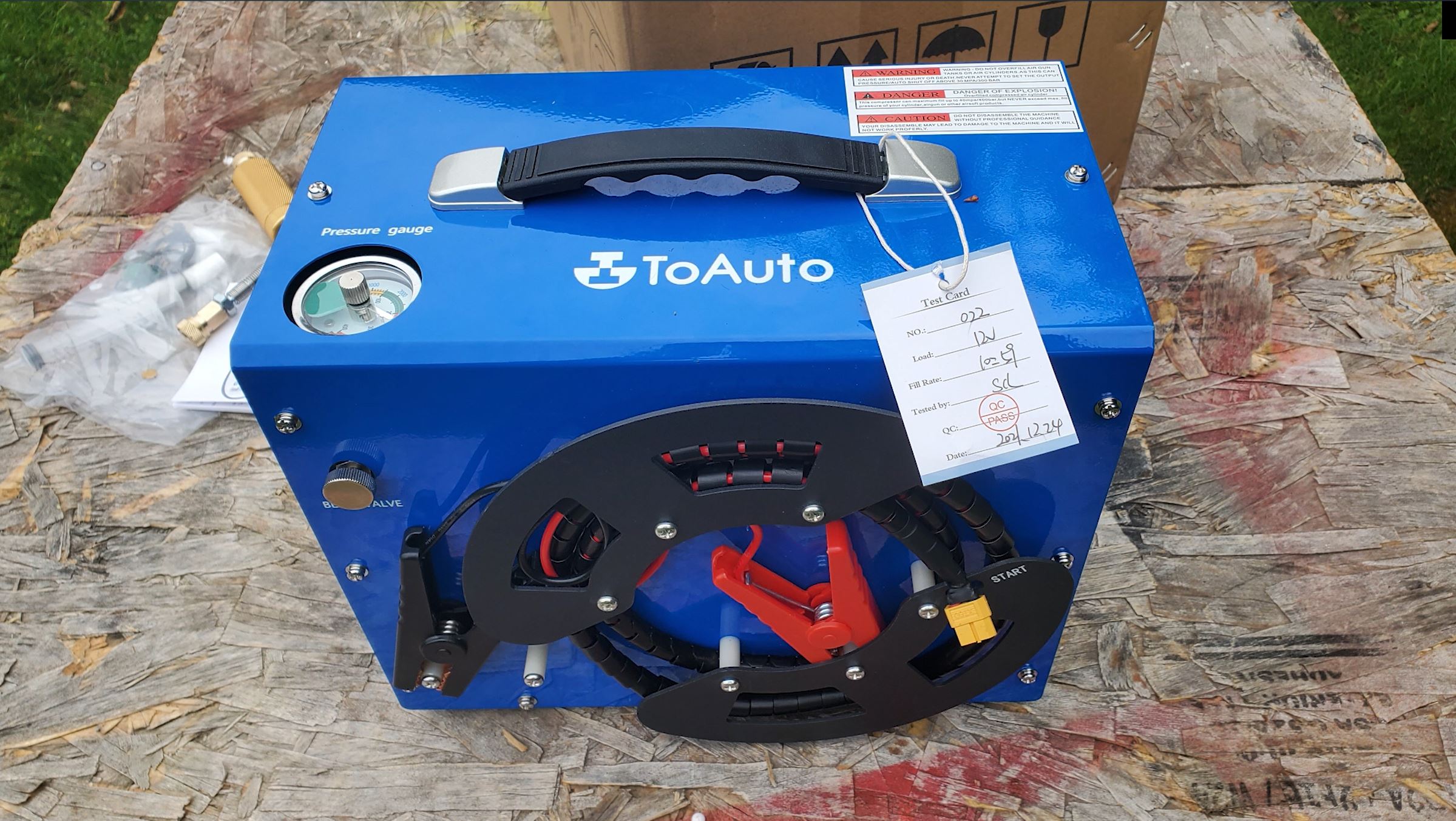

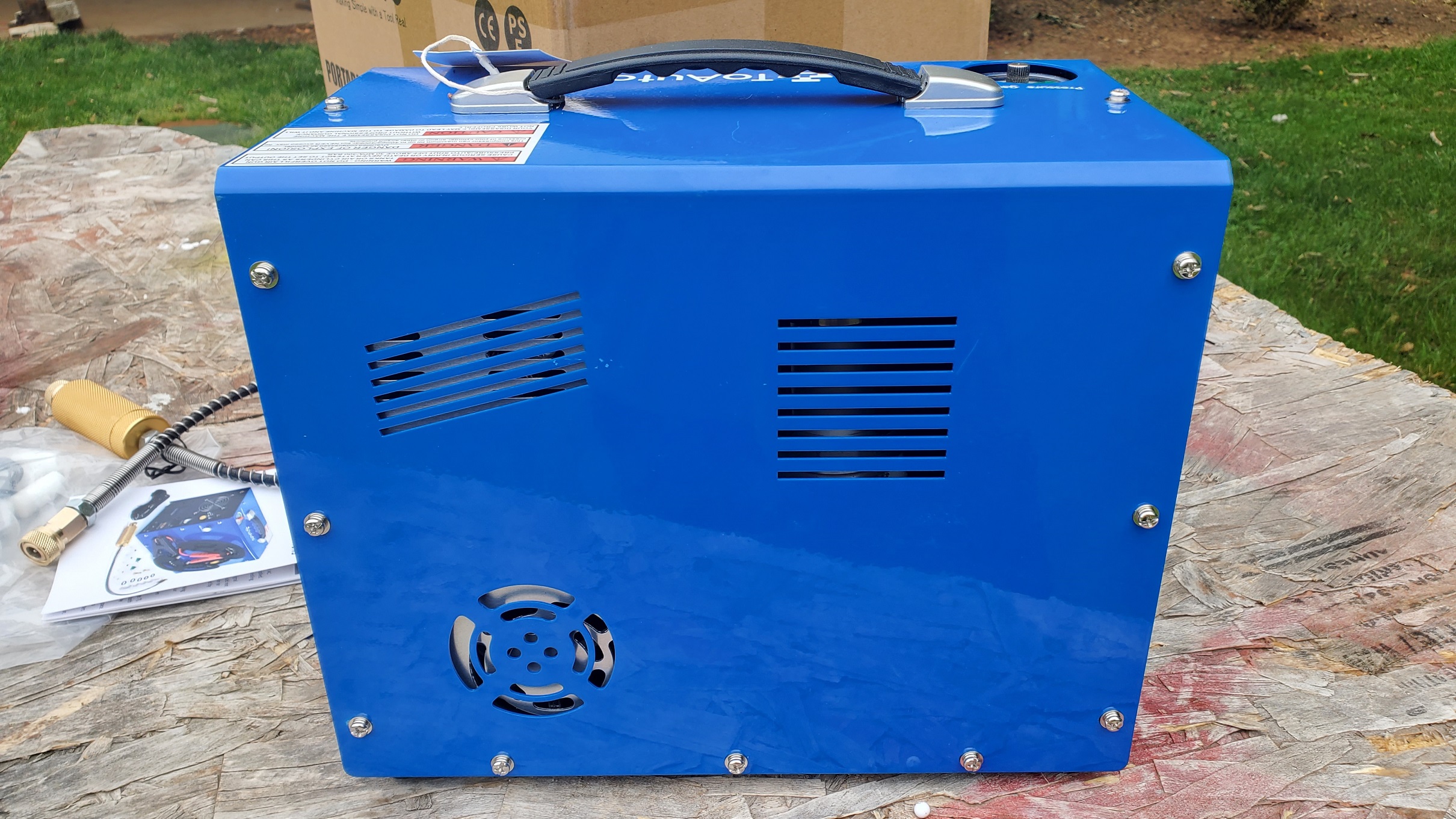

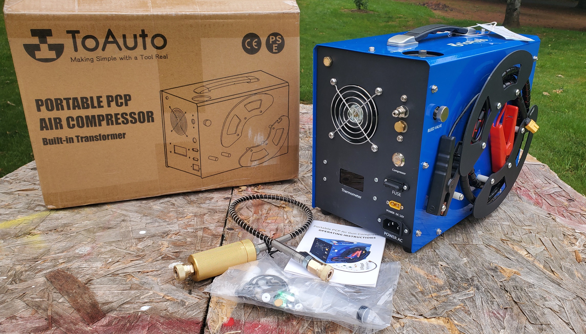

Hey guys. This seems like a really nice compressor. This is the ToAuto A3 but they also sell an A2 (smaller). This is half the price of the NOMAD and it's probably a better compressor. This is a quick look and test of this feature rich compressor. Great affordable PCP pump. Thanks for watching! -Nate

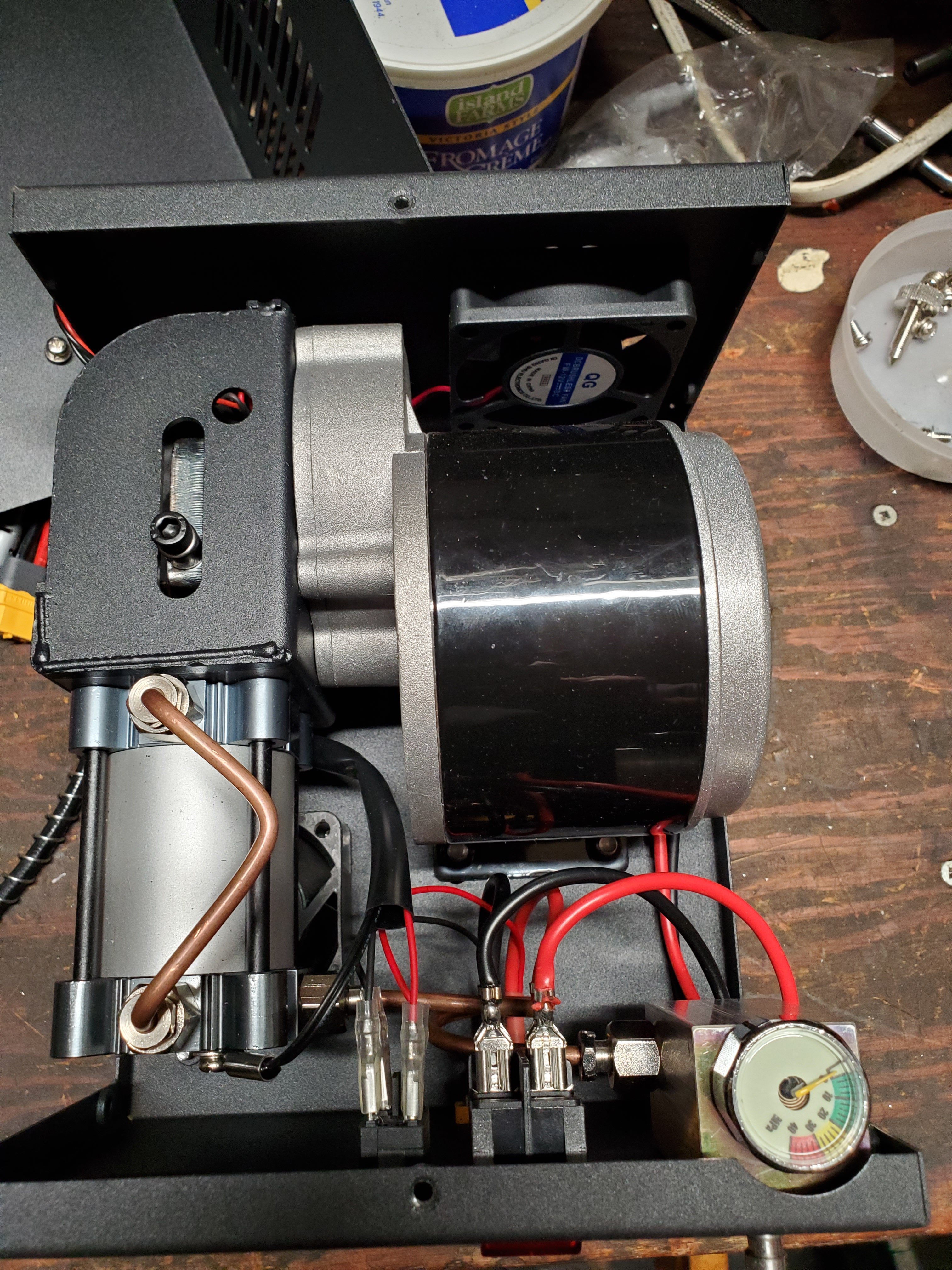

Bear with me as I'm new to the PCP world...

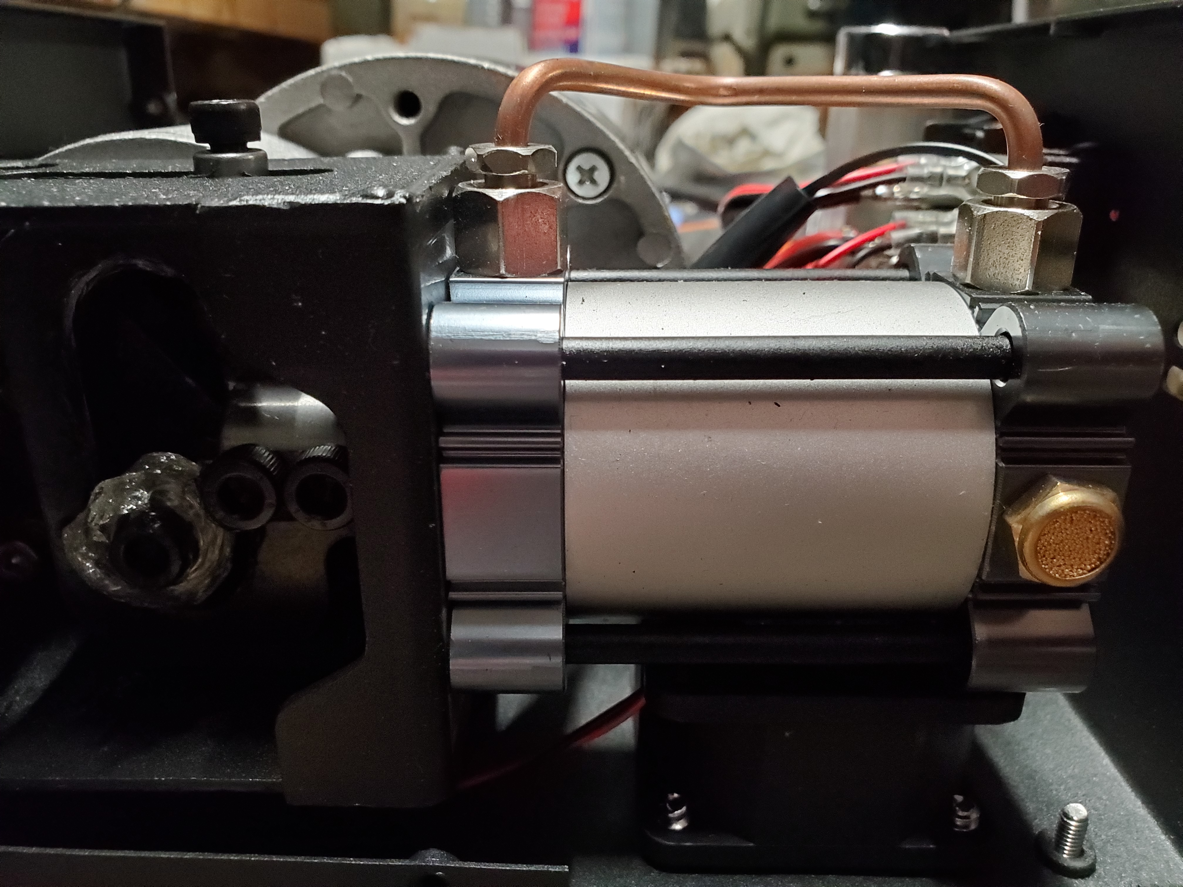

Question about the sintered brass plug in the upper left front. It was mentioned it was a "moisture catcher". First run of my new ToAuto A3 I noticed that plug bouncing around in the hole- it was connected to nothing.
Is it supposed to be some sort of intake filter or what? Since mine just sits loosely in a hole in the case it does nothing since air is sucked in all over the case bypassing any filtering it would otherwise do.
Is it normal to filter incoming room air to the compressor? Seems like that would be a good idea but I see nothing doing such.
Thanks in advance for any info.!
UPDATE- Had a lot of issues with trying to communicate with the ToAuto contact. Obviously English is not their first language. After mutiple exchanges I finally got the person, Tim, to understand what I was asking about.
I am now told that the sintered brass/bronze plug on the front panel supplies filtered air directly to the cylinder of the compressor.
HOWEVER on my unit it is connected to nothing, and in fact fell out of the hole in the front panel upon first use. Tim was informed of this several times. He just didn't seem to get it.
His latest message to me was as follows>
"This is indeed the air intake of the machine, which is connected to the cylinder of the machine. It cannot be directly opened, otherwise the dust will enter the compressor. If you look closely, you will find that the surface is granular, which has a preliminary filtering effect on the gas. Any problems, please feel free to contact me. Tim"
I suppose I am therefore returning this to Amazon as defective. Whether they are all this way I do not know.

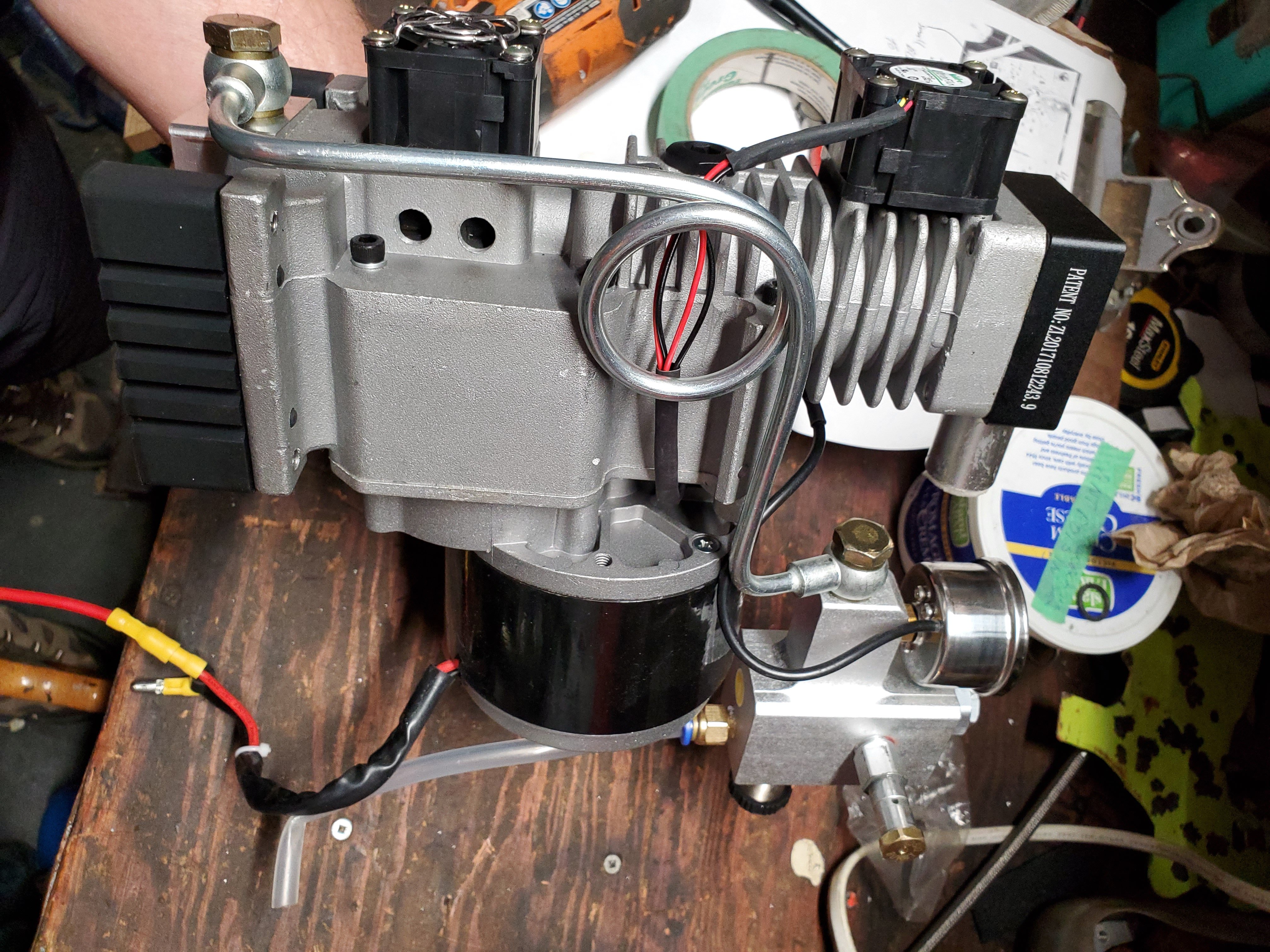

The compressor in the video sort of looks like a cross between an Benjamin Recharge and an Omega Trail Charger knockoff at first glance. For questions about filtering intake air on HPA compressors, particularly entry level compressors, check out the article linked at the end of this post. I believe the primary purpose of filtering intake air is to remove moisture from the ambient air. I think some moisture will still accumulate via condensation from the process of compressing air to the high levels that we use for PCPs. Pre-filtering can be particularly useful for those of us who live in humid regions to protect our airguns from rust and/or corrosion of internal parts when our compressors don’t have great filtration systems (think of the cotton tampon type of filter).
