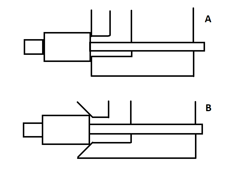

1. Throat diameter, proppet diameter (I learnt that proppet should be 2mm larger than throat in diameter, I use peek).
2. Valve steam diameter 2 or 2.5 or 3mm for better efficiency?
3. Hammer weight and travel? I have my impact M3 hammer at 24gram, 20-22mm travel, huma spring and had great success with 960fps 27gr out of 600mm barrel but since M3 valve is some sort of balance valve, I don't know if that hammer weight could be applicable for a traditional design. Have around 58 shots, 230bar fill out of 500cc tank at 135bar reg pressure of my M3.
4. Does valve seat shape in figure A & B play a role in efficiency or open force, hence lighter or heavier hammer weight?
5. What's better, a heavier hammer or heavier spring?
