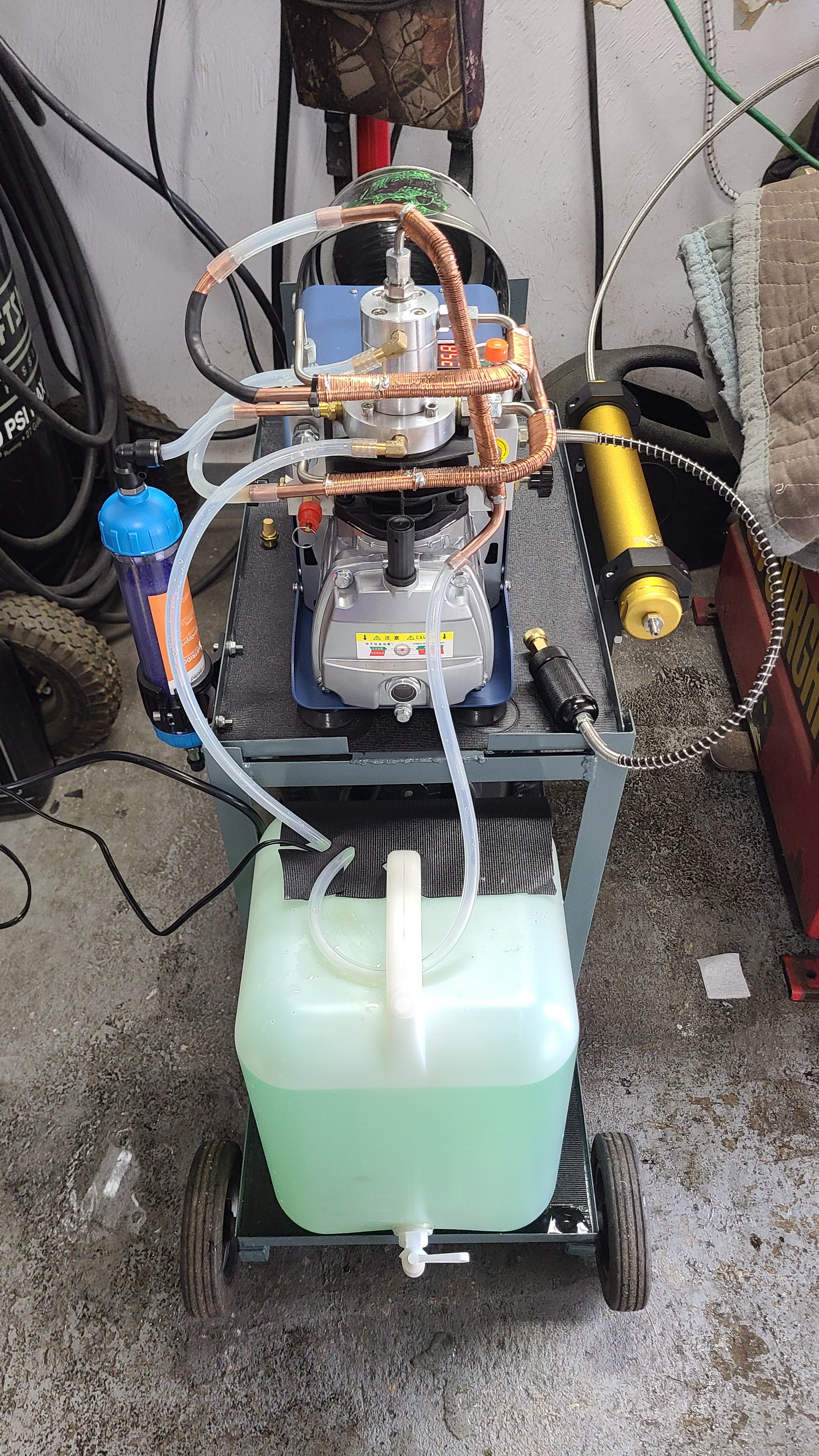

My Yong Heng is at about 3.5 years old and still going strong. I use it to fill a 45 minute SCBA tank once or twice a month. I have used Nuvair lubricant since day one and I also added a small computer radiator with fans fairly early. I can fill my tank from ~3200 to an indicated 300 bar (really a bit less when it cools) in about 20 minutes without going over 62 C. If I use ice in the summer I can stay under 60 C. I had to replace one O-ring once. I've proven I can run it and it's extras off a big Milwaukee power supply so I guess I could transport it to a range and use it there but I probably never will. Maybe if I get it more self contained like the one at Target Forge. Basically it sits in my utility room all set up and ready until I want to fill the tank. It could also fill a gun directly of course but I do not.
Drawbacks are it is noisy and needs some space for the compressor and it's coolant tanks and in my case fans to help it stay cool. It also needs an extra moisture filter in my opinion. None of the extras adds much cost but you need to budget $100-200 for extras in my opinion. I don't have a GX-CS4 but I think it is quieter and much more easily portable and also more self contained. The downside is it isn't nearly as powerful so it will not fill anything as quickly as a Yong Heng. Plus we do not really have years of experience on it's longevity.

I just got into the pcp world not long ago and buying my 1st compressor to fill the gun and also a 2L tank for.out in the field
I ended up with a Yong heng
Ran it and it did good just heats up
So I went a step.further and added some cooling to it and it works very well
I only run it for 1/2 hr at a time
