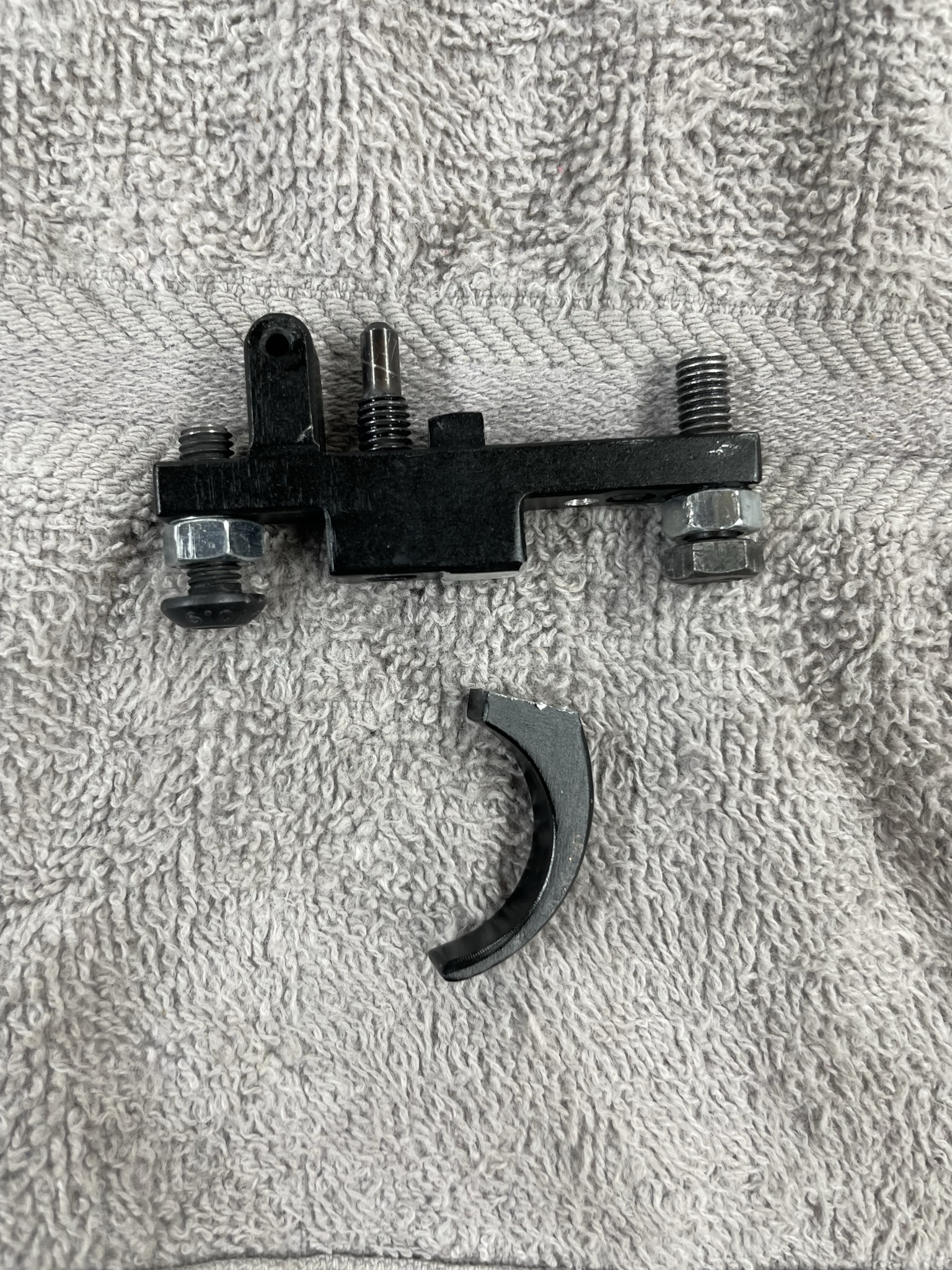

My .22 Avenger is an extremely accurate rifle, way beyond its price point suggests. The stock trigger leaves a lot to be desired though. I’ve already modded it by changing both springs to lighter ones and polished all of the engagement surfaces. One thing that has always bugged me was the shape of the semi circular trigger shoe so today I got my hacksaw out and got busy.

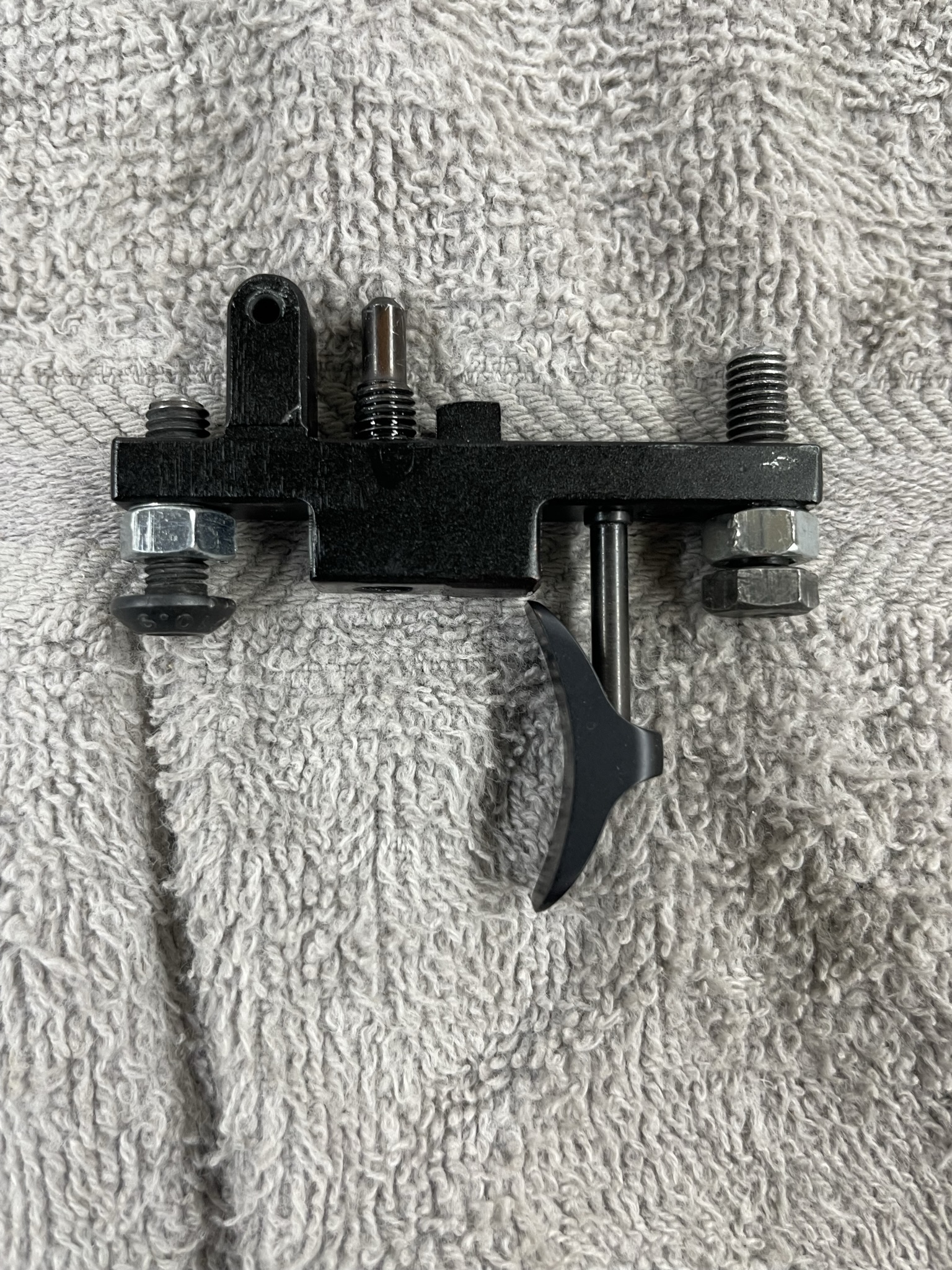

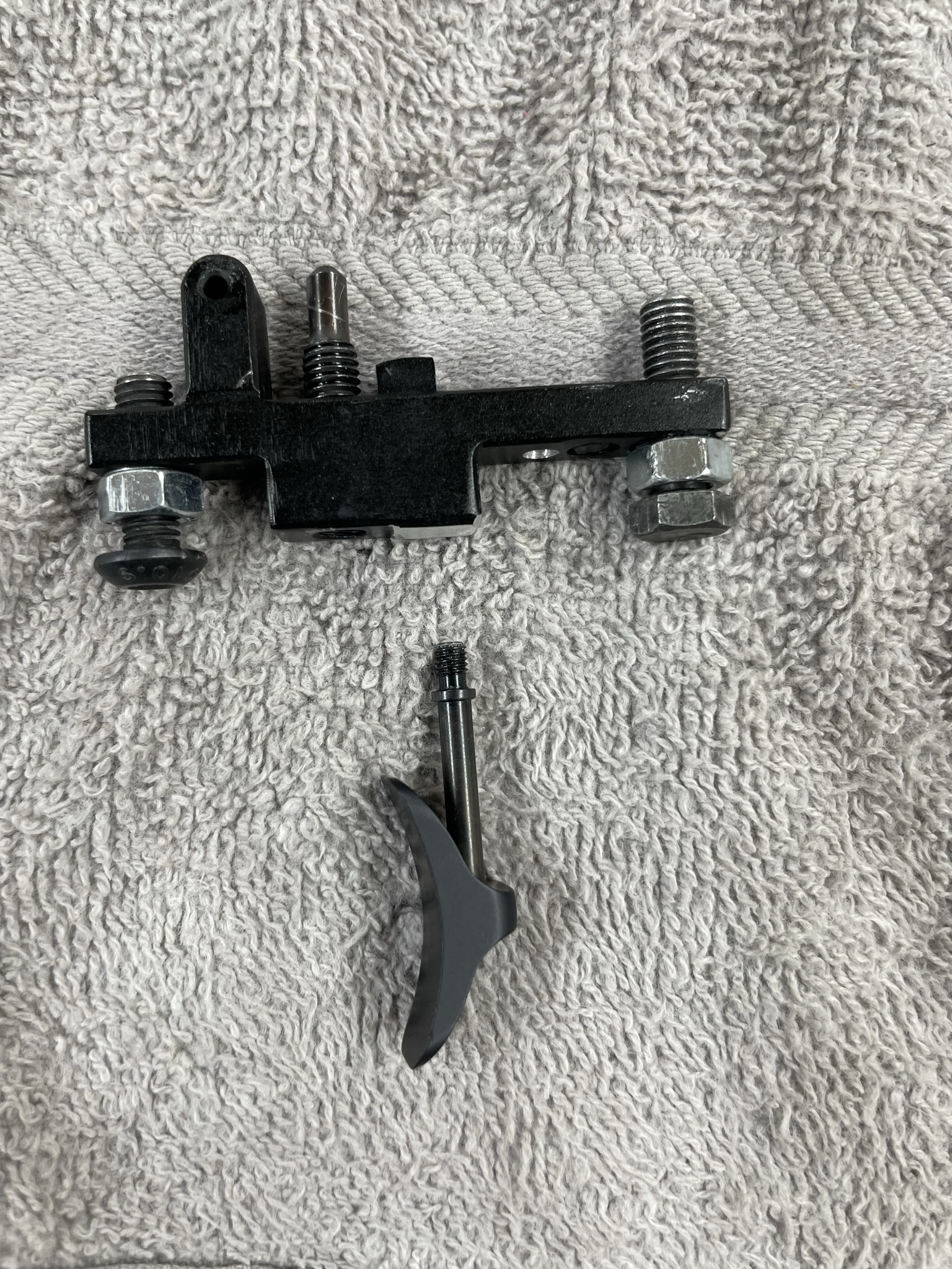

Next I drilled and tapped a hole behind the old trigger. This provided a slight lever advantage by moving the leverage closer to the sear which improved the feel of the pull. Then I treaded a FX Trigger bar post into the hole and mounted a FX trigger shoe.

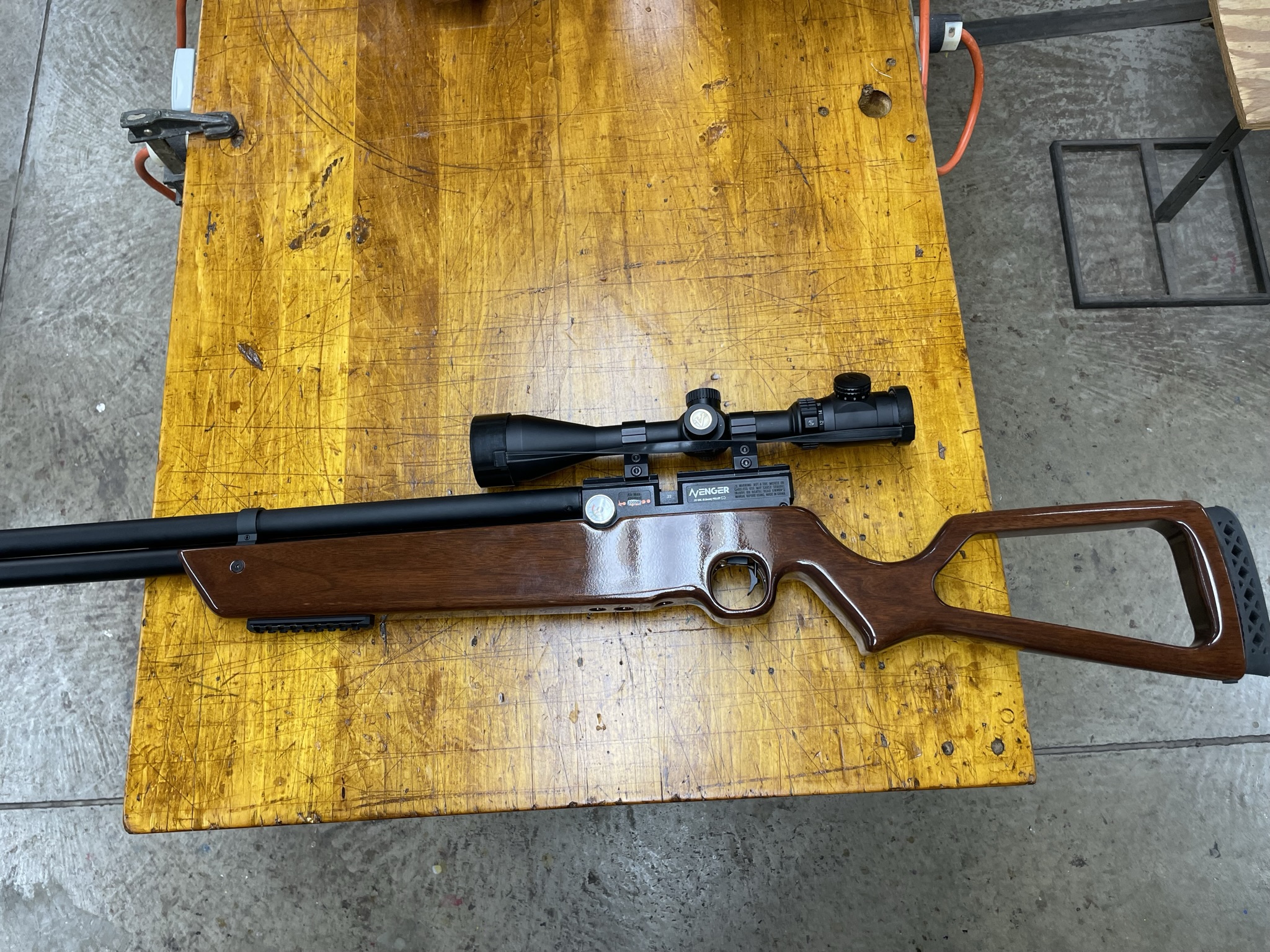

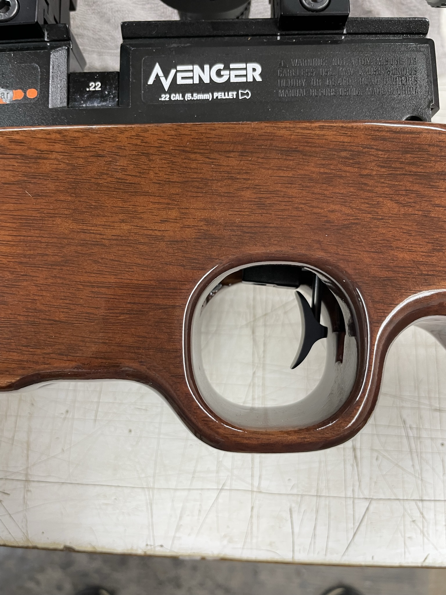

Finally I put the action back into my one-off walnut stock. It’s certainly NOT a RAW trigger but I’m pleased with the improved feel and reduced pull.
