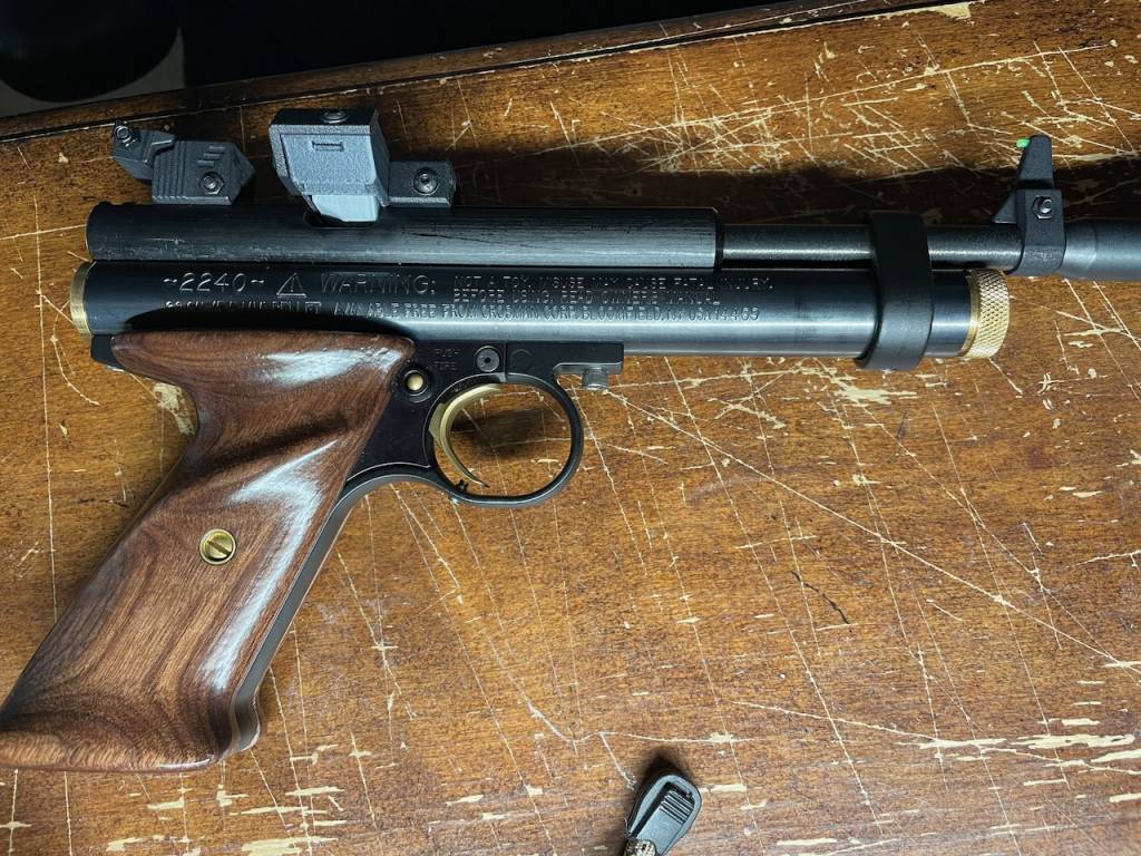

Got a new GravMag today for my 2240
Got a few items from Airgun Parts Shop in the UK today.
First is a GravMag Compact with left handed bolt configuration.
Also, I wanted to try out the Iron Sight kit.
I'm very happy with the GravMag compact and the slimmer profile on the top of the 2240.

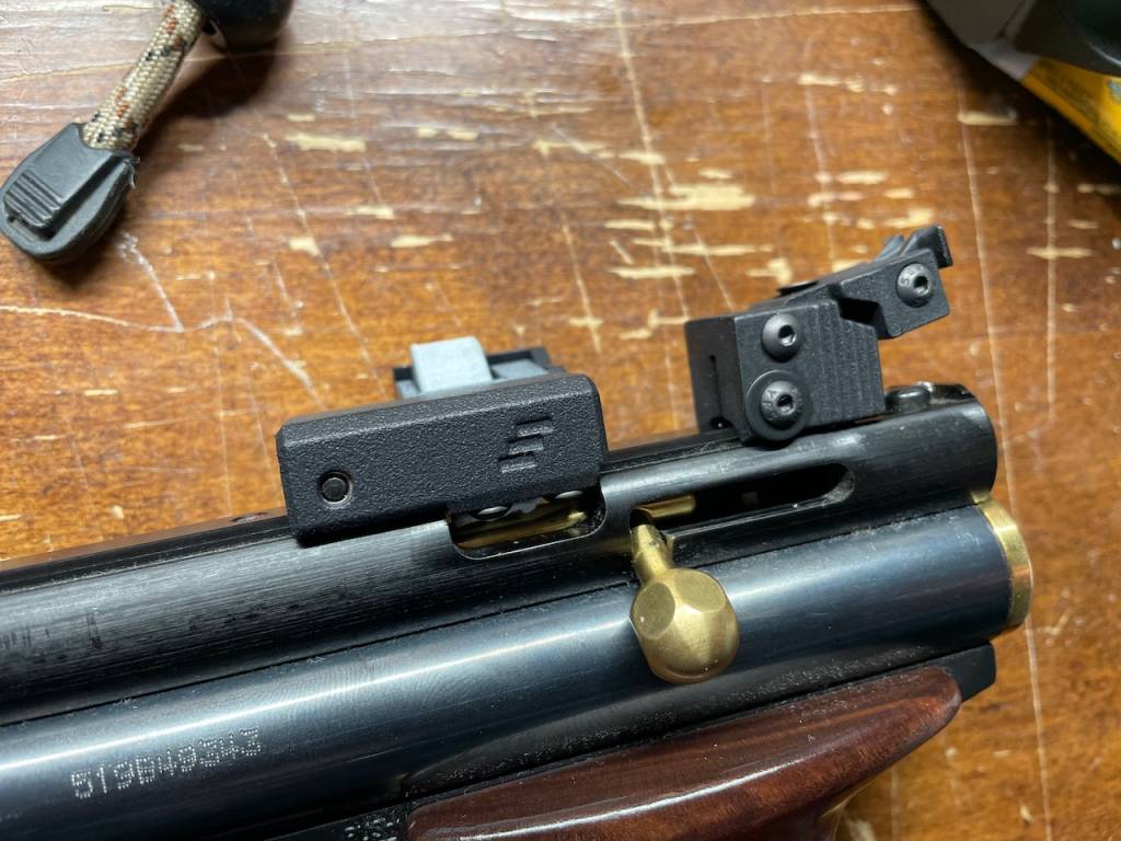

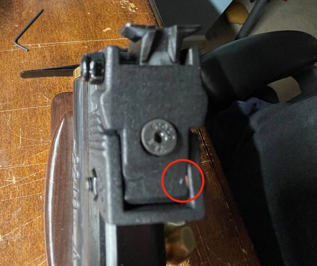

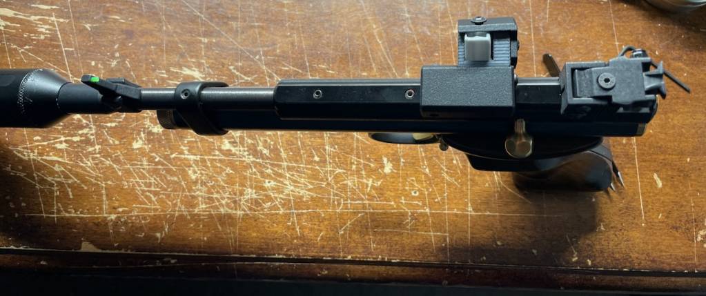

I wanted to like the iron sights, but I feel there is too much slop in the rear sight to keep it accurate. I adjusted it right where I wanted, but it was still a bit low. Went to adjust the elevation and then it's shooting 2" to the left. Nice concept but the execution's not worth the price. I even tried shimming the pivot point with 0.3mm total of shims but didn't help.
I messed around a bit more with no success and just went back to my 1 MOA Trijicon RMR.
