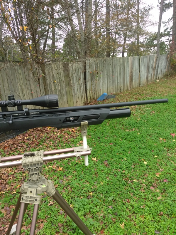

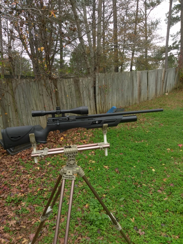

Got my 23ci bottle for the Gauntlet
I can tell there is a weight difference but anybody that knows me, know that I don't worry about weight in a gun. I used the same regulator but for some reason I'm getting 20 fps increase in velocity. It's still stacking pellets at 35 yards and the shot count should almost double. i ordered a tank for the 177 cal also, but it got side-tracked in mailing. Hopefully, it will get here tomorrow.

I probably will not do any mods to this rifle. I got it as a backyard shooter, kind of like my springers. When I just want to grab a gun and go out and shoot awhile without worrying about taking a tank or anything else out. I have a 22 Kral Bigmax and a 22 cal Hatsan Nova. Both are high shot count guns that get 32-34 FPE. The Nova gets about 80-90 shots and the Kral get over 120 shots. I'm happy with 23 FPE from the Gauntlet especially since at 35 yards it shoots the Crosman hollow points from Walmart as well as any pellet. I haven't posted any groups but most are one ragged hole unless I throw one with poor technique.
