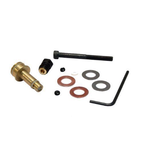

This IS the original Ninja bonnet removal tool they inculde with their kit:
Unscrew bust disc ( or fill valve I dont recall) incert long bolt and use that to turn it. Works just fine.
Note that is a full rebuild kit for the original coil spring 850psi unit but that removal bolt still applys.
