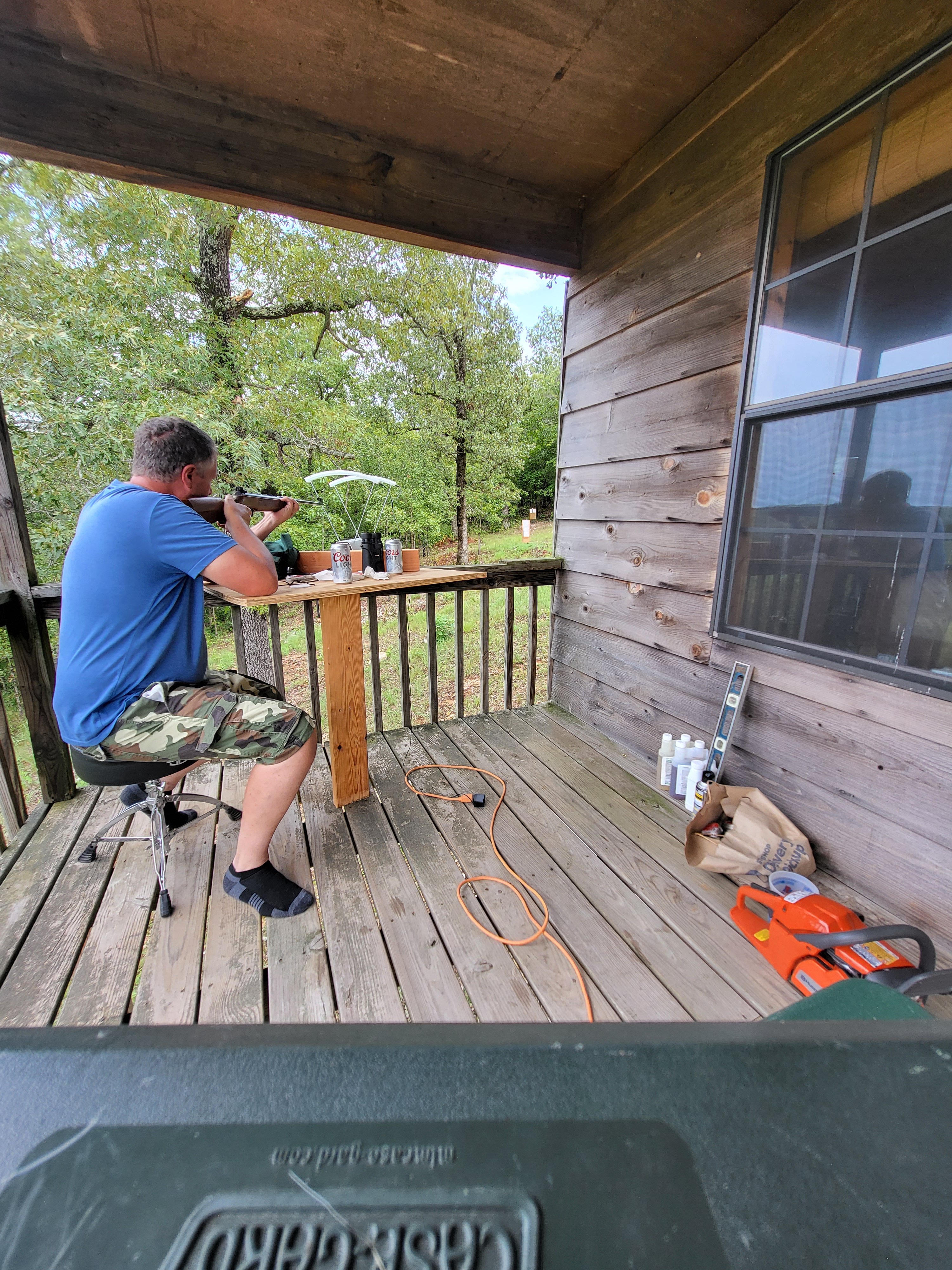

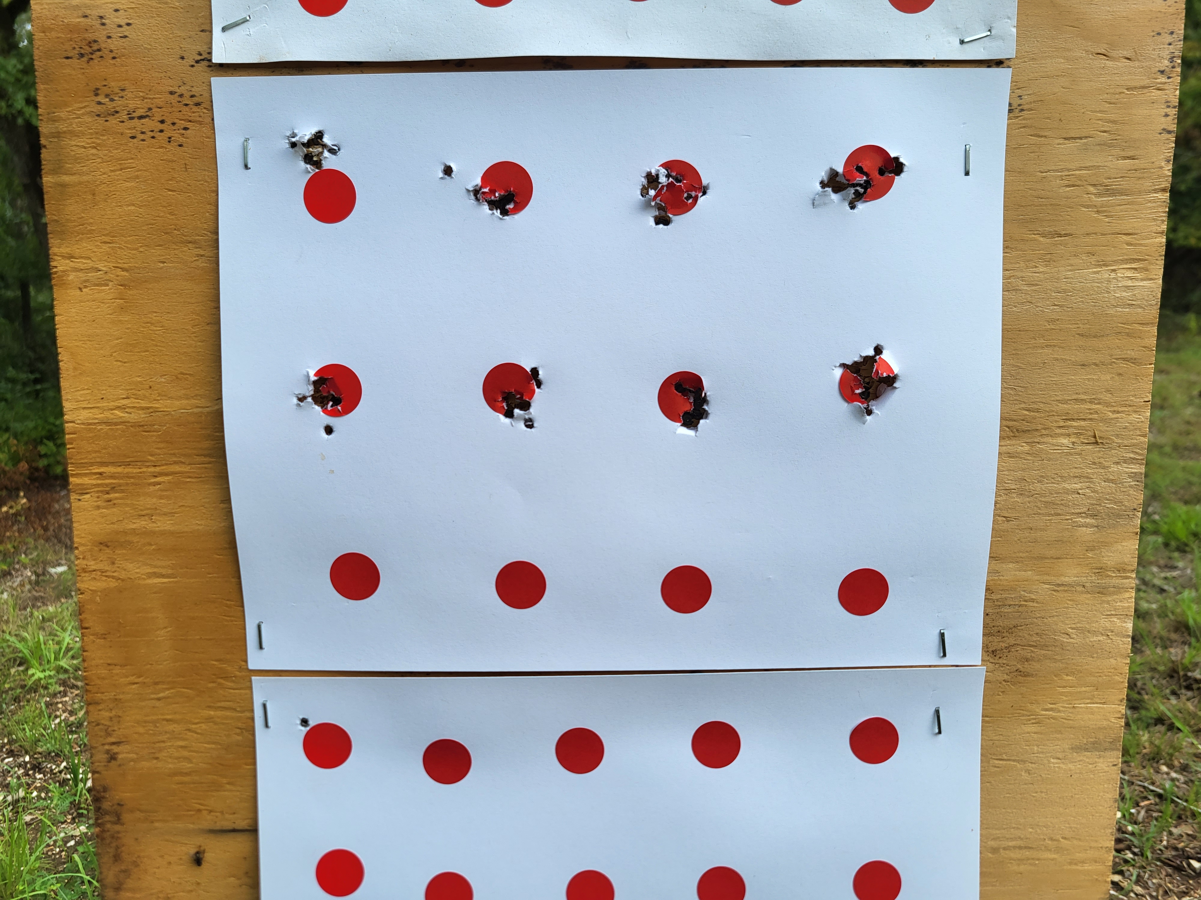

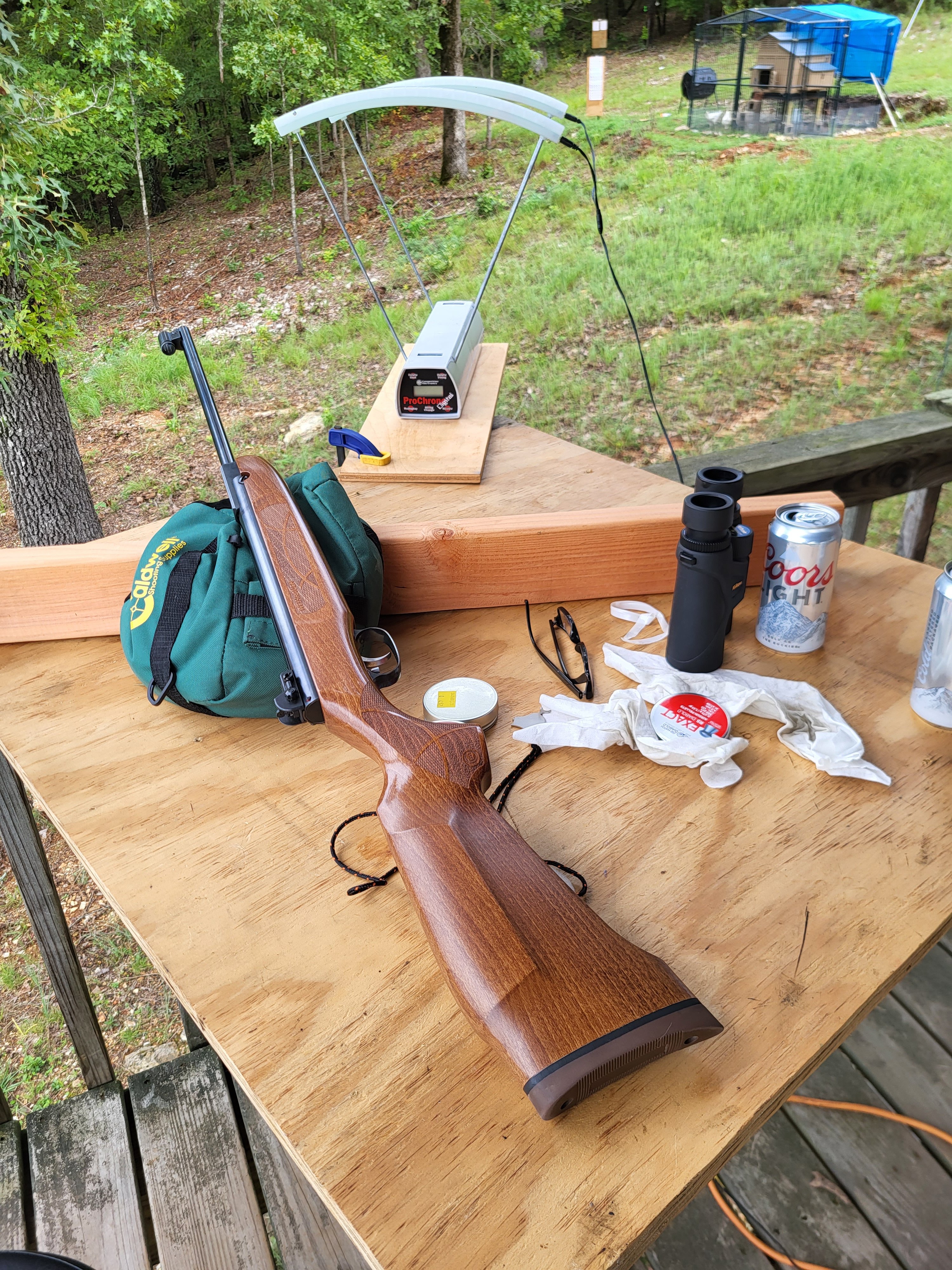

My Hw30s are my favorite. I was having issues with one of them shooting sub part. With a little parts swapping for diagnostic purposes I got them both ironed out. My peep sighted one is my favorite. Not the most complimentary picture but here's me shooting it from a bench, the rifle and page of ten shot groups. The red dots are 3/4" round. I'm pretty happy with that for 28 yards unscoped.
Thanks for looking

The Grey laminate gun that I was originally having low power issues is from 2017 or 18. The shot count is in the tens of thousands. It has a Vortek PG2 kit in it. It's been through a couple springs and piston seals. My issue with it was the power was lower than normal. The piston seal was worn so I replaced it with a seal I thought was new and there was no improvement. I tried a fresh spring and there was no improvement. Out of usual suspects I swapped the kit and piston with my other HW30 to see if the compression tube somehow was bad. The low power followed the kit and piston to my peep sighted 30. I replaced what looked and tested like a good piston seal and the power was magically restored. The accuracy improved as well. I can't explain what was wrong with that seal. All I know is that it was bad. The gun is shooting almost 8.5 fpe now. That's about what I expect with a fresh seal and spring.
