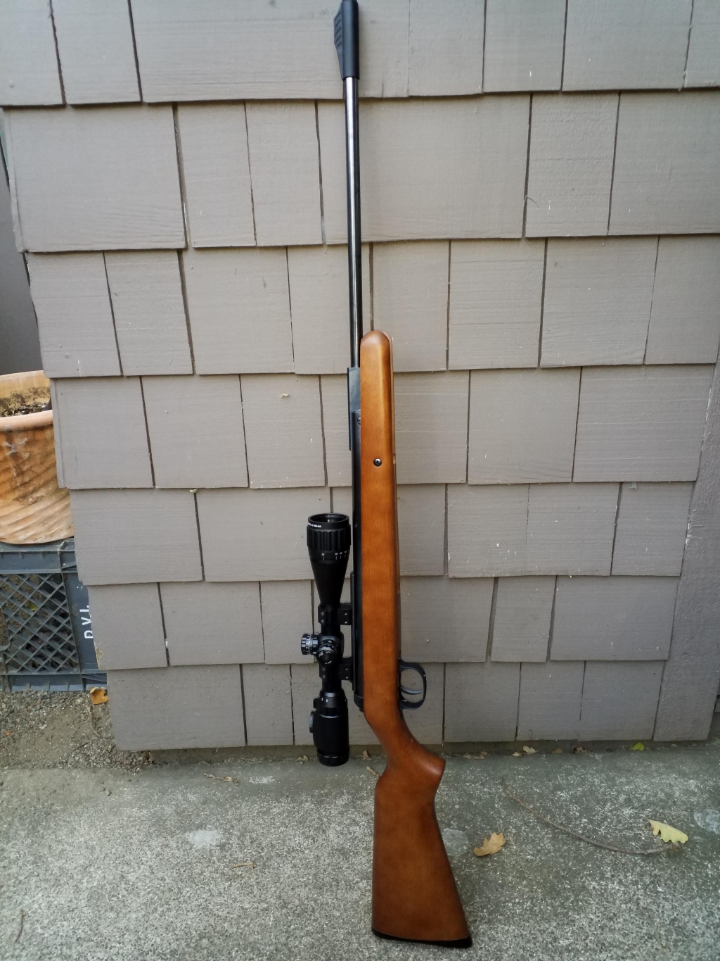

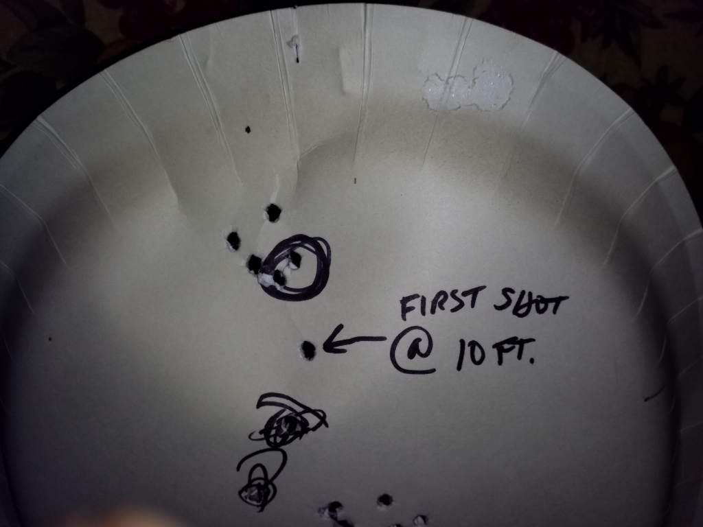

Installed the scope today and did a little accuracy test. Just as I suspected. The scope needed no elevation adjustment at 10M. Point of impact is right on par where it was when I had the scope on my Sig ASP20. Conclusion.....no barrel droop on my 34. Those forearm stock screws still come loose. I think the remedy for this will be to get longer screws and nut them on the inside. Shot 5 JSB 8.3 gr over the chrony for an average of 940 fps. Smoking hot !! Here is a pic.
First shot was at 10 ft or so. Didn't want to chance putting a hole in my sliding glass door. Then shot at 10M. No elevation adjustments made. Settings were unchanged when scope was removed from the Sig. Only made 12 clicks to the right. Last two shots in the bullseye. No barrel droop on my M34 !
