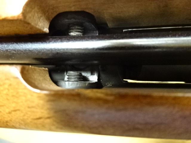

There looks like enough room for a jam nut. Might be difficult to turn a small wrench in there. ?? Yes, the plastic sight body is pressed on tight. Twist and pull it off or tap off with wood block and hammer. You will see a big 45 degree bevel cut on the face of the barrel. It matches a molded in bevel on the sight body for anti rotation. I put an aluminum handle-shroud on mine so it cant be seen. I cut my stock to match my other 34. I had my fingers caught too many times closing the barrel. I was used to no wood in this area. No JB seen on the screw. They have held tight for dozens of tins.

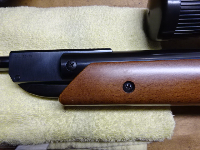

Wow! The end of your stock looks like the older FB 124/127.
If I drill the yoke threads out I wouldn't have to turn the nut. Just hold the nut in place and use a screwdriver and turn the screw. I removed the toothed lock washer and just used my brass flat washer. Used Loctite and it seemed like the screw was able to get tighter. Will see how it holds. Will test it Friday. I was going to use one of the RWS muzzle brakes but think I will just leave my front sight as is.
Note : I may not have to drill the threads out of the yoke tabs. Just run the screw in until it just clears the yoke tab. Then start the jam nut and hold in place. Then take the screwdriver and tighten while holding the nut. Tricky, but could be done. Wonder if just using a light coat of JB Weld on the screw threads only might hold ? Not to heavy that the screw could be broke free fairly easy.
Right now the yoke is acting as a nut. Drilling out and nutting will be the same end result. Your second paragraph thoughts would accomplish the jam effect. The top screw in my photo shows some residue of JB on the threads. I did try this epoxy instead of Blue and Red locktite which both failed to keep screws tight. The JB held longer but eventually loosened. I went radical and tried the already described epoxy method. One day I went to change a piston seal and the screw was frozen. I was really torquing the phillips to the point of screw slot damage. PANIC. I tried the hot screwdriver heat transfer method and all was good, it turned out with ease. I have done this a couple of times now with confidence in the method. Loose screws suck.

Mine is not under warranty. Ebay purchase. I agree with not drilling out the threads.

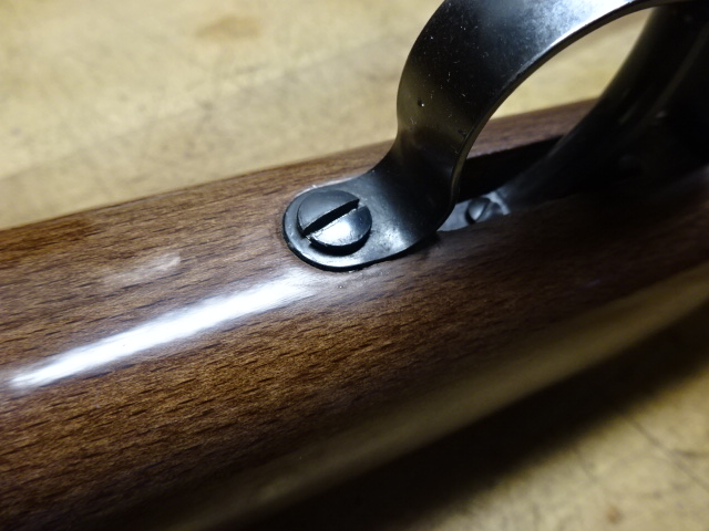

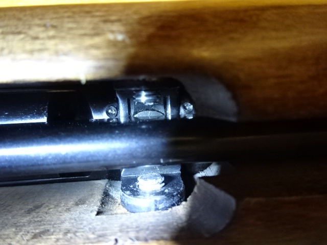

Another thing that was causing screws loosening was the yoke was getting sloppy in the dovetail cut. The big center screw is staked in place so you can not tighten or loosen it. Both my guns developed this problem and you could feel it with stock movement and buzzing when fired. While both were apart I added four stake hits on main tube to eliminate movement. This cured any more tendency to loosen. My older 34 has had screw issues and got "improvements" over the years. The two front screws are now 10-32's and JB'd per my explained method. The original M6 trigger screw was always loosening. Constant tightening combined with recoil and loose front screws, I was getting a sloppy thread fit on the cast trigger. Eventually all the cast threads stripped out. I tapped the T05 trigger .1/4 -28 and trimmed a Remington 700 screw for a full thread engagement. Just a little JB under the cap and it does not come loose anymore. Thanks in part to the good Vortek mainsprings I have not had to take down these two guns in months. All screws remain tight. I love tinkering with these 34's.

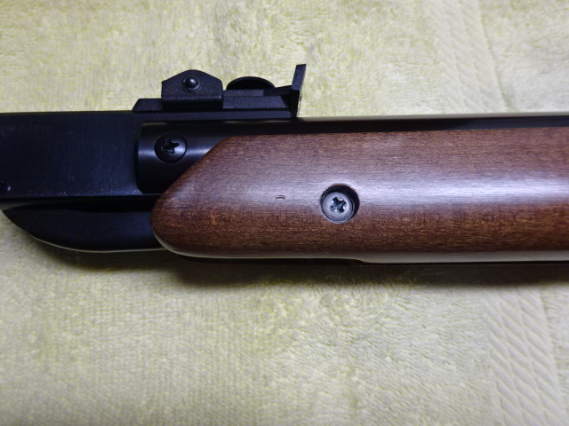

Not really sure what you're talking about here. By "big center screw" are you talking about the forward trigger guard machine screw ? I don't have any problems with that one coming loose. Note ! Shot the M34 about 20 times. Checked forearm screws. No movement so far!!  They use to loosen up after just 10 shots or less. Used my #10 brass washer with the ID turned down to .393". Did not use the star washer and torqued screws down to 25 in. lbs. using blue Loctite. So far, so good !

I am talking about the M4 or M5 flat head screw that attaches the yoke to the main tube, under the cocking link. The factory stakes them so they will not vibrate loose. You can see the head radius between my stake marks in the center photo. I have pictures posted of it here but do not know how to retrieve them.

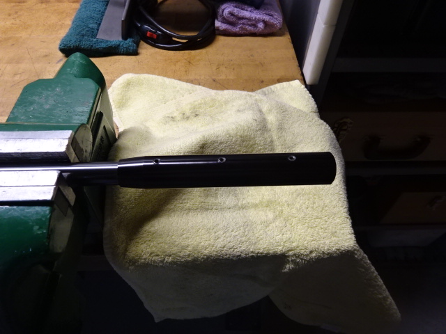

I have this handle/shroud..forgot the brand.. on my newer 34. Even with three set screws it would slip down from recoil. I finally drilled a shallow hole in the barrel for one slightly longer set screw to keep it put. No more slipping.

Did some more work on my M34. Noticed that the cocking arm was slightly rubbing on the left side of the stock cocking slot. Took about .025" off and all is good ! I also backed off the tension on my barrel pivot bolt. It was way to tight. Cocking is now much smoother. After cocking, the barrel will still stay wherever you let it go. Barrel doesn't rock in the receiver tube fork so it's perfect. Gave the threads of my forearm screws one mild tap with a ballpeen hammer. Screws now have some resistance to turning. Added Blue Loctite and snuged the forearm screws down to about 27 in lbs. Will let everything cure overnight.
