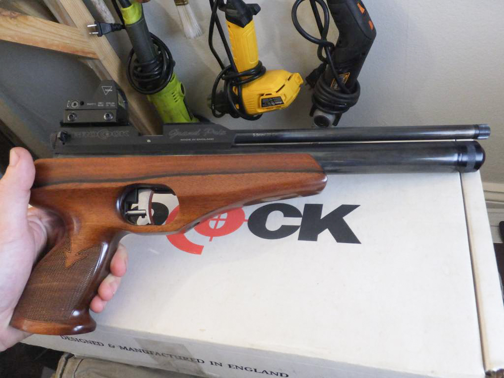

Got some new wood for the Brocock Grand Prix
After theives had stolen my pistol stock, I set out to find a replacement. Brocock had them listed for sale, but upon my attempted order, they informed me there were no more. Gary Cane was making the latest stocks for these, so I reached out to see if he could make a new one. I had to purchase a shotgun blank, and the shipping wound up being very expensive, but it was worth it.

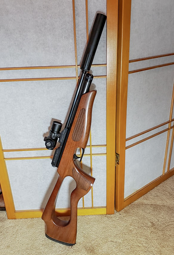

Carbine stock was on when the pistol grip was stolen from storage.
Thanks guys. I was honestly expecting something much more bland! As for the sight... It's a Riton 2moa red dot. They're very well made, and I've been super pleased when them. I just bought a second one. First I think I paid $100 for, second was about $110. I don't think you can get a better 2moa dot for less. I also like that it goes from super bright to super dim. I can easily use it in the middle of the night. Or in the middle of the day.
I think I've got it doing about 20 maybe 25 shots at 620 fps with 16gr pellets. I put a stiffer and shorter hammer spring in it so there is no hammer bounce now. It's extremely quiet! I re-blued the gun a second time as well. I don't know why but it would rust constantly, and nothing I did short of bluing it again got it to stop.
This gun in the carbine stock is obscenely accurate even out at 40 yards or so.

Oh wow!! He did a job that! The finish looks great!! I think it looks better than the original.
Right? The way the market is today, good walnut tends to cost an arm and a leg, and anything that tends to be sold on production airguns leaves a LOT to be desired. So, I can say I am very pleased! I know laminate is a superior performing stock. Which I could have opted for, but I'm a sucker for traditional wood stocks.
