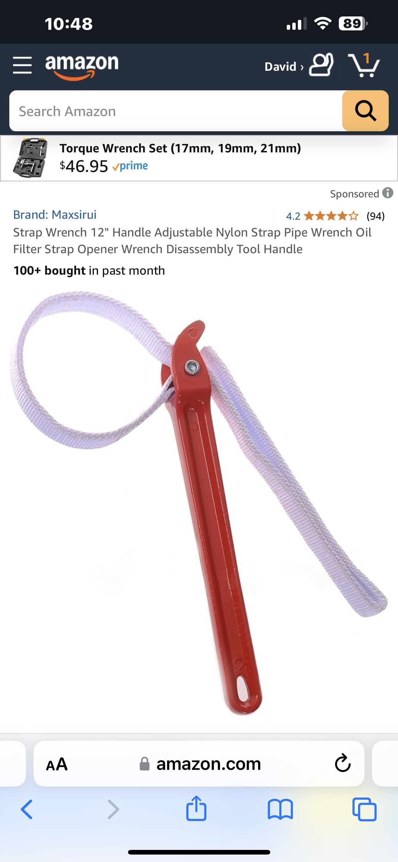

Put a bottle strap on the bottle and the proper size wrench for that fitting marked in red
Thank you and also to the other member that mentioned the strap. I actually did get a strap last night, and that’s how I was able to get the bottle off in the first place. Definitely the strap is essential. I’ll try an appropriately sized wrench on the red bit next. I kinda figured tbh, but I just wanted confirmation. Heat gun might be a good idea. Thanks again.
Reactions: BABz58

For maximum effect, clamp the handle of the strap wrench in a vise.
