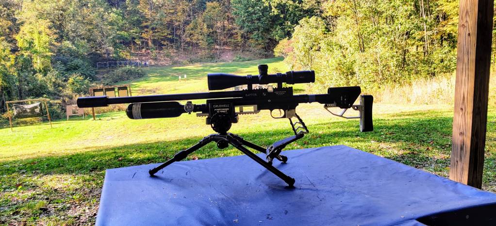

As man o fyou know, I've had very good accuracy from the Raptor Prototype I have after in stalling an FX Heavy bbl. for shooting slugs in my gun. However, it was not a happy time. It is well known that the Raptor suffers from a not so well designed valve and seat that loves to fail. Particularly in HP applications.
I've had a hard time keeping this one to myself for about a year now. Don Cothran Machine to the Rescue!
Don wanted the factory valve to see what the issues were as it was in reality a poor copy of his valve designs. Due to work load, and health issues, Mr. Don was held up in the project for quite some time. that and he wanted to completely redesign it to his standards and went even further along with extensive testing.
A fellow member here also sent Mr. Don a complete gun as mine was a prototype and may be different that the production pieces.

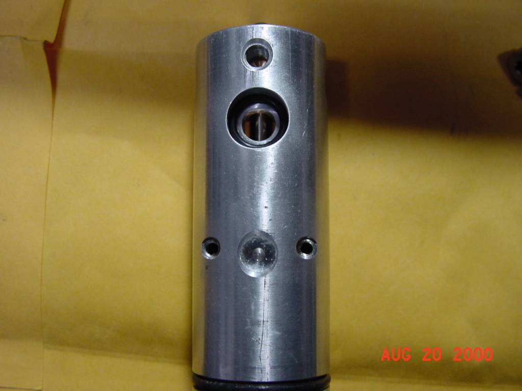

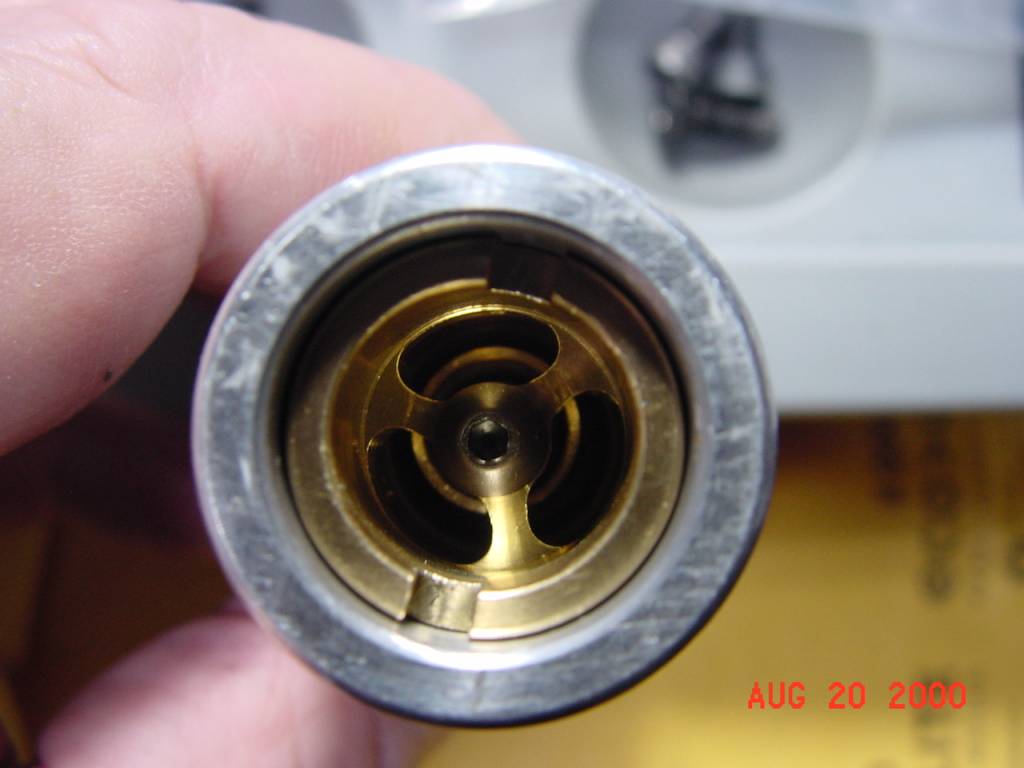

The new valve is built like a Tank and is beautifully machined.
Don cautioned me to use very light spring pressure and only the slightest hammer strike and hammer pin setting limiting travel. With his advice, I removed the rather high rate spring and replaced it with a shorter and lighter one I have here. the results were unreal! As often Cothran valves are.
At the very latest setting on the reg, 2300 psi compared the the previous 3000 psi, light spring barley touching he hammer. Well Not actually touch it at all allowing a good bit of free travel, and the striking pin backed out to only allow well less than 3/32nds travel of the valve stem, the gun went super sonic with pellets. (I only used pellets for the initial tune as I don't' normally shoot pellets.
I loaded the 37.6 grain slugs I cast for it and it was already matching the velocity of the heavy set up with no further adjustments what so ever. First shot was 960 fps for 77 fpe.

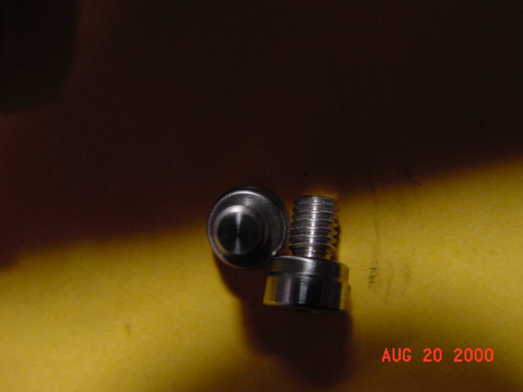

Every thing is machined out of billet. Heck, even the screws that retain the valve in the air tube are machined for a custom fit by Mr. Don. Absolutely superb workmanship.
I have heard of Cothran Machine and his work for years, but his workmanship exceeded an expatiations I had.
Her are a few quick and poor pic's of Hiss outstanding work.

Everything fit beautifully as it it was made for it. Oh wait, it was. LOL!

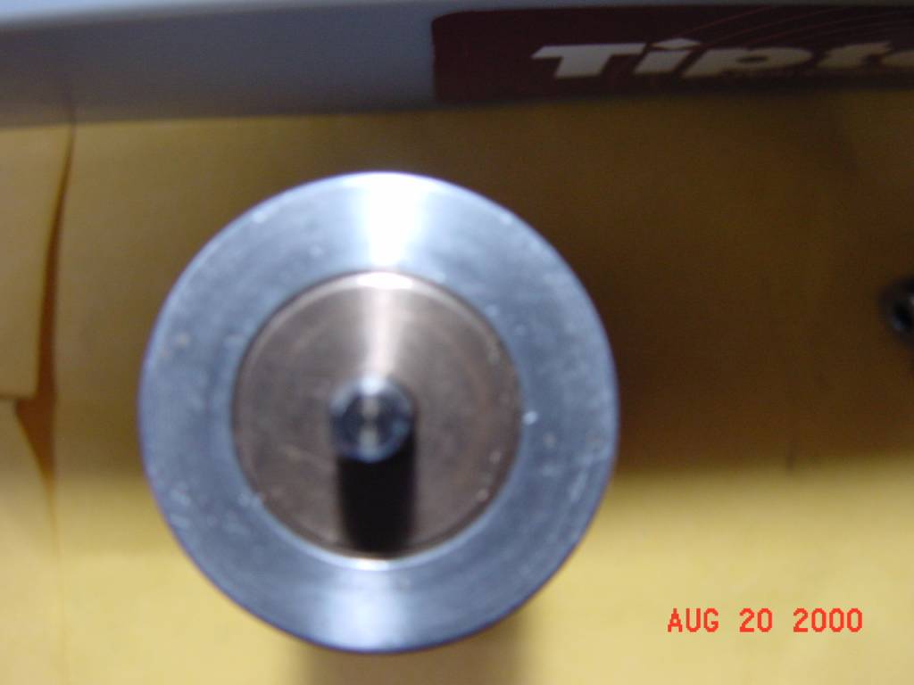

My apologies for not including the pic of the actual transfer port, Getting old I guess.
Man, this thing flows some air! cocking force, as it is a balanced valve is virtually non existent. Just a pure pleasure.

 Come on man, he actually machined the screws form high tinsel Stainless Steel Round stock. Who does that? A perfectionist.

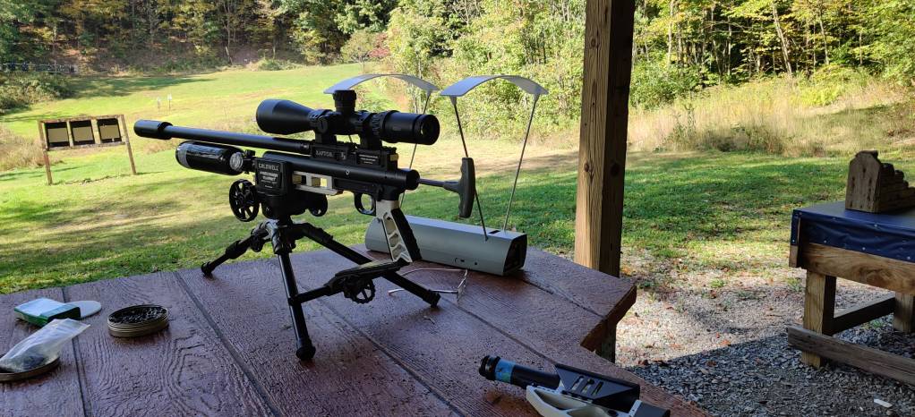

Hey Mike, thanks for posting! I was wondering how things were going for ya. Mr Cothran gave me the green light to go say he has his Valve kit available for the Raptor. I guess I'm the other guy that sent him a complete gun awhile back. I hope I'm not wrong in saying but I think it's a direct drop in /plug and play for the Raptor. So I went to the range and forgot the spanner wrench to adjust the regulator also my SCBA tank was low on air at 3,200 PSI. My reg set pressure was 2100 PSI. I put a 25 caliber 25 grain jsb and take a shot zing 980 on the Chrono with a big blast of Aftershock air out the barrel. . Took a some more shots very little accuracy too much air what really surprised me was feet per second was within five and a couple few duplicates. I called Mr Cothran as usual he answers the phone and I asked him is it okay if I turn the striker screw out and adjust the hammer screw out and he says yes it's okay. The rifle range was occupied by rifles so I went to the pistol range and turned around backwards so I could shoot across the field picked out a tree a hundred yards away start shooting slugs getting an inch inch and a half group at 100 yards as according to the parallax on my scope. So all the rifles left the rifle range and I went over there and set up start shooting pellets.... Best accuracy was when I fell off the reg around 1800 PSI start stacking pellets / dime size 50 yards.... Shoot across the crony 850 psi. Yes I've heard many times they like to go in around that speed not surprised. So I know it can be tuned down to shoot pellets. I have very minimal knowledge of air guns and tuning but I get the distinct feeling this setup will really shine when you crank everything up . Thanks again Mike for helping me get Mr Cothran some credit where due.
