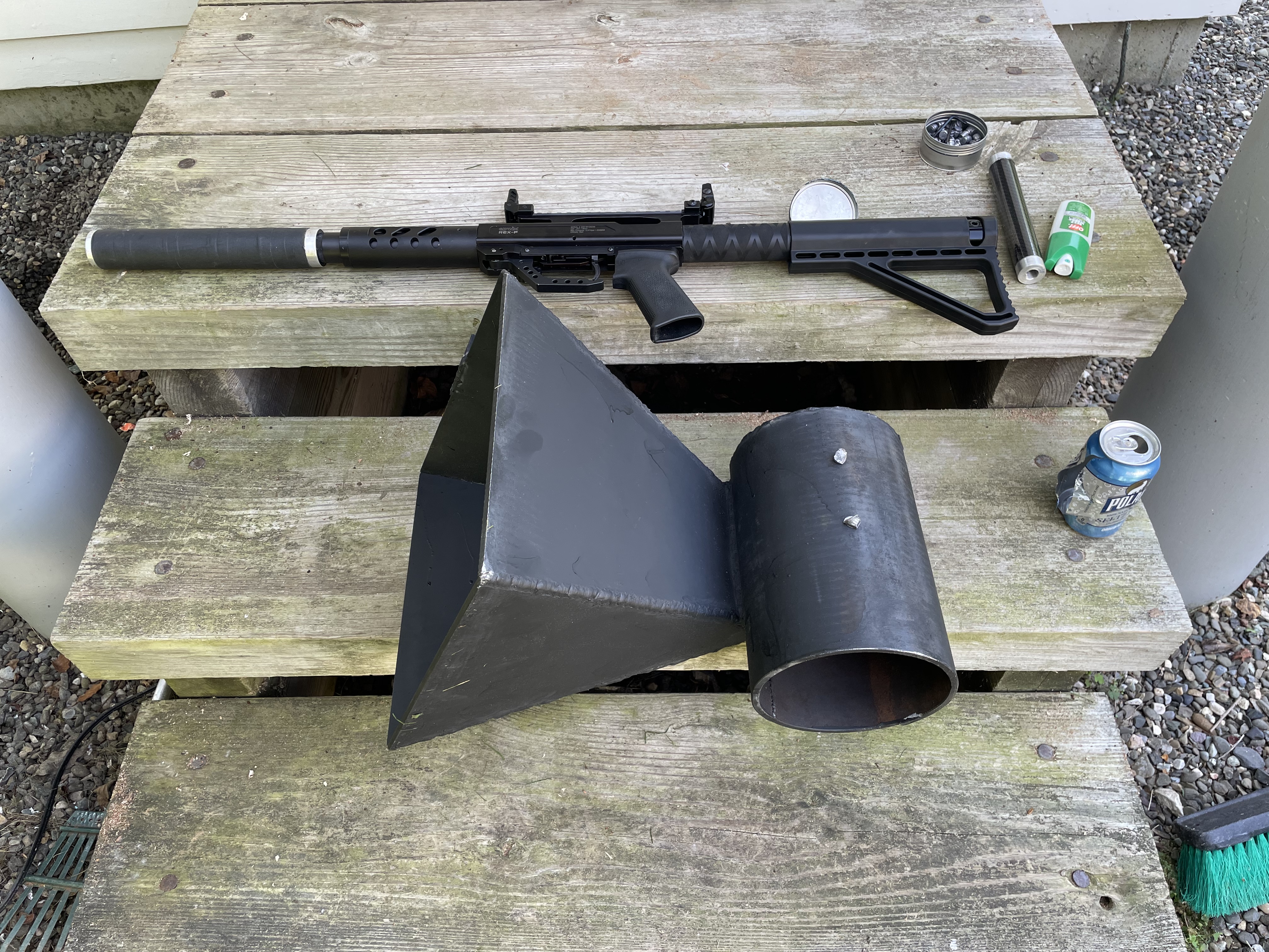

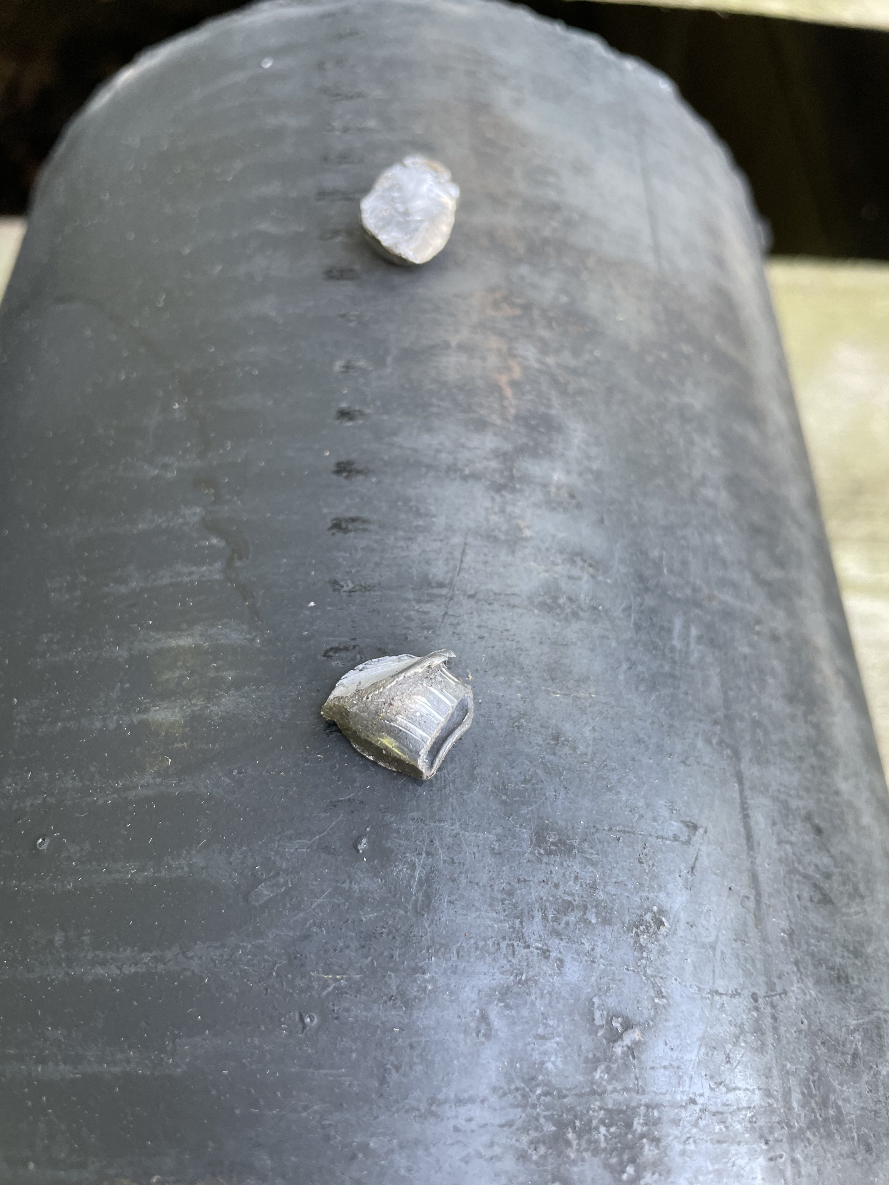

I bought a 12” x 12” centrifugal bullet trap off of eBay. Not much more than the (less effective) standard .22 rimfire traps but much more effective for recovering intact lead nuggets and producing essentially zero back-splatter of lead fragments. Because the lead is always hitting at a shallow glancing angle it doesn’t break up as much as in my rimfire trap.

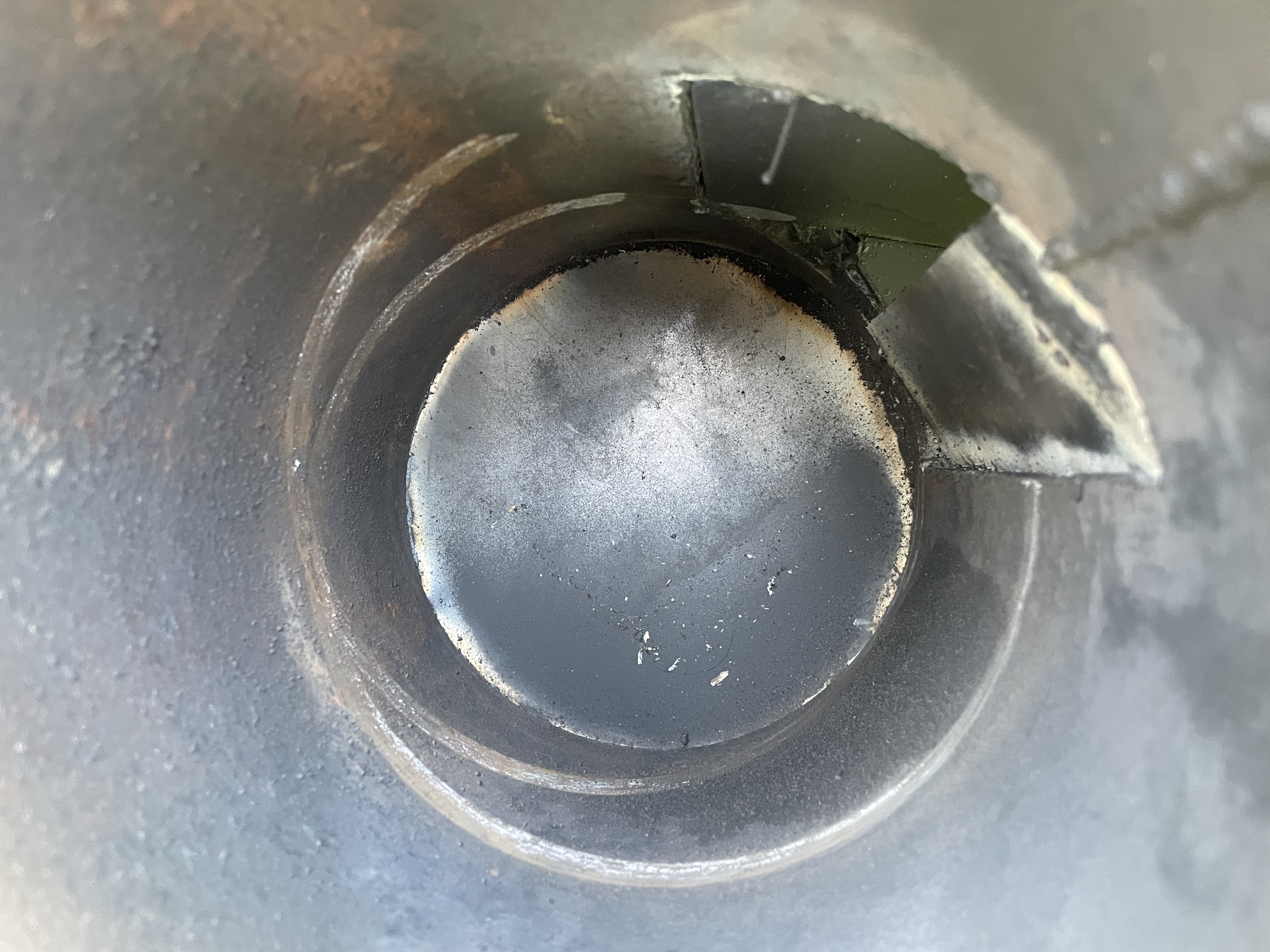

I’ll attach a couple of photos… I admit the one showing the inside of the catch container isn’t a great shot but you can kind of see the streaks from the pellets running along the inside of the curve.
The trap is quite heavy and very solid construction. I got it for $140 which i feel is a great price.

This trap does not have a closed container - the pellets just drop out of the open bottom of the cylinder into a box or bag once they slow down.

It is all 1/4” steel and is definitely heavy. 40 lbs seems like a reasonable estimate to me. Much heavier than my rimfire trap. I was surprised the first time I picked it up.
I’ve got the same one but I’ve made some modifications to mine. I welded a carrying handle on the top, added two more tabs on each side to clamp cardboard backers to and welded a small vertical lip on the bottom edge to keep dust from falling out. I also fabricated a pan to fit the open end of the pipe to collect lead.
Fun fact… we see guns shot on TV and sparks fly when they hit an object and then we rationalize this in our mind because we all know that lead is non ferrous and can’t cause a spark right? In low light, shoot a pellet into your trap, without any target or backer and aim at the side wall. You will see a spark. Impossible you say? That’s what I thought too. Try it and share your results.

My 9mm ammo shot out of a Rex p stays in a single lump more or less. I shot some .25 H & N pellets at about 65 fpe and they did not hold up as well and were wafer thin and some were fragmented. I know that’s to be expected but one important thing for me personally (as I have been doing a fair amount of indoor shooting) is minimizing dust and crumbs. So a duct putty trap (and rubber mulch it sounds like) remain my gold standard for clean and quiet shooting.
Also I think I had said that there was no back splatter but there is a very small amount. maybe 1/20 as much as with my rimfire trap.
