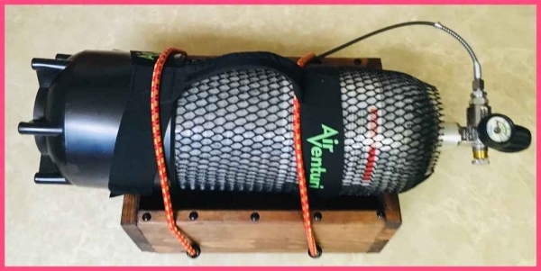

The dive shops will use the same fittings that are on your Benjamin/Tiger Shark/Great White but they use a hose with a female connector. They will probably have a double male connector which you can buy for just a few dollars from Amazon, PA, Joe, etc. The full armor package is the way to go. I had three of Joe’s larger tanks and one Guppy and the larger tanks had the package. You can easily make a package of your own from stuff in the shop and get straps from everywhere. Scuba divers use straps too. I have a Benjamin tank and a 74 cu ft AV tank. I bought the straps from PA. I made a wooden rack for storage and transportation. I have a nice canvas bag that I bought on AMAZON specifically designed for 6.8l tanks (74 Cu ft/Tiger Shark). It is great. I bought a rubber boot from AMAZON, too. So I made the stand (feet) and bought the strap, cover and boot from AMAZON. I think Joe’s package would have been cheaper but I like what I have.
The fire departments use a fill adaptor different than what we use on our SCBA tanks..
Here is my package:
1549293032_11353285285c5855e849dbc9.41120041_A55300D4-9722-40A1-9B17-5335A89E499E.jpeg

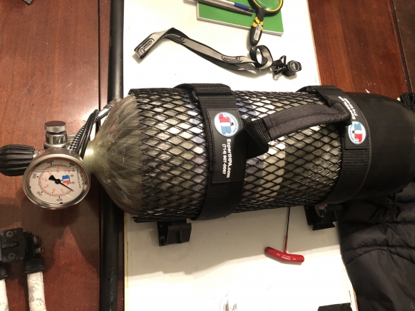

I have a GW with the armor package and wouldn't change a thing. Helps tank stand up if needed and protects the body from dings. Still have to be conscious of the valve at all times but that is just part of the process. Mine came with a Foster fitting and Joe Brancato fixed me up quickly with a simple screw in adapter for fire station filling. My local fire station fills mine no questions after an initial inspection visit. I drilled a hole in the armor package foot and screwed the fire house adapter into that for storage and it works great. Can remove the foster and place the fire house adapter in just a few seconds for fire house filling if needed. A Yong Heng topped off the GW from 3600 to 4500 in 20 minutes with no issues also.
