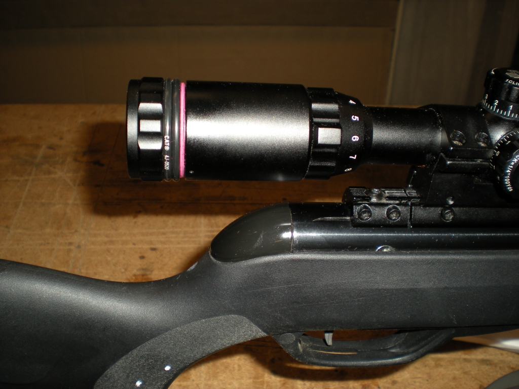

Thanks to all who posted on this thread. I have a UTG true hunter on an Mrod and yesterday morn the poi shifted 1.5" at 32 yards. Took it down to my indoor range of 12 yards and poi shifted every time I bumped the turret area of the scope. Contacted Leapers but have not a response as of yet and don't expect one for a day or two because of the weekend. I also have the same model scope on my Gamo Mach1 and figured poi shifts were caused by different holds. Modified both scopes as shown in pic and WOW!
The pic shows the adjustment ring before turned in. When I turn it clockwise to adjust it actually pushes the red oring into the fixed piece.This gives me about 1/2 turn of adjustment and takes all wobble out of the equation. This forum ROCKS!
