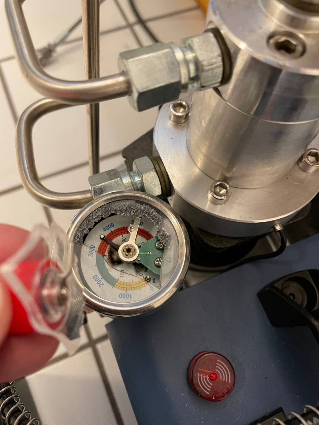

Guage on my Yongheng compressor destroyed..
Nope never seen anything like that before.........
well it is a machanical device, and if it was like mine the needle violently vibrates at high frequency which is going to cause stress and wear leading to failure ... not saying its a complete solution, but what i did was pry the plug out and dump in some thick silicone shock oil .. the original idea was to fill it and seal it but it seeped so i drained it, but it was lubed well, and even with that it damped it pretty well .. so far no failures ..
Totally agree on the needle vibration. I think that is what caused the arcing which ended up blowing mine out. I have since ditched the auto stop as it's way too glitchy. Got two oil filled standard gauges from Amazon and much better now.

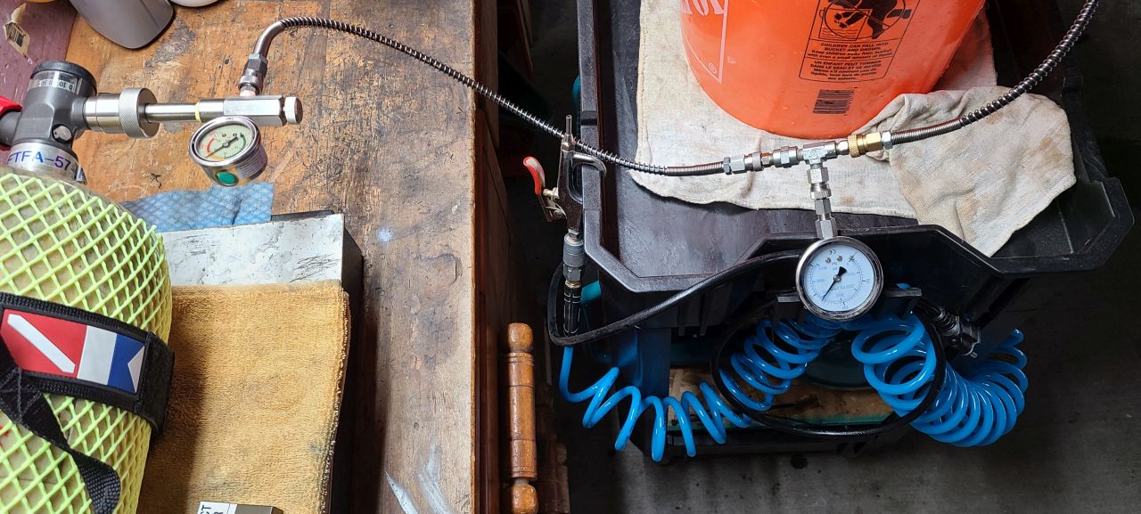

Second, I have two more gauges inline for double and triple checking the pressure I am filling in my tanks.

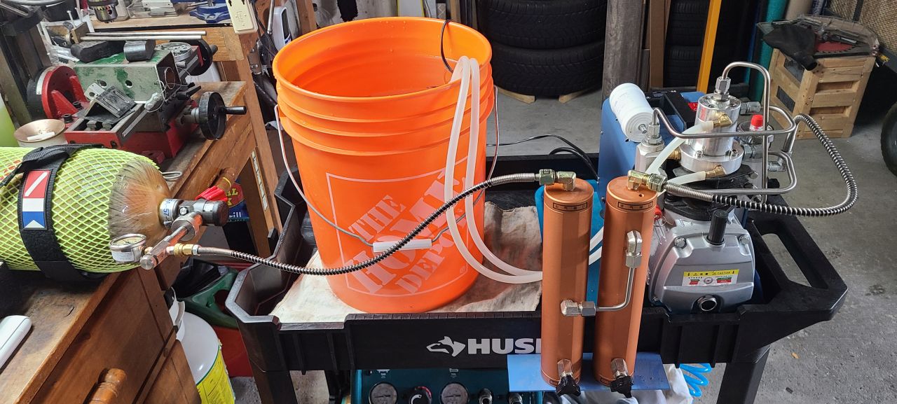

2. I will surely look into installing additional pressure guages. Can you provide a picture of your setup?
3. I should have thought if this.
After replacing 3 gauges, I now just put a brass plug there and rely on my tanks gauge, it's more accurate anyway.
I need a plug too. I don't need a guage on my YH. I use an in-line T-section on my output air line and attach a really frickin' good guage to that.
