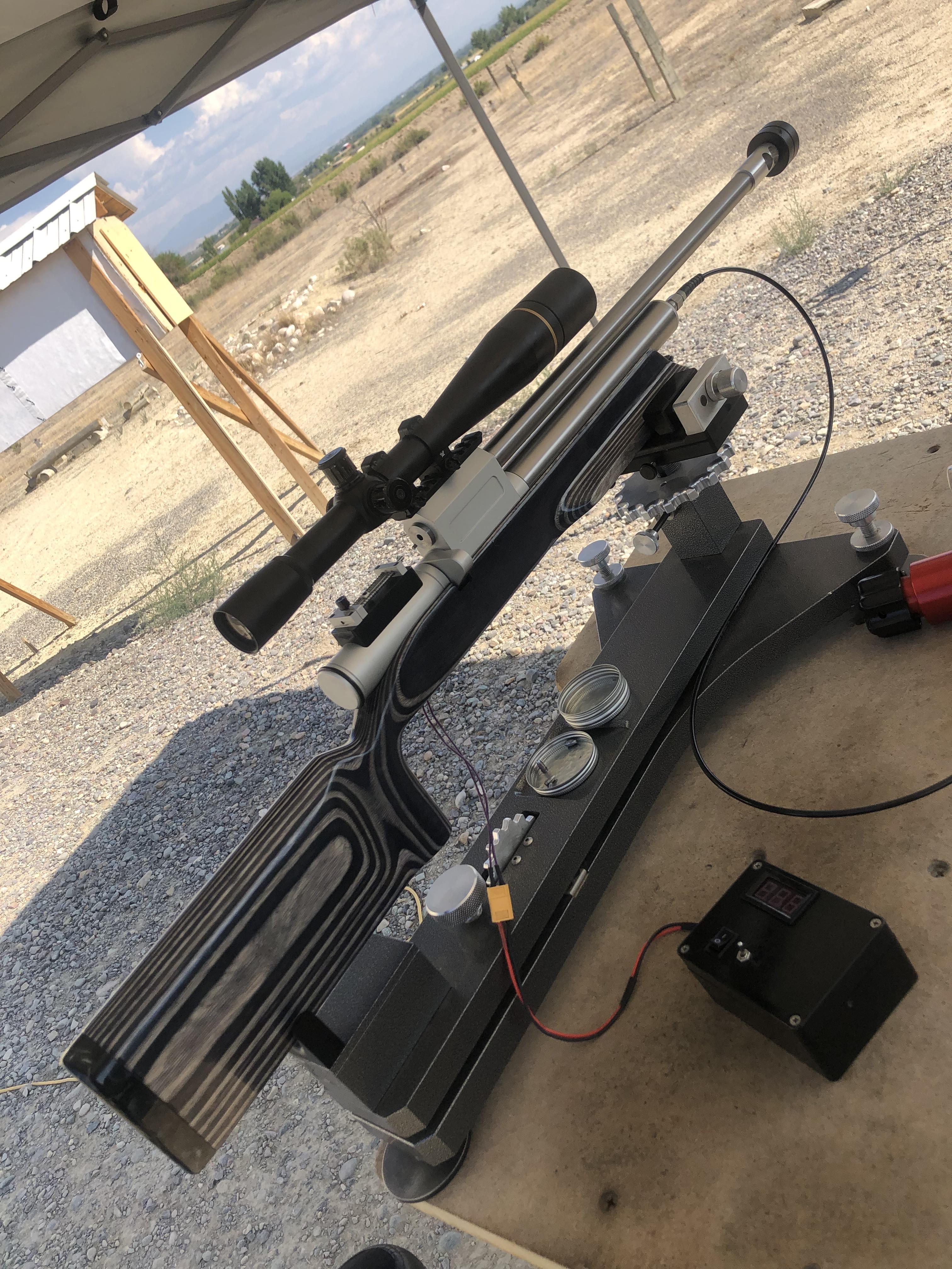

There is a big difference between a vise and a gun rest. A vise is something used to mechanically clamp something from moving. If vises were the key to absolute accuracy, then all Benchrest shooters would clamp their rifles into vises. Instead….all Benchrest shooters use rifle rests. A rest allows the rifle to recoil…it does not prevent it from moving as a vise would. The term “free recoil” is specifically about the method of using a rifle rest where you do not interfere with the movement of the rifle by gripping, shouldering or putting your cheek on the rifle. You pinch the trigger with your thumb behind the trigger guard or simply pull straight back on the trigger blade lightly until the rifle fires. A rest is working part of a Benchrest system. It can work with the gun or against it.

Fire this once and it will move back about 1/2”. Fire it twice without pushing it back forward and it will fall off the back of the front roller.

Absolutely correct. The Ransom Rest to which the OP refers is, I think, sort of a combination, but certainly closer to the vice type fixures used in production testing. The one I used was hard mounted to a huge concrete block with large studs and bolts. With a handgun, it allowed some recoil, but returned to a fixed stop. Having been a BR shooter I'm very famiiliar with free recoil, and this would be about the opposite.

Alan Z had a return to zero free recoil setup for testing Steyr's when he was doing a lot of them. Seemed that it was pretty dependable.
I also remember way back that many testers had serious trouble getting a Ransom rest to do as well as they could from bags. Iirc, it came down to getting the return tension right. They NEEDED to recoil, but the proper rate was important.
