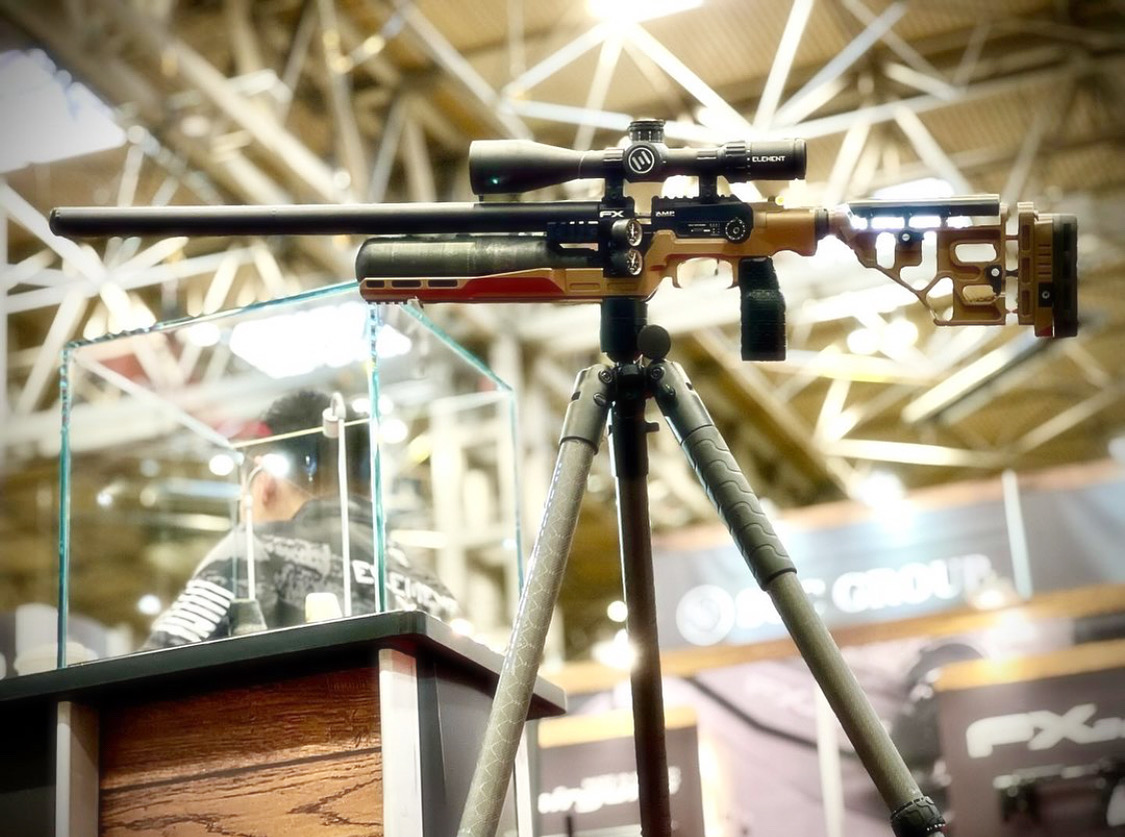

The guy in the photo/Rob has been shooting the tactical match scene for about as long as when these started. We've competed in the past a few times however we weren't squaded together. He's a good shot finishing higher up the roster or winning matches, is a nice person, and very knowledgeable about anything PRS or NRL.

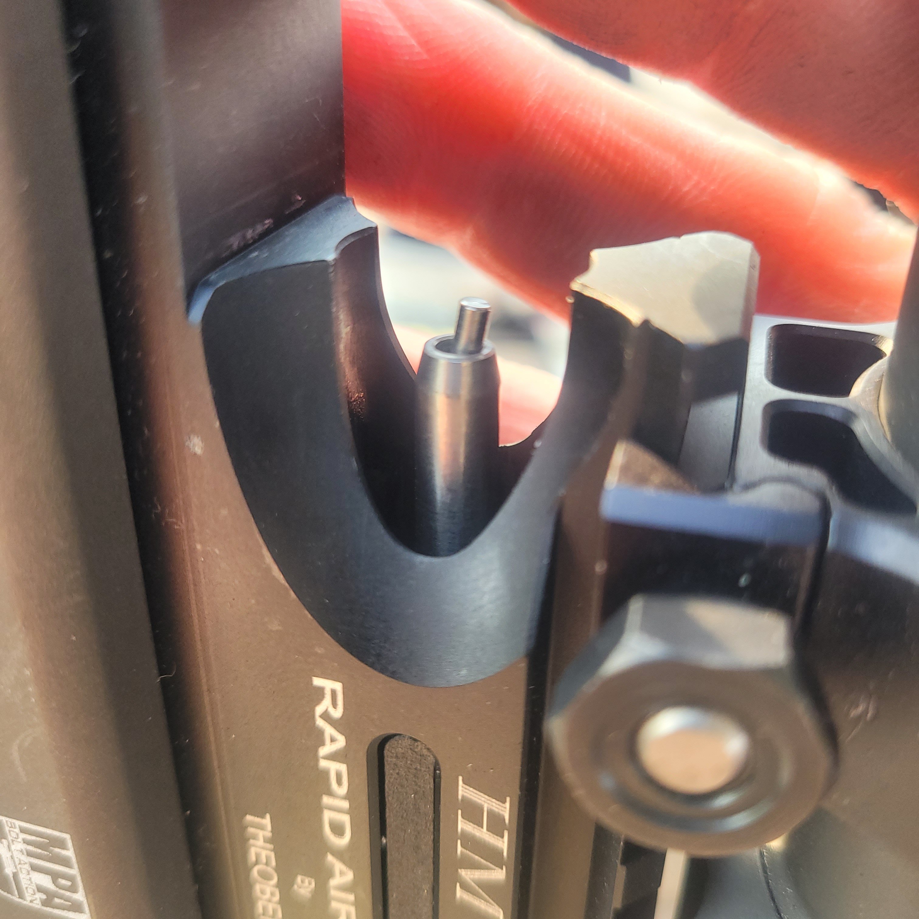

The rifle did great and was very stable and able to fit in every baricade. My only issue of the day was I seemed to have bent the inner probe somehow. I was able to continue the match with no issues.
Just need more practice and more shots with the rifle. Not knowing the wind calls really killed me. Though honestly I didn't need as much wind as I was expecting. The slugs were EXTREMELY consistent. We did set up a human torso at 214 yards and I wanted to try. So dialed up 11 MOA and sent a round, wound up a little low....made the correction and made 10 impacts in a row with the rest of the magazine! Needless to say the other shooters were more than impressed.
I was able to take the rifle apart and got the pin bent back, and things look better now. I installed the extended plenum as well so will see what happens.
Are the slugs hard to "chamber"?
Wondering if the probe bent by mashing the slugs into the leade.
