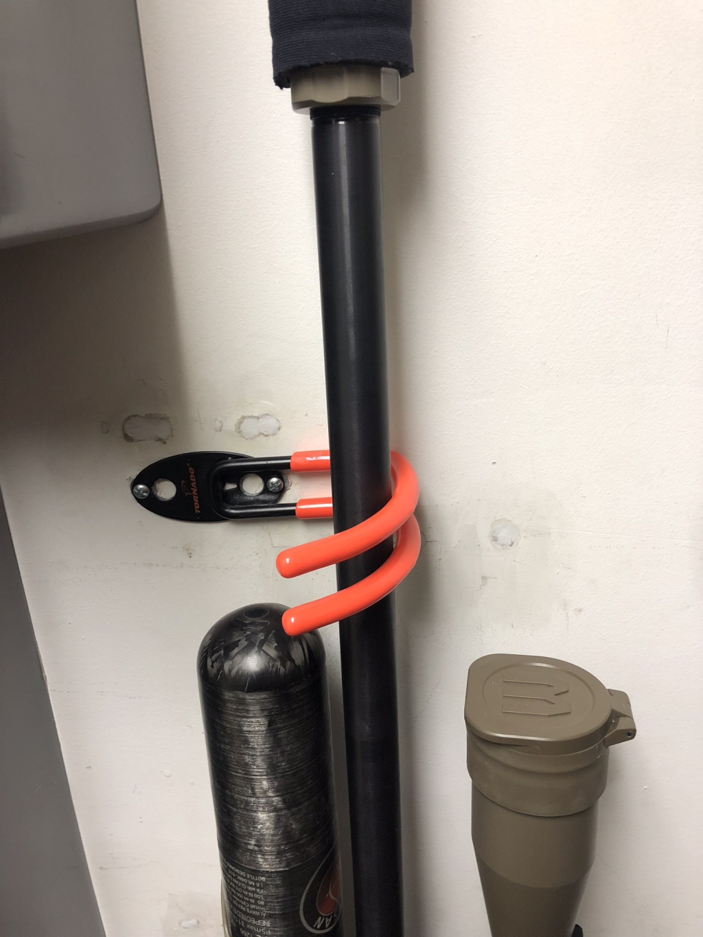

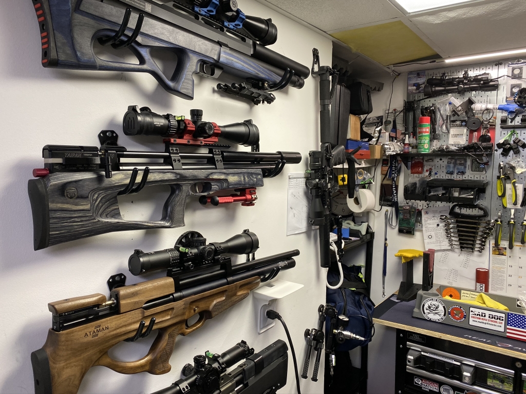

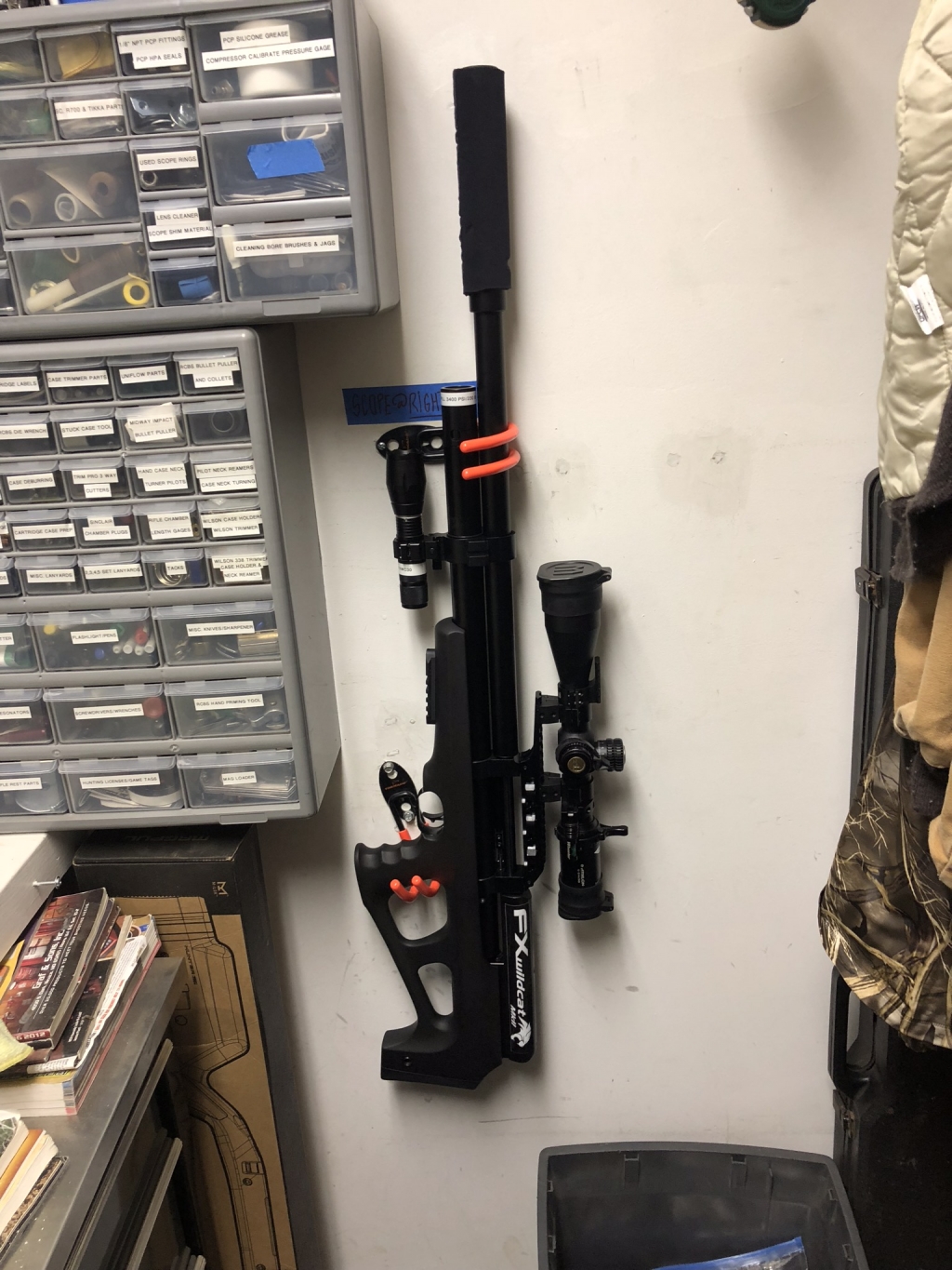

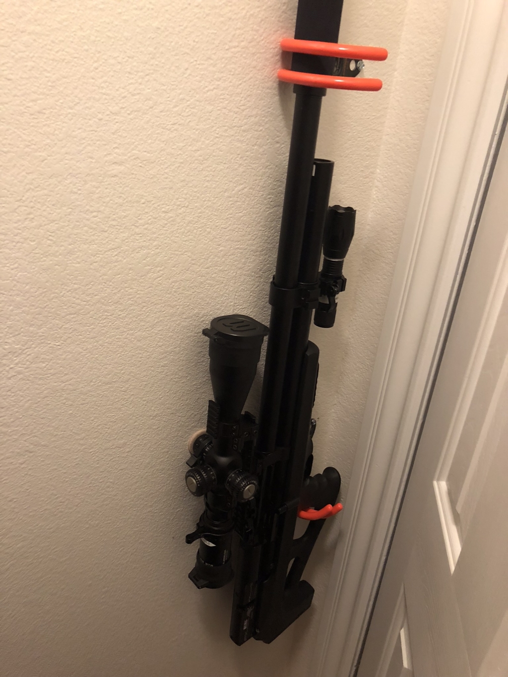

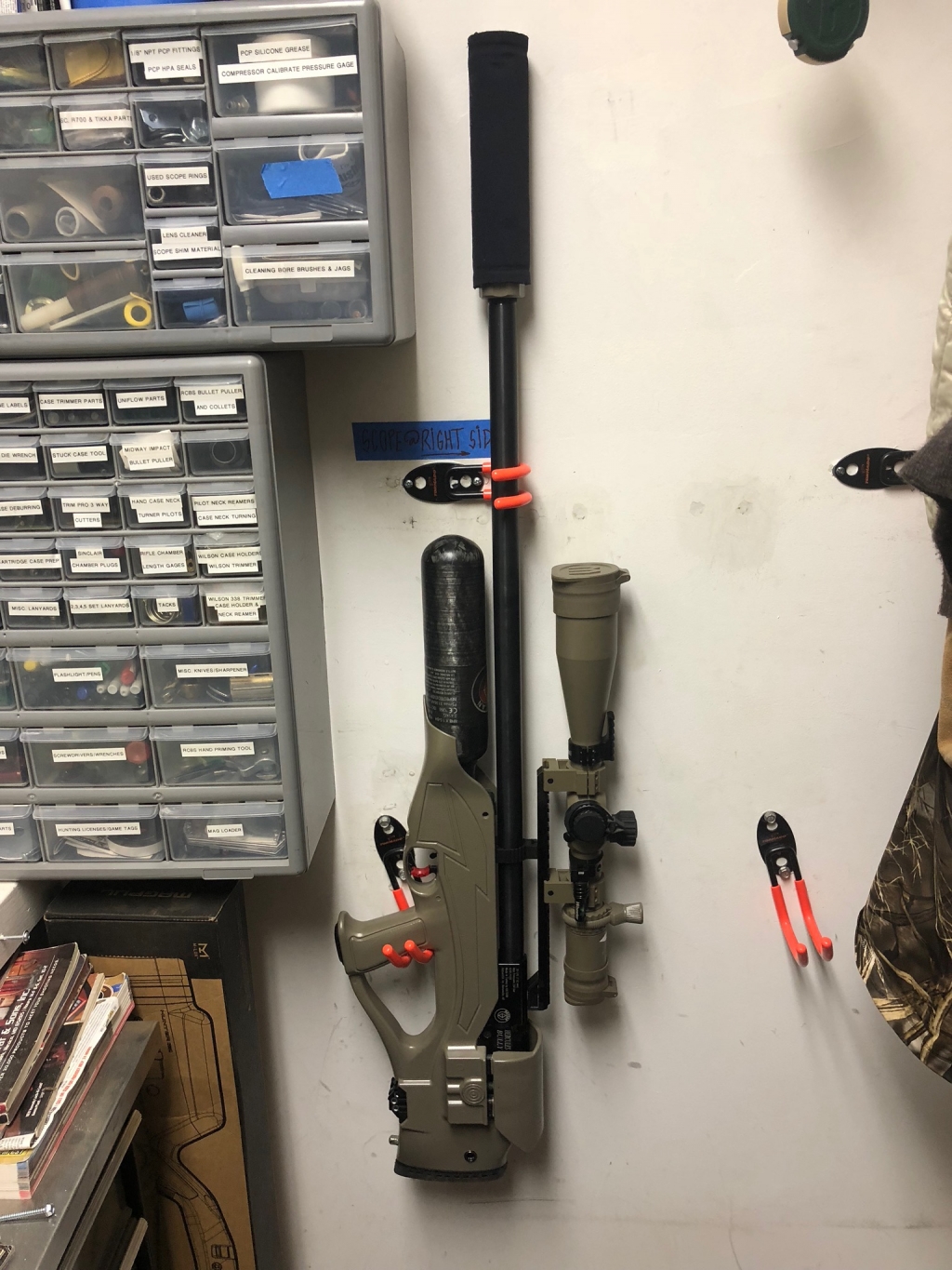

hey, all. I recently had to find a way to store my pcp’s, should the need arise that I take one off of the one on my bench mounted gun vice to work on another. I have to let you know, I don’t own a gun safe, only a gun cabinet that two springers and a couple of powder burners occupy. My “gun/reloading room is a small 5’x9’, so I had to get creative in a storage system that would allow me to just hang the gun and it had to be effective without a burden in both storing it and taking up valuable real estate. I didn’t want any head knockers with guns mounted above me, and due to worn out rotator cuffs, I didn’t want to be reaching overhead.
while cruising the aisles at Home Depot, the garage storage section, I found these Tornado hangers. Really built stout and they have a thick protective rubber coating so as not to scratch or mar up any gun I hang it on. Each hanger is rated at 40 lbs, and I use two of them per gun, the large style Tornado hook bearing the weight and attached to a stud, and the small version meant to cradle the barrel at a point that balances the offset weight due to a scope. I offset the top bracket just very slightly to just catch a balance point, as I don’t want a lot of pressure against a barrel shroud when leaning a gun.
Naturally due to the offset, the top hanger is off of the stud, so I use (2) 40 lb rated drywall anchors and throw a drop of adhesive on the back of the anchor, just for good measure.
https://www.homedepot.com/p/Tornado-40-lb-Tornado-Large-Orange-Vinyl-Coated-Steel-Wall-Mount-J-Hook-48034/202639947
The system came out sweet. So easy to get a gun on and off. It’s perfect for bullpup type guns depending on where you orient the hooks. On standard rifles I would use the Tornado hanger with the flat, non curved prongs as to catch the shoulder pad, the a hook mounted sideways just to catch the lean point like I did the bullpup guns.
Just thought I’d share to anyone dealing with like a studio apartment or if wanting to mount pcp guns inside a closet.

At the level i chose to mount the pcp’s, it allows me to also check the pressure gage at a glance without having to remove the gun from the hangers, to always make sure the gun isn’t leaking air.

Vinny, the last pic shows that I used the smaller version of the hook on top. Originally I used the large hook, but it needed more “swing out” when pulling the barrel off of the hook with the large one. Might not be a big deal, but in the pic with the gun close to those storage bins of mine, it barely made it out as the barrel would hit the bins. The smaller hooks up top are the ticket.

It’s just a shelf over the outlet for a little extra storage or place to set phone while charging.
Bullpups hang on wall and long guns are on a standing rack on other wall. I used to have all guns in locking cabinets, now the closet is locked for safety. Stack-on 14 gun cabinet would only hold 5or 6 guns comfortably and would always bang them into each other getting them in and out.
