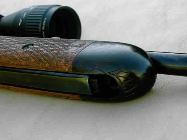

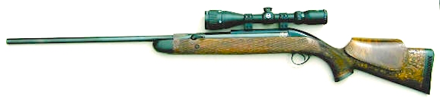

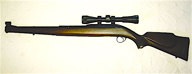

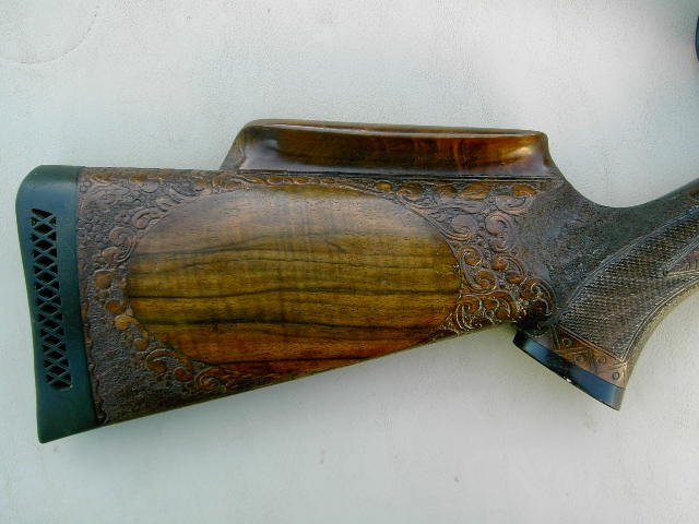

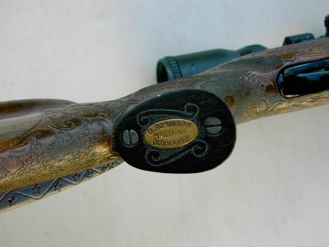

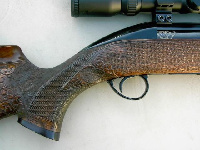

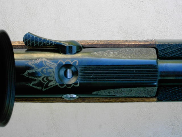

SMITTEN as I am with 1980s vintage BSA Airsporter springers, and despite he and I having almost identical names, this Don Robinson custom Airsporter S showpiece did not shoot as well as several stock Airsporters I've owned. Tom Gaylord fell for it at a Texas airgun show, and we consummated a horse-trade a couple weeks later involving a BSA Airsporter Stutzen plus cash.

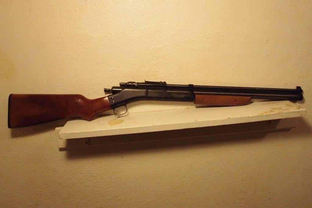

I bought my Apache, including two tubes of labelled Apache .25 caliber shot and the bb barrel insert, at a garage sale. To my amazement the gun both pumped and held air. I could chamber and fire bb's with ease and reasonable accuracy, but I could not chamber the Apache ball. These guns have a reputation for fragile bolt handles and I was afraid to use significant force.
At a sale at a local sporting goods store I found a partial bag of #4 shot, with is supposed to be proper ammo for this gun - still no luck; the balls would not enter the barrel. Examination of both groups of balls showed them to be barely spherical. Clearly, they were sold direct from the shot tower.
In a flash of insight I searched the internet for swaged #4 shot and paid as much as I had for the gun for a bag. Success. The swaged balls are round and enter the barrel with only a slight push.

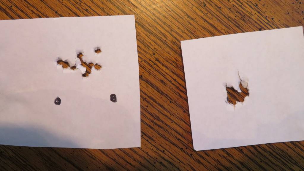

Terribly over-bored barrel! I could push just about every H&N pellet through the bore pointing it down at the floor with just the weight of a cleaning rod behind the pellet and a gentle tap to get the pellet moving. Most pellets showed no appreciable impression of rifling in the lead. Only JSB Kings engaged the rifling but wouldn't group better than 3/4 to almost 7/8 inch c.t.c. at 23 yds with scope set on 9 power.. Tried every hold imaginable.....the gun actually shot best (10 shot group on right) with a very firm hold with both hands and snug against the shoulder. A typical gentle springer hold (group on left) sprayed pellets all over at that distance.
I hated the fact that gun even existed. I did eventually sell it with full disclosure about its accuracy but I nearly cut it up and threw it away instead just to prevent someone from attempting head shots on game past 25 yds. I don't even want to imagine what someone is doing with it today.

Problem with the 80's Airsporters and Mercurys is that stupid Maxi Grip scope rail that forces you to mount your scope too high. I'm selling my Stutzens and probably my Mercury Clallenger Carbine. Supersports are the same deal. Selling mine off.(When I get around to it. Not today!) You can't mount a scope right. Shame, they're half decent guns otherwise. You can shoot them scoped but they just fit wrong
Keeping my 70's Mercury S and Airsporter S with regular 11mm dovetails. And keeping my Mk1 and Mk2 Airsporters. They all handle right.
