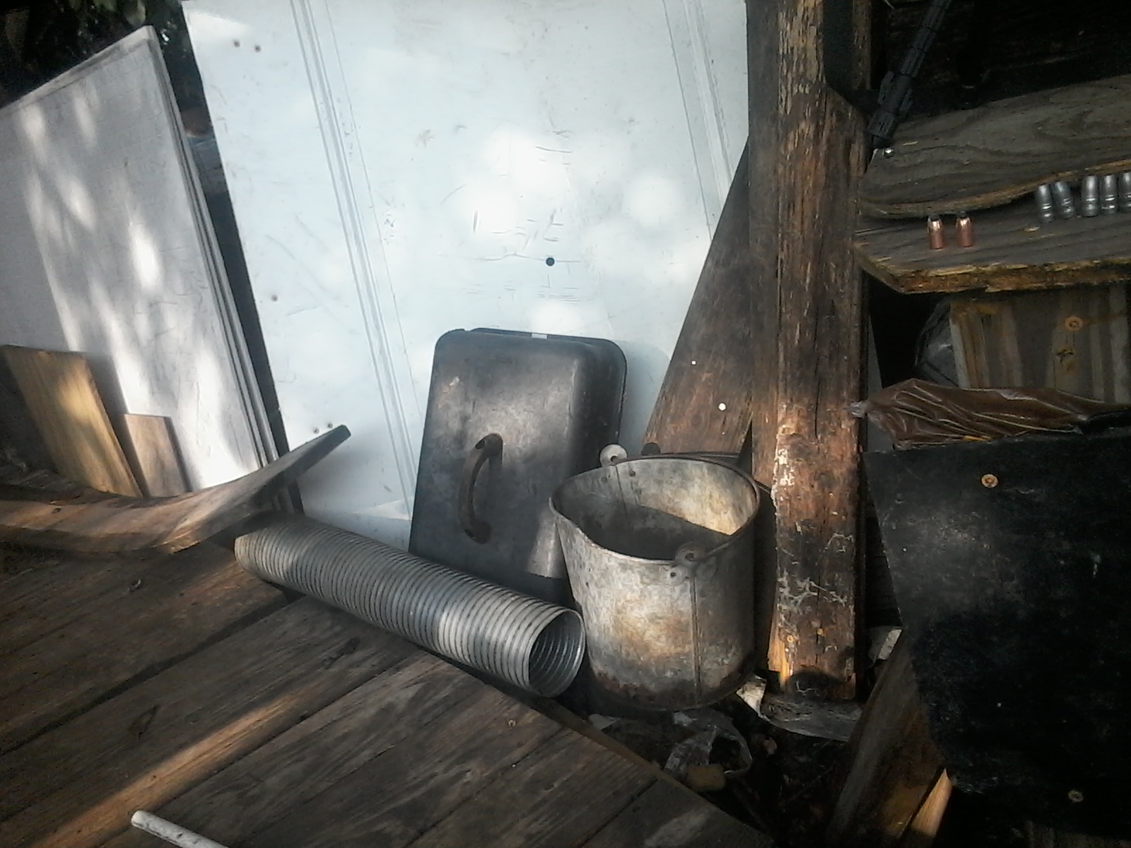

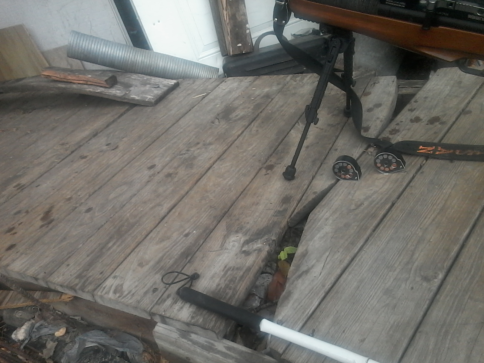

this is a late entry but my AEA challenger .357 standard big bore is great in texas the power level is over 200fpe for most of your shots and the first 5 shots (out of 10rd mag) will be over 300fpe with any weight 125gr or more. and tops out somewhere between 230grain and 245 grain at a speed above 800fps (my 200gr templars flew at 920 fps so go figure, this rifle is getting er done...
