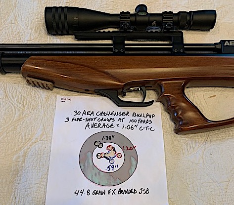

FWIW, here's some phenomenal performance I got from a .30 AEA Challenger bullpup-
