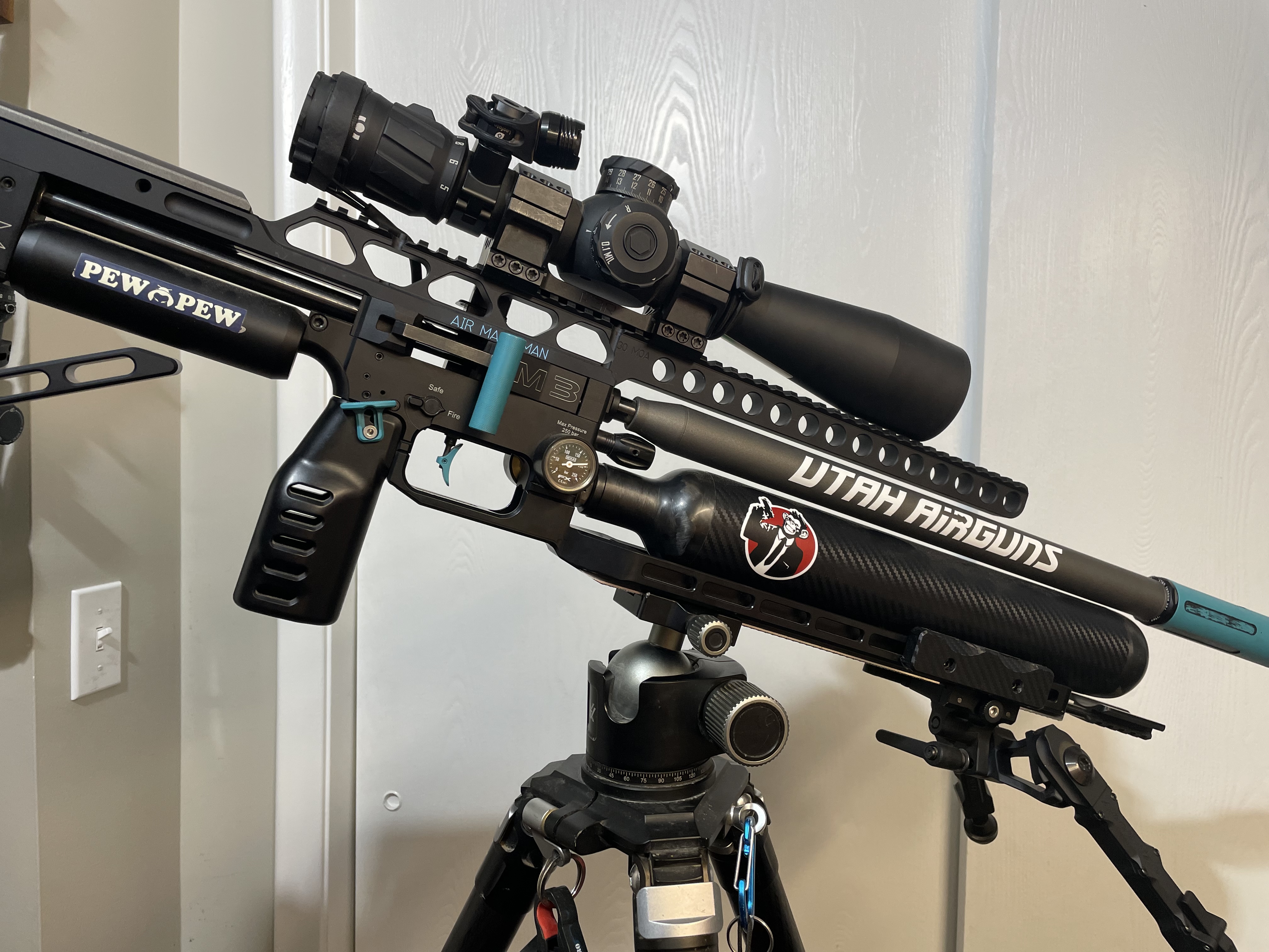

I have an impact m3 that I just recently got. I'm still working on the tune and finding what ammo is best but it already has GREAT potential at 100 yards.
I have had very good results with H&N barracuda match, I have been getting 1/2-3/4 inch groups at 100 as long as the wind is down, my M3 has a 600mm barrel and I’m shooting at 875fps,
