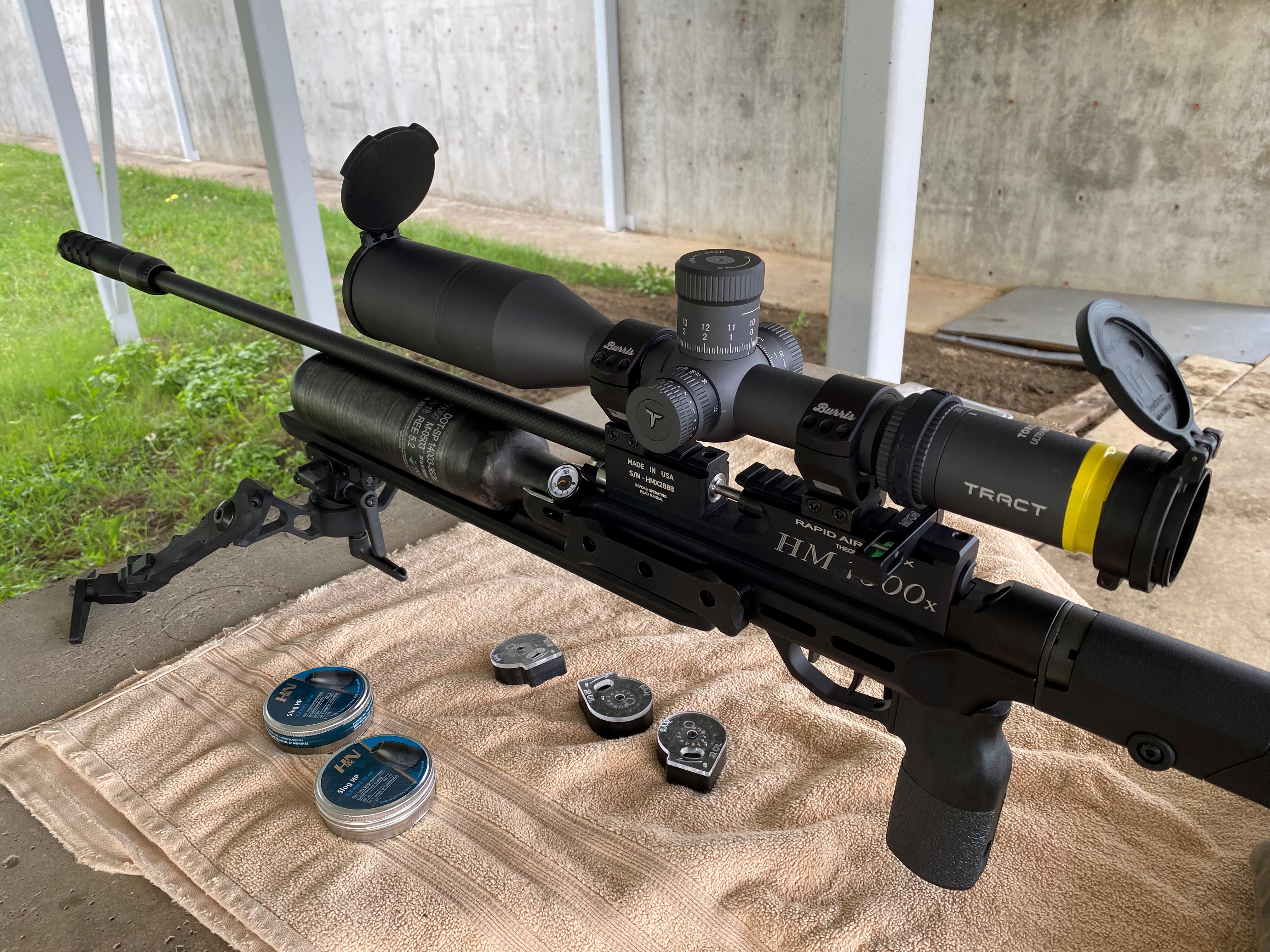

RAW HM1000X with chassis and some aftermarket goodies
.22cal H&N 27gr slugs @ 950-980fps
Tract Optics Scope
It has the double coil spring from the .357 RAW and regulator set at 180bar. That’s it.

I never shot slugs in stock configuration because we knew that wouldn't be enough velocity. I only shot it with the higher reg, stronger spring, and small plenum extension and hit 950-980fps.
What type of accuracy are you seeing with these slugs?
I was just out testing today with the 25 grain and couldn't get them to group consistently. Though hoping to grab a plenum extension to see if I can't get some more speed and consistency.
Are you shooting completely stock? If so wat fps do you have the 25 grain slugs shooting at? I have a hm1000x in .22 coming that's completely stock and I am wondering about wat slug weights to buy
