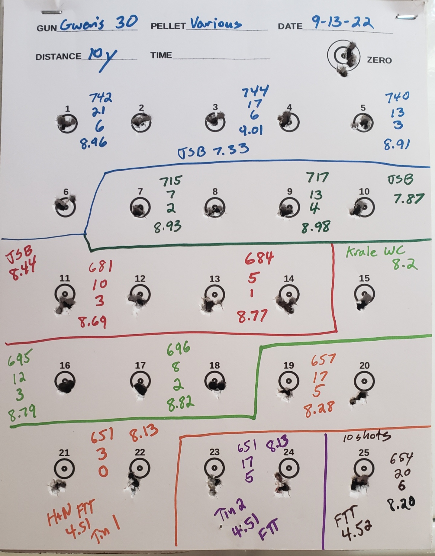

This morning I put a replacement PG4 kit in my wife Gwen's Hw30. It was shooting fine but the cocking foot was carving into steel outer guide. I had Tom replace the kit. Trying to do me a favor he sent it to me lubed with Krytox. I've ordered my kits dry in the past because I use Krytox on some guns. Somehow he thinks I use Krytox all the time.
I typically don't use Krytox on Hw30s because you give up about ten fps over a clean running petroleum based gun. Gwen doesn't care about power so I leaned into it and converted the gun to Krytox.
When I first shot it. The shot cycle was as subdued as a mouse fart. I thought "ohhh great, what did I do? ". Scared the gun went backwards too far I broke out the chronograph. Pictured are the results
All groups are 5 shots except #25 which is 10 shots.
Top number = Avg fps
Middle number = Extreme Spread
Next number = Standard Deviation
Decimaled number is energy.
Overall the extreme spread is all over the place. This might improve over time or with a new piston seal. The accuracy is ok at this short range so I'll wait and see what happens outside.
These numbers are abnormal. Her gun was running hot with the other kit in it. JSB 7.33 were running in the 720s when I broke it down. It probably had 1500 shots on it. I guess I'm posting this because I'm pleasantly surprised almost shocked how good it shoots at these power levels.
Overall the extreme spread is all over the place. This would might improve over time or with a new piston seal. The accuracy is ok at this short range so I'll wait and see what happens outside.

Thanks guys for the compliments. I was more impressed with the guns power vs shot cycle than my shooting. The gun will come down a bit after a few tins. I thought it was cool getting nine fpe out of 177 Hw30 while keeping its manners and decent accuracy. This might add 5 yards to my Hw30 squirrel game. Lol
