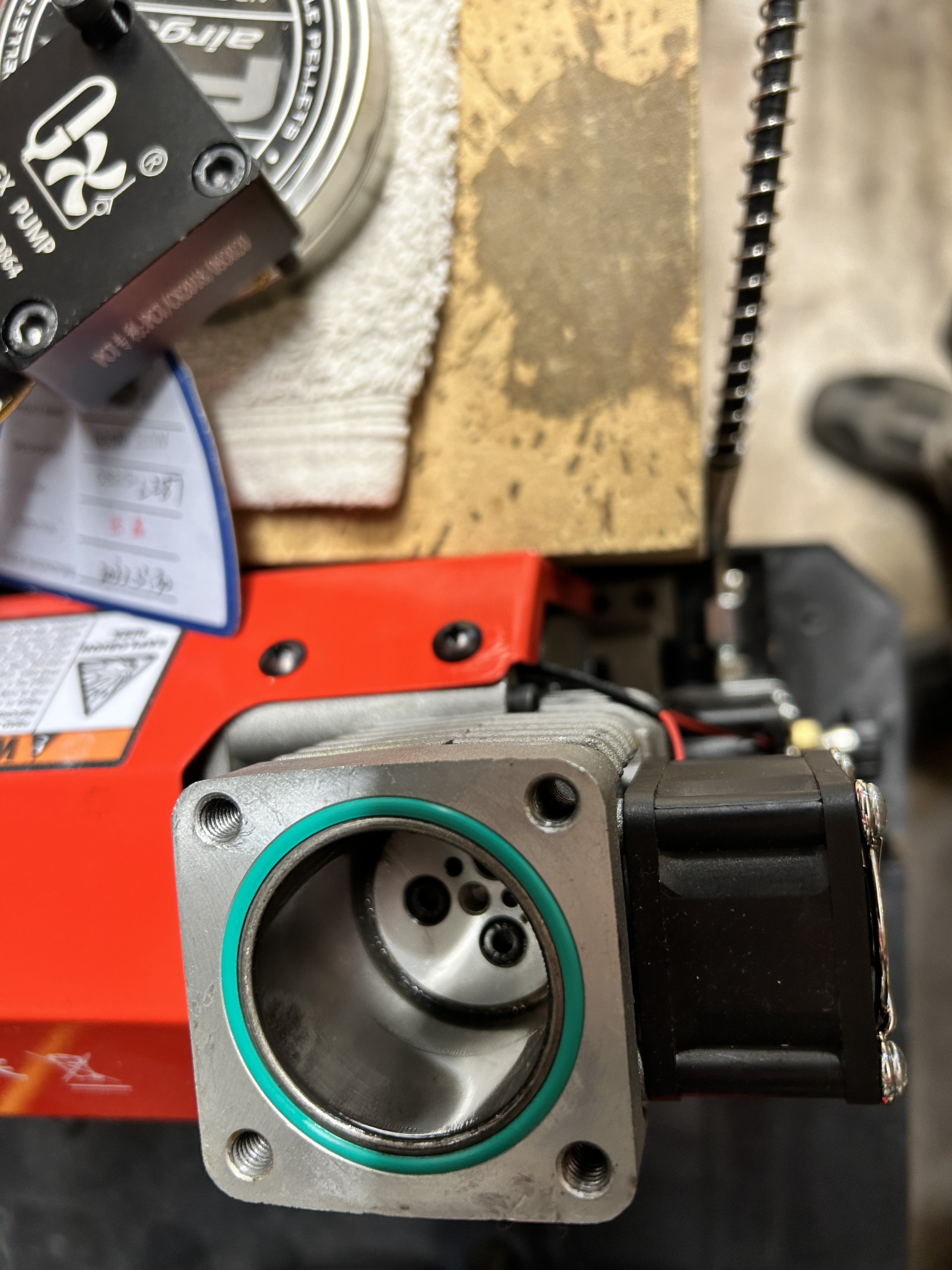

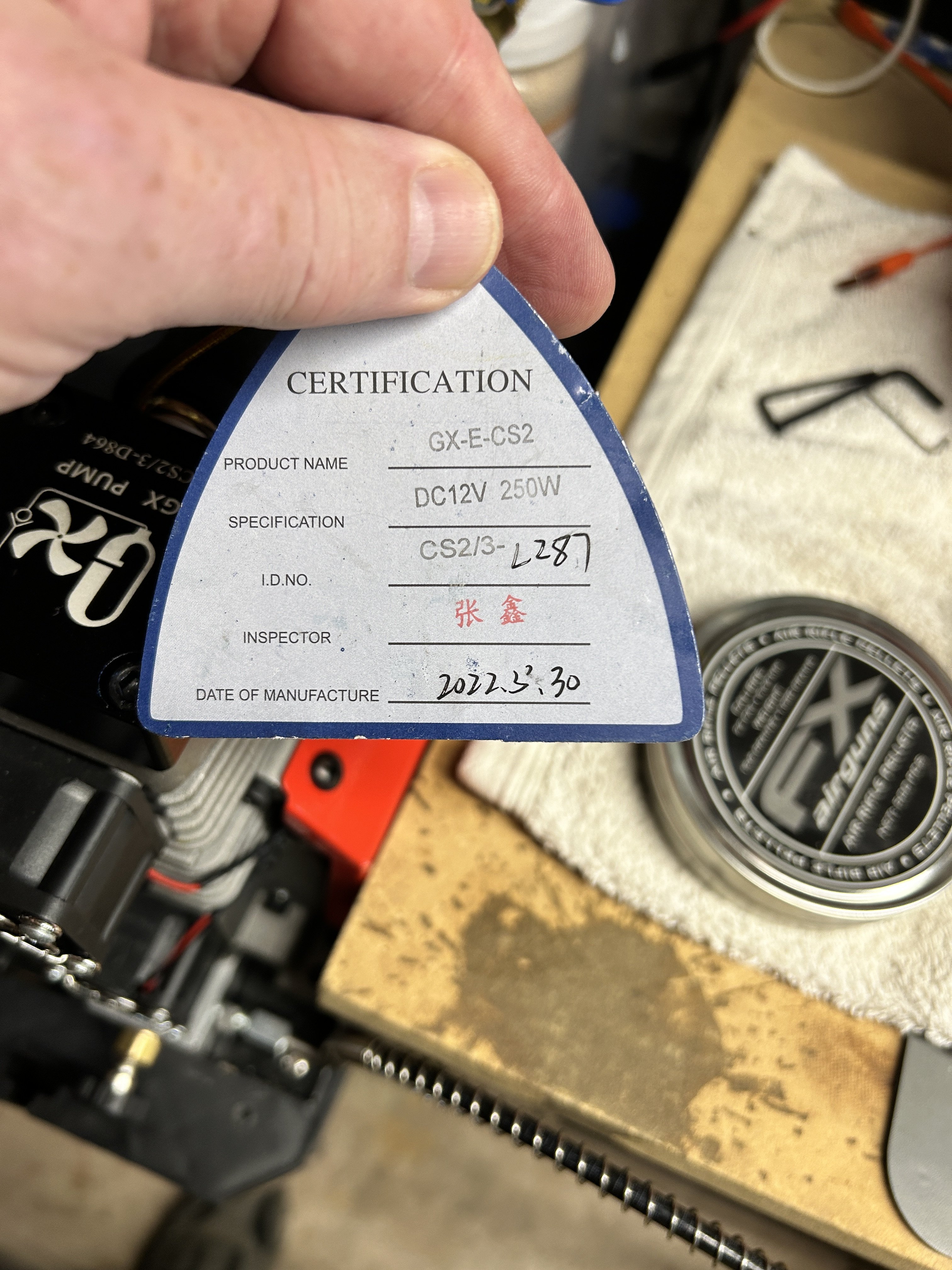

I had some time at lunch today and it was time for the CS2 to get it's visual inspection. I usually pull the piston out, but I am pretty familiar with this compressor, so I just pulled the head to look things over and see how it's doing. As you can see from the pics it's nice and clean, with a very thin film of grease on the cylinder walls and the underside of the head, so all is well. In another 3-6 months I'll pull everything out, clean it up and relube and reassemble, but for now it's going strong. As you can see this one is from May 2022, and that's just about when I bought it, so just over two years of almost daily use, and it looks perfect.
I have three CS2 compressors and my neighbor has a CS3 that I sold him, and all look the same way. I've run the above compressor almost every day, and the two others get about half that use, as they are at other shooting locations. I only pump up rifles with tanks ranging from a FX Dream Tac tiny tank, all the way up to my Brocock Bantam 580cc, and they fill quick and that's why I don't fool with auto stop of the CS3, and sold it.
I really recommend these compressors, they work well, parts are readily available and a complete rebuild is less than an hours work if you work slow. I can tear one down to nuts and bolts, without taking the drive gear out, in less than 20 minutes. I thought about buying an extra cylinder, and then I thought why not just buy another entire unit and have all the parts. Well, I did buy some parts from Target Forge and GX USA and I have an extra compressor for parts, and in over two years haven't used a single part.

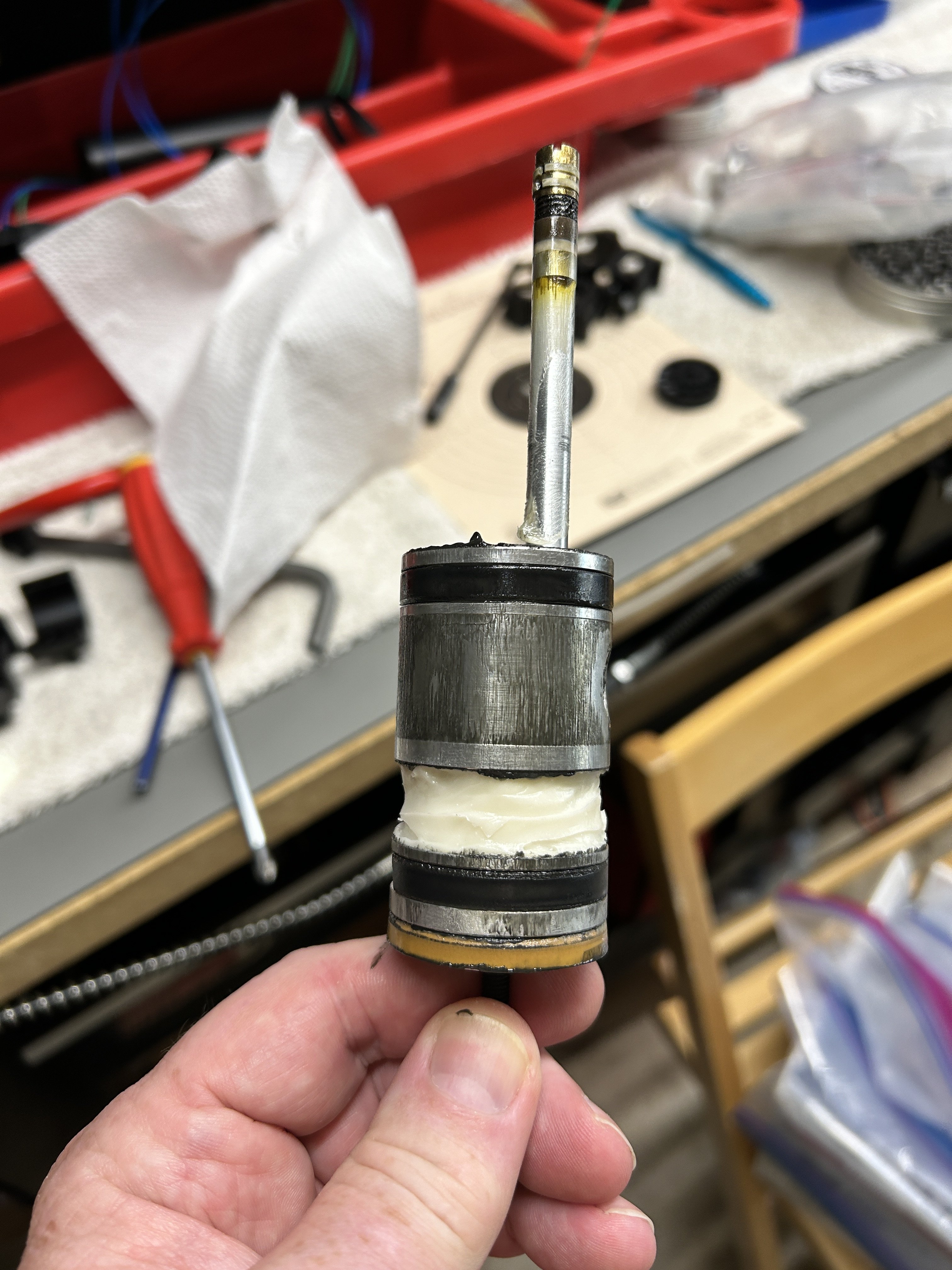

I had extra time and went ahead and pulled the piston, and it looks great. You can see how I pack the lube band on the piston with grease. That grease was put in there about 3-4 months ago, and it looks great. Also, you can see the high pressure piston looks fine too.

They really are great. I have had mine for a year and a half. I have taken it down and re greased it one time. I don’t use it nearly as much as the op but it’s been solid. 90 percent of any issues you have are most likely going to be in that piston assembly. You don’t even have to mess with it as the whole assembly can be bought for 60 -70 bucks with orings already installed from target forge. Pop the old one out and stuff the new one in. There really isn’t even much disassembly involved in taking the whole piston out.
You are so right, but the cost of the low pressure piston seal and the high pressure polymer rings is so cheap, that the 1/2 hour it takes to disassemble and replace is trivial. I've got two years on mine, and it's never had a seal replaced and I've got extra seals laying right here new in the bag, but haven't saw the need.
