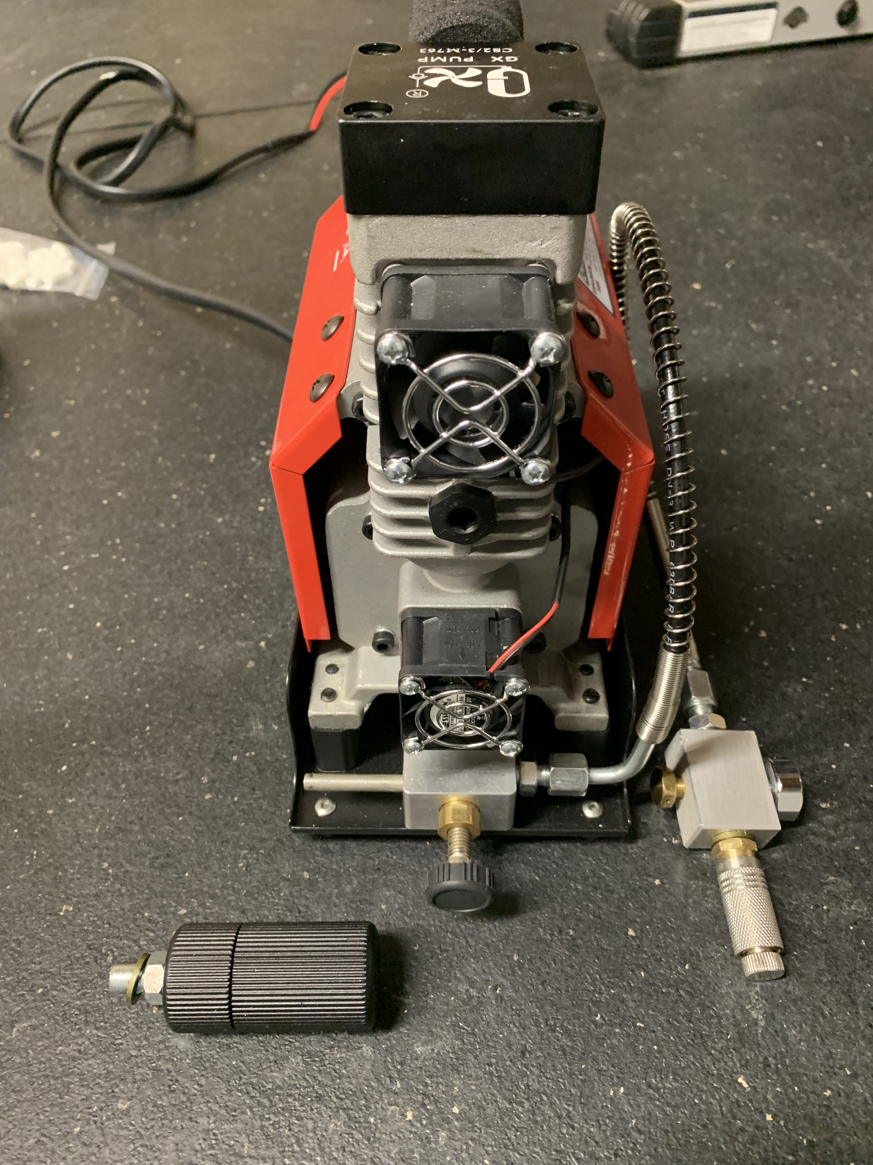

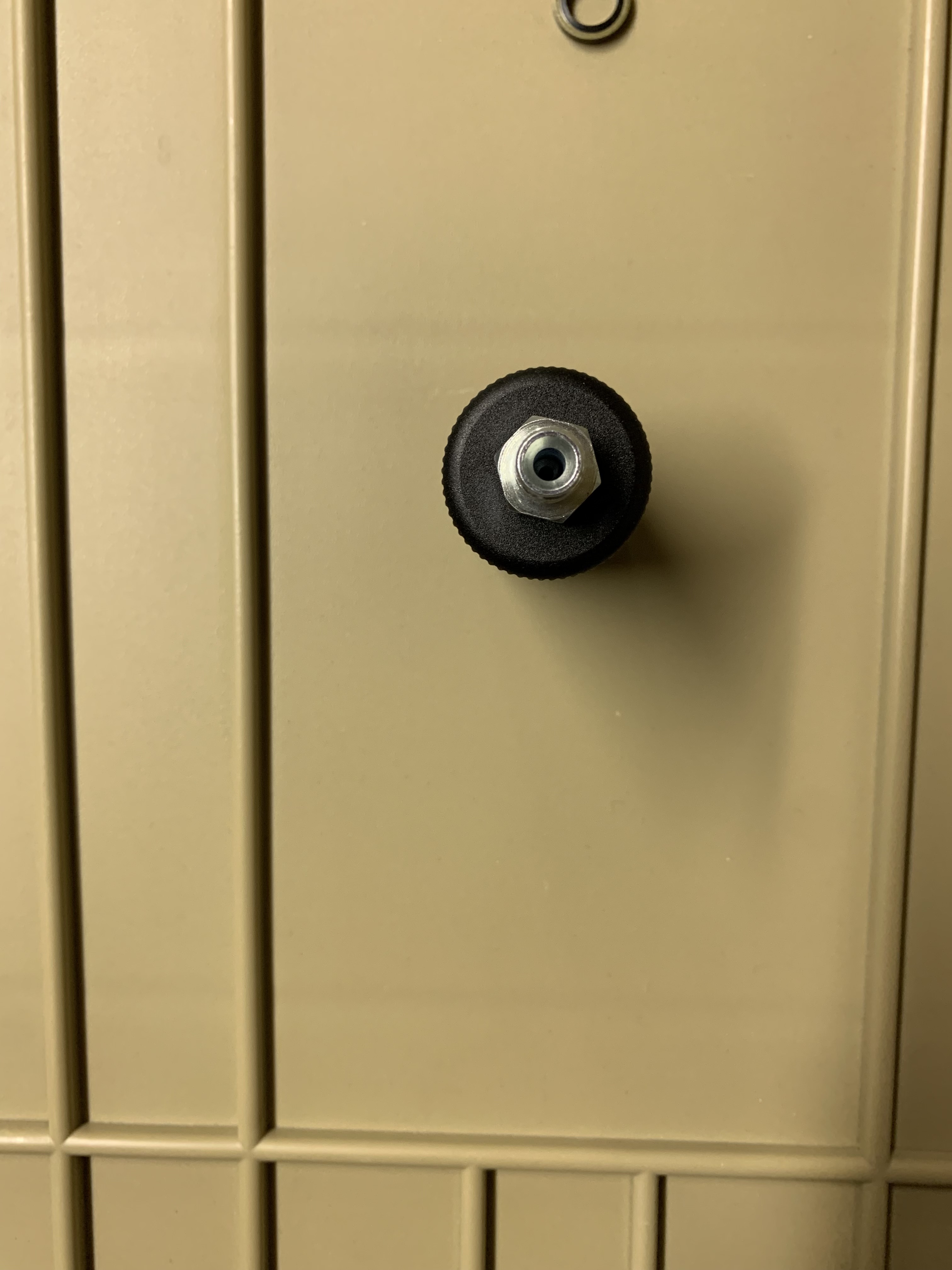

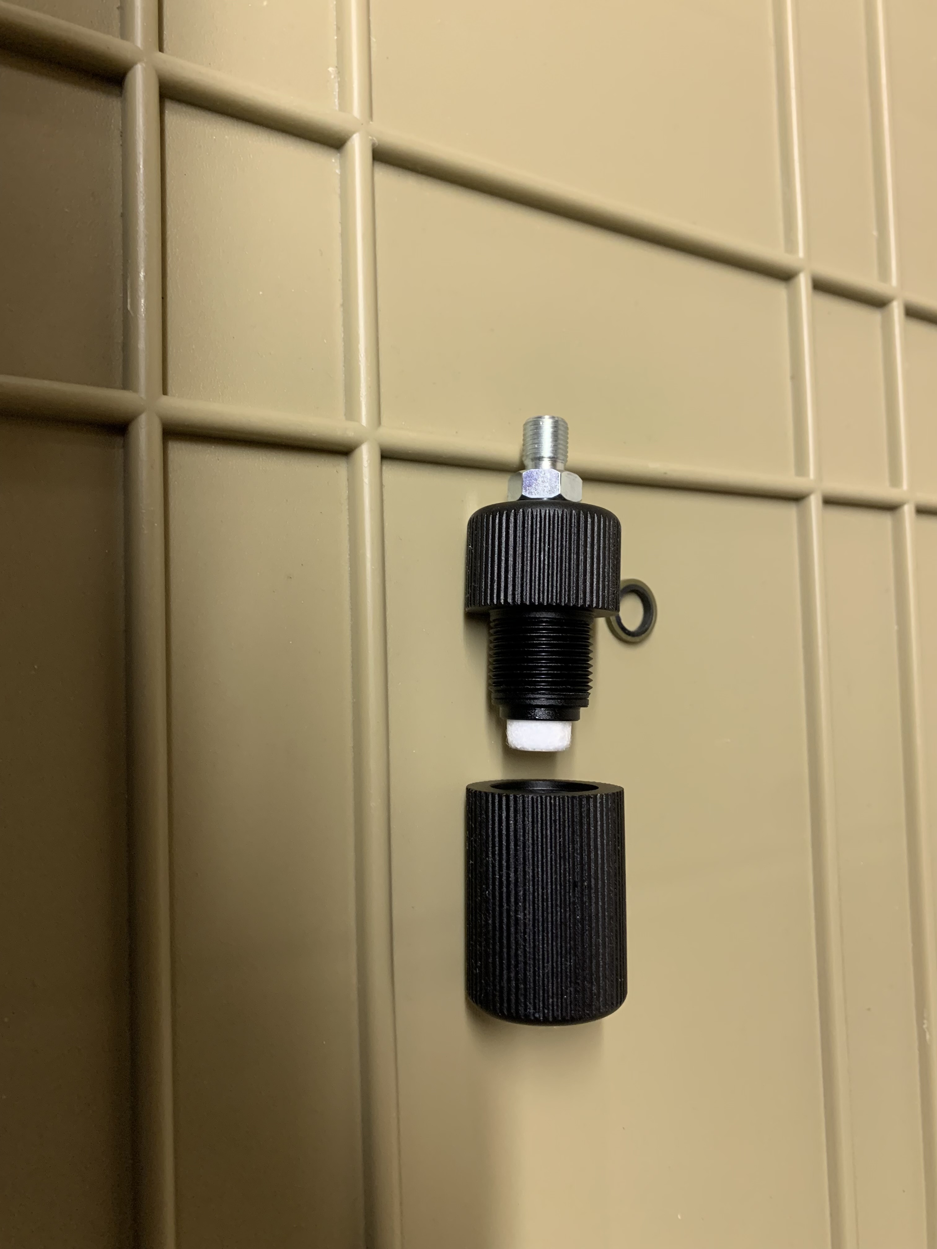

There is also a filter in a two-piece black cylindrical something or other, but I never attached it to the unit and do not presently know how.
I am attaching three pictures of the black two-piece screw-in cylinder and one of my attachment. Mind you, I had to screw in a non-factory adapter to fit my crown’s nipple, hence the extra length.

Yeah, that's the filter. You install that on the end of your hose.
So if I understand your GX pump correctly, you have no moisture filter at all, presently-installed.
IMO it would probably make sense for you to get one. That little unit you have (uninstalled) will only help a little bit.

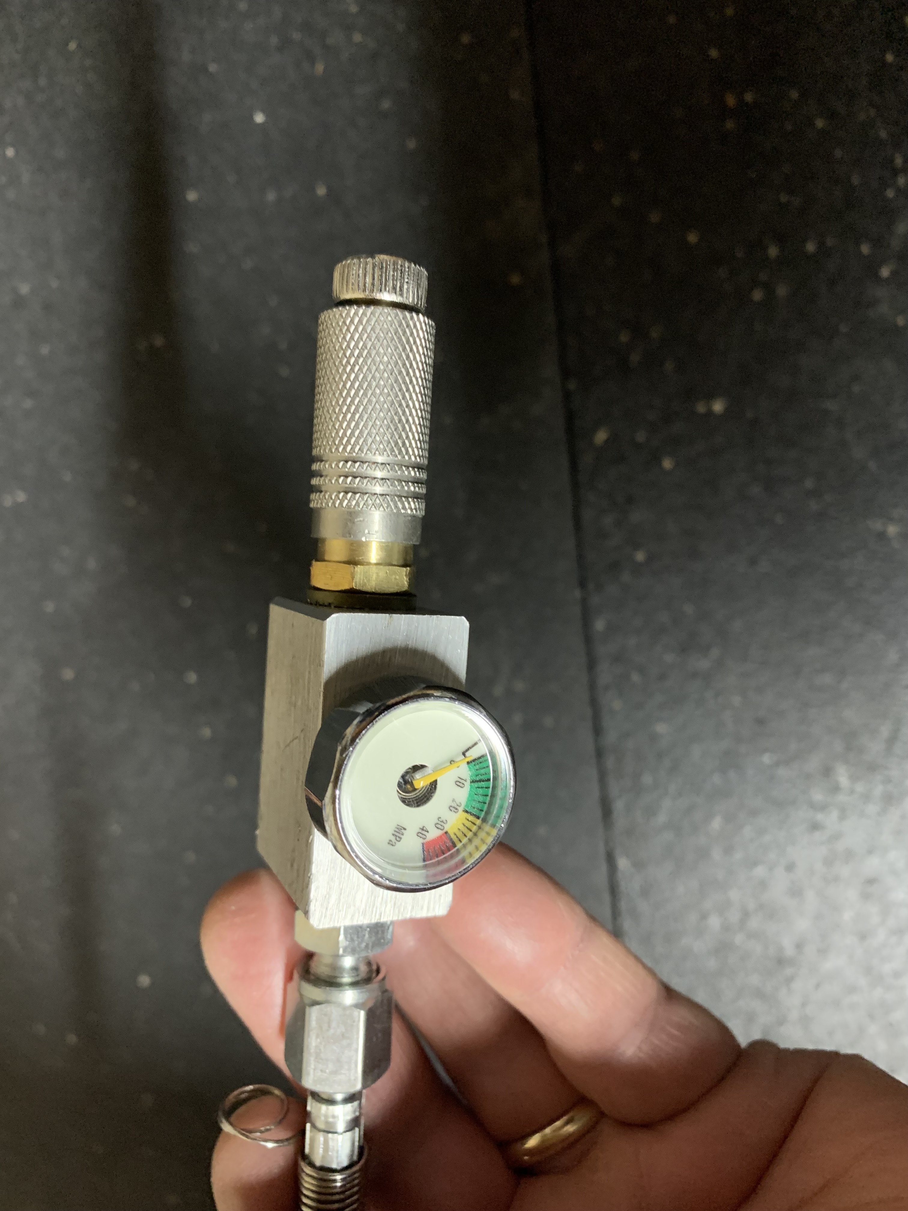

There is a small one in the block where your gauge is.
Remove it if you're adding or using the black filter. It will cause problems as many forget about it and it gets plugged up.
Thank you. I will see what is what as I proceed. One more thing: Is taking the gauge off a straightforward procedure? Just take it off and put it back on? While here, I will likely purchase the PSI gauge that Target Forge offers for $10.00.
S7

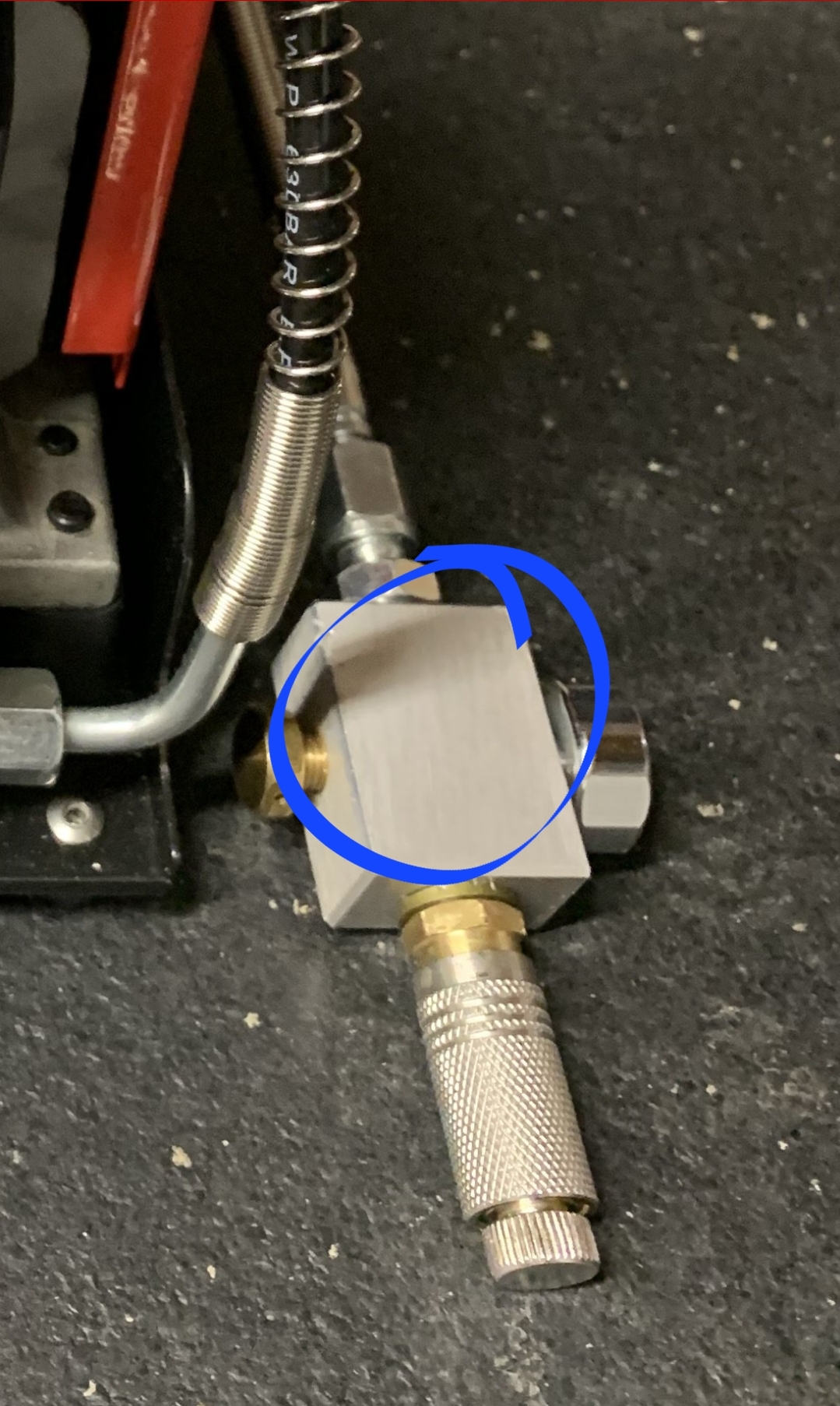

Edit: I now realize I made an assumption. What needs to be removed from the block to address the filter?
I don’t have a GX but everything I’ve read or seen on that style compressor there’s an intake filter and then on the output side there’s a condensate drain, which is the black knob that you open briefly every 5-10 minutes to drain the liquid water that has accumulated.
From your photo that shows that black cylindrical piece, it’s my guess that the intention is to unscrew the line that connects to the aluminum block that has the gauge and extended female Foster and then the black filter screws into the aluminum block and then the hose screws into the other end of the filter.
That black filter, I’m fairly certain just has what’s often called a cigarette filter in it. It will absorb water rather quickly and perhaps be changed or dried after each pumping session.

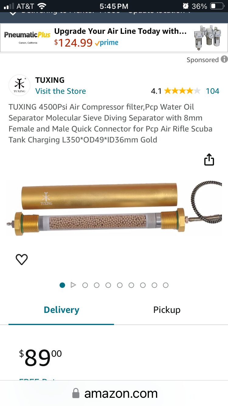

A lot of airgunners upgrade to a better filter drier that uses silica beads that absorb moisture or a media called a molecular sieve, which is superior to the silica beads. It’s your choice as to the method you use.
The attached photo and link is a popular molecular sieve amongst airgunners (there are others too).

Good deal. Be dilligent about opening up the black filter to dry out the cylindrical white filter as it will retain water and then pass it through to your gun if you don’t let it dry, or maybe better, replace it. Order a bunch of them to have on hand. It’s cheap insurance.
I have now removed the three connections to the aluminum block. There was no small cigarette filter visible. Two connections have been put back, the gauge and the hose. The third one, which is the brass screw with the two small holes in the head on opposite sides, must be the pressure safety release, or whatever it is called. Now no less than three very thin metallic discs were inside this connection. Going back to that scanty manual, I confirmed that they are burst discs, as I figured. I assume they lay flat in the space, and then the piece gets refitted, correct? I am not putting the nut back on until I am sure of their proper placement.
Update: Before I let this post stand, I watched a quick and helpful YouTube video on replacing discs. It is simple. The lingering question I have is the guy in the video says to place one disc back (yes, flat, as seemed logical). Why did three of them come out of my fitting?
